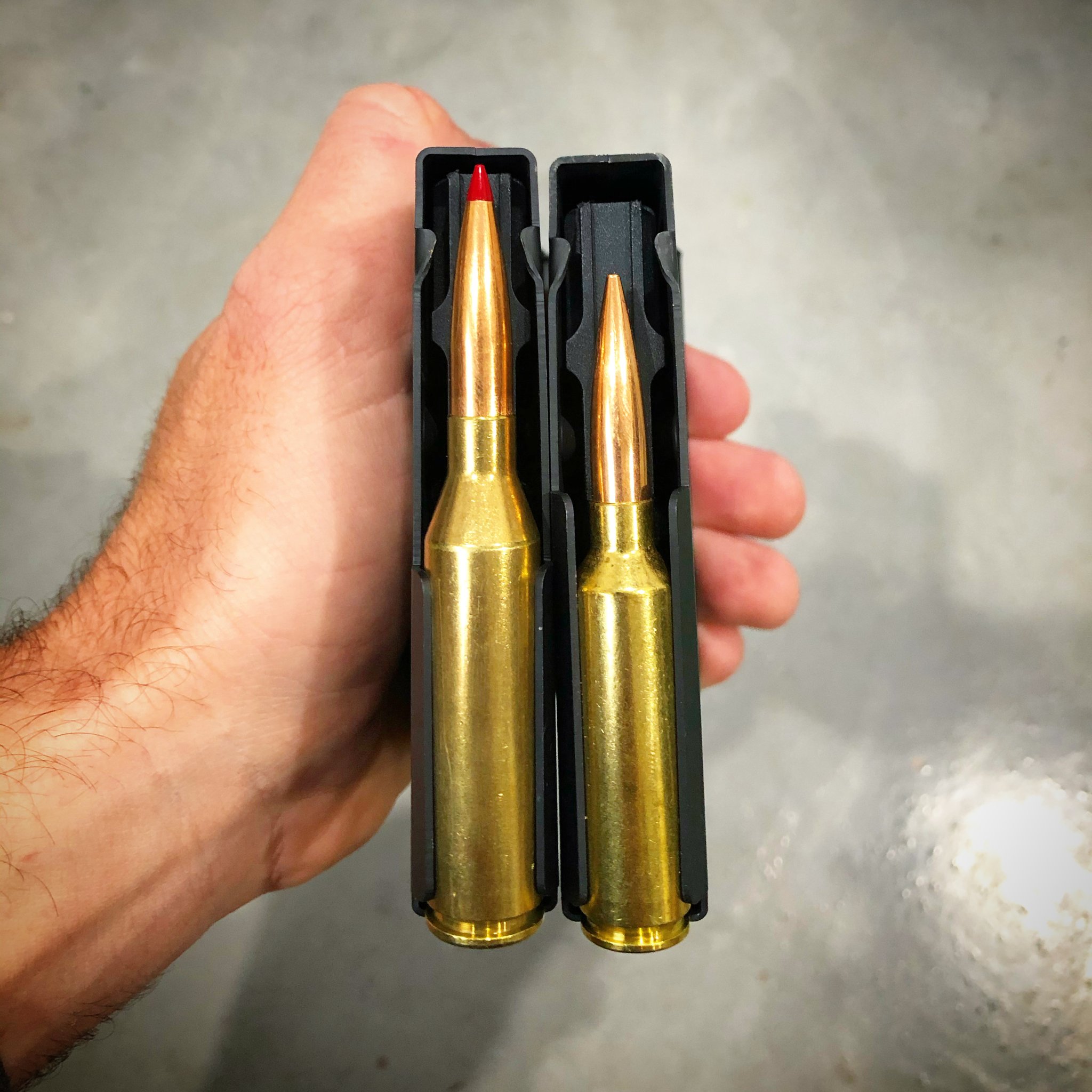

Are there any major downsides to running things like 7SAUM/280AI/284 Winchester/6.5PRC/etc on a long action, aside from the ounce or two of additional weight and slightly longer bolt stroke? I'm concerned about magazine feeding with the cartridges being in the 3.1-3.3" COAL range.
280AI would be my pic for a long action
It would fill the mag well and you basically get 7 saum performance.
At 3.3 7 saum with the longest of bullets is going to be running out of neck I’d imagine and that’s still a lot wiggle room in a 3.65 magazine.

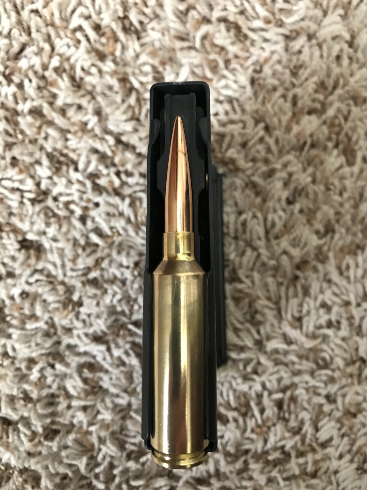

I have a 284 on a LA. Not as much room left in the mag as I was expecting- (that was with a 185 nosler) and it feeds very smooth from AICS mags.
I don't have my notes on it right now but I was getting a little better velocity than what was published in my manuals and wasn't pushing anything hard. It got moved to the back burner- because the only bullet available at the time was the 185 and I had some weird fliers and issues at distance that seemed like bullet issues. At first I had half a box of 168 bergers and it was incredibly accurate with those and easy to load for.

With the common f class throats it would fit a LA magazine well.

7 wsm brass source is Norma in the form of 300 wsm. For simplicity, the 7/300 wsm saves a step as the shoulder on the 7 wsm is 0.050" longer than the 270 or 300 wsm. You can fire form it, but not much difference really either way. Norma makes good brass, so no accuracy loss there. Just make sure you can get your brass for whatever before you go that route. Right now the more mainstream cartridges are getting more support, so while they might make brass, you might not get your hands on it. None of the cartridges in contention are in any way bad and should fit the bill, just a matter of how fast you want to go.
I am putting mine in a long action with a DBM so I can mag feed it.
