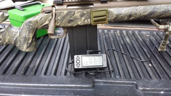

I love my .284Win! Huge nodes, so easy to load for. Right now I'm at 54.5gr H4831SC with a 180 Berger Hybrid loaded 3.250" OAL. 2780fps from a 26" barrel with SDs of 5 or better.. not super hot, but doesn't have to be. 20170415_103141.jpg
