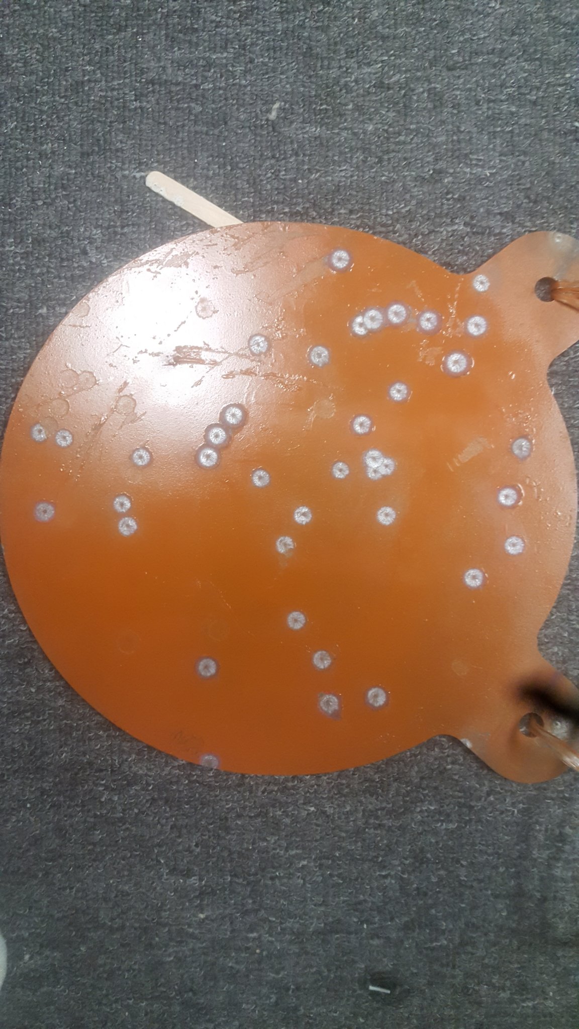

After reading claims of sub moa and moa all day long with the 22wmr, I asked for proof.
Even made it easy, 50 shots at 100 yards on one target.
I was the only one willing to post results, and mine sucked.
I think I might have irritated a few fanboyz.

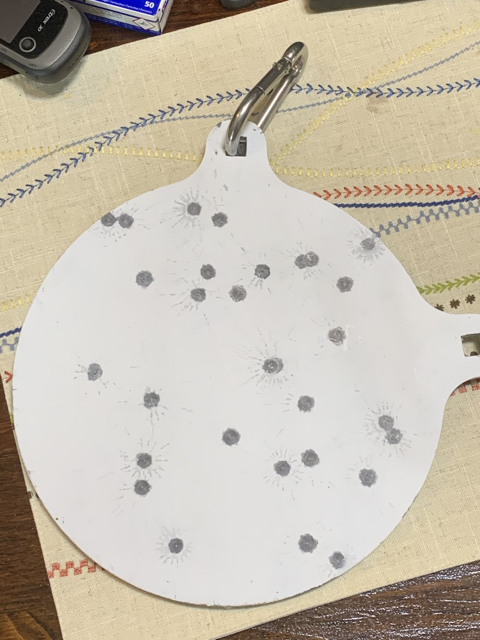

My 22 mag sucks at 300Y but at 200M it doesn't do too bad on a chicken silhouette, though I haven't tried but a few ammo offerings.
Man I'd love to try my 20-221AI reduced load in a match like that with 32vmax at 2330 fps!! Just for fun, not competing of course.
Hey Steve...showing my ignorance here.
You've seen the 50 shot patterns I've produced with 22wmr.
How many of those patterns would stay on a steel silhouette at 200 yards?
I hate being ignorant, figured this would be a chance to lessen it. ;)

Last summer took my buddies dad to the range with us to shoot 22lr. He was very optimistic when I hung a 3" target ( I believe )at 200 yards, then a 10" gong at 300 yards. He didnt think the accuracy at 200 yards would be as good, then came the 300 yard. He had more fun trying to ping that far target with his basic set up...that once he got home he bought a new scope and a ton of ammo.
Through scope is target at 200 and the orange is the results at 300. Three of us shooting at it
