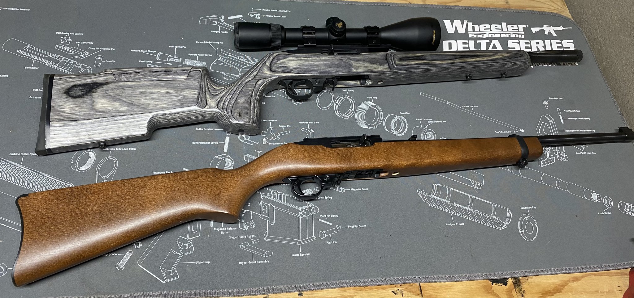

Long range 10/22 24”-28” barrels
806guns
Nov 17, 2020
735
283
Texas
I currently have a few 10/22’s but looking for a long range bench rest 10/22. I have seen Green Mountain makes a 28” barrel but not currently in stock. Anyone have any leads on 24”-28” barrels. I will be using match ammo. I don’t want to hear I don’t need a 24”-28” barrel. I’m hard headed and staying this route. My current setup. Waiting on my Arken SH4 6-24x50.

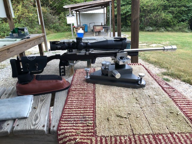

I love my 24" Douglas with 3" tuner; it looks great to me. :cool:
