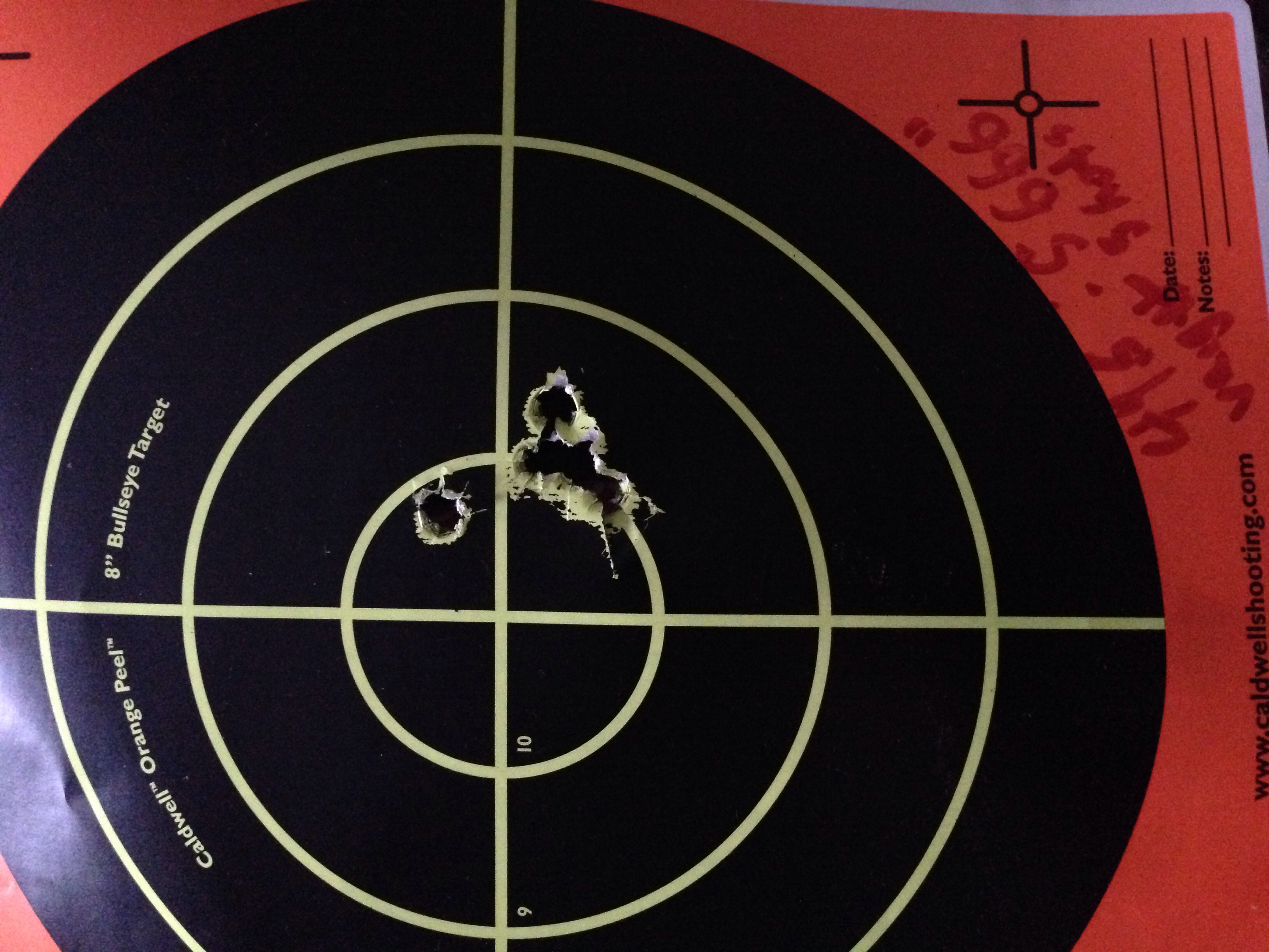

I am currently shooting a Remington 700 ADL Varmint Special in .308 with a 1 in 12" twist 26" barrel. I shot the group shown below with a handload that is a 178 gr. Hornady AMAX over 43.2 gr.s of Varget. This group is a near duplicate of the same performance with FGMM 175's. I have chronographed the FGMM's and loaded the data in G7 and verified the drops at 200 and 300 yds. and repeated the exact same performance with the Hornady's. Supposedly the 175 and 178's will not stabilize in a 1:12 barrel. If I get this performance at 100(zero), 200 and 300 yards doesn't it stand to reason that the accuracy will be maintained to much greater distances?

Seriously though, a 1:12 twist will stabilize 175’s, 178’s, 180’s both BTHP’s and VLD’s, 185 Berger hybrids and 190 berger VLD’s in my experience. This in barrels as long as 26” and as short as 20”... If you plan to go heavier some have even had luck with 208’s but I have not personally tried those yet...
I'm certainly a long ways away from being an expert and I'm not sure I really understand the answer you're looking for but here's my 2 cents.
Free reference tool http://www.bergerbullets.com/litz/TwistRuleAltWP.php
...and yes, the accuracy of the rifle should remain similar from 100 to 200 and 300 considering the angle/MOA. Then once the velocity gets to the area of being transonic you may lose some due to stability of the bullet/bullet design as it transitions to sub sonic.

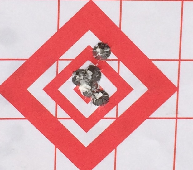

Here is a .566" group from 155gr lapua senars(which are nearly as long as the 178 amaxes). The shot not touching was a cold clean bore shot and there are 5 rounds in the lower group!
So keep on shooting bud! The 12" twist gets a lot of flak but in my opinion it's unjustified
Thanks for the input. I did suspect that all of the BS about the 1:12 might not be 100% true. I am in the process of developing loads for the 700 -26" and my new 20" sps. I did notice on the Hornady b ox for the 178 AMAXs that it specificaly states that they are for a 1:10 twist. I put together a load out of the Hornady manual (43.2 gr.s of Varget) and took them out to test the theory and you see the result at 100. The drops came in line with the same data G7 provided for the FGMM 175's. I think this issue is settled for me. Next, I will try it with shorty - the sps.
