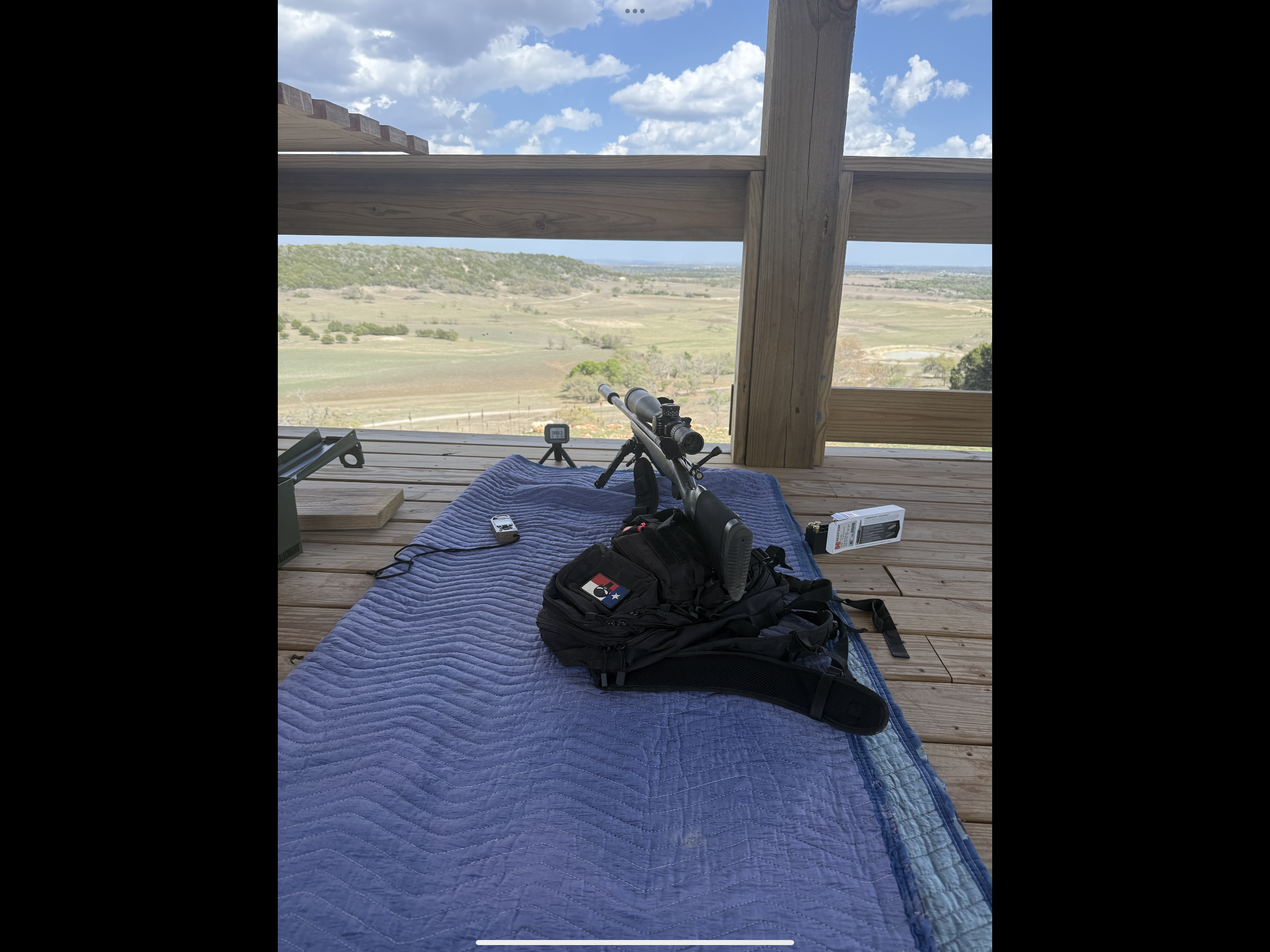

Hey all. I want to ask for some advice here. Let me give some background:
I own a few thousand acre ranch here in central TX. Have targets out to 1.5mile. I’m an FFL/SOT licensee. Avid shooter as a hobby. I have a ton of builds but usually find myself shooting a stock bergara 6.5CM or Christensen arms 6.5PRC. I consider myself a decent shooter. I put in the time to learn. Both guns shoot sub moa. Inside 1000k yards, either weapon is no problem to land shots on a 12x18 steal target. However, once I reach out to 1250 and beyond, it is much tougher to hit. Mile is almost impossible. I attribute that to my skill first, also my range sits W to E and ALWAYS get a good crosswind of 5-20mph. I don’t reload (yet) but the ammo I shoot usually prints single digit variance in FPS, plus I buy at wholesale so im good with it. I LIKE the recoil of the 6.5. Just makes it fun to shoot. I shoot daily.

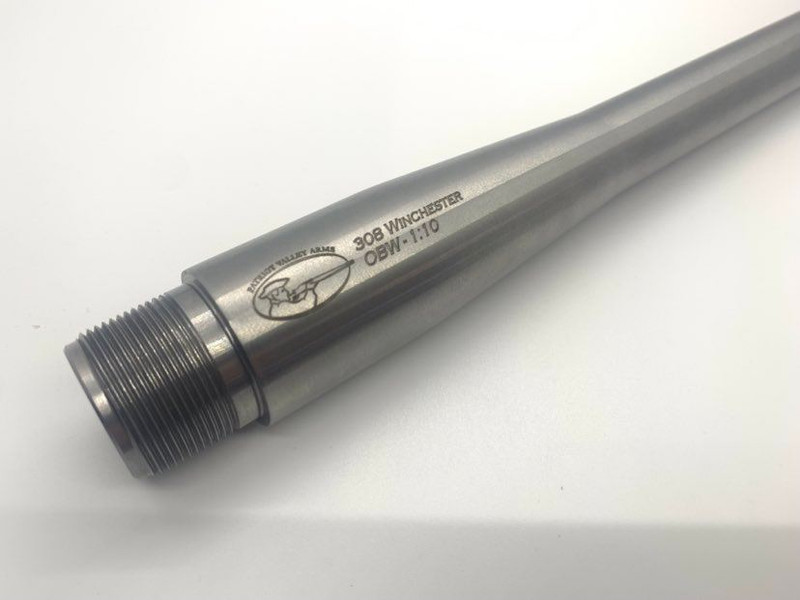

Also don’t go short on the barrel. I would be looking at a minimum of 28” for a big magnum and wanting to do what you want.

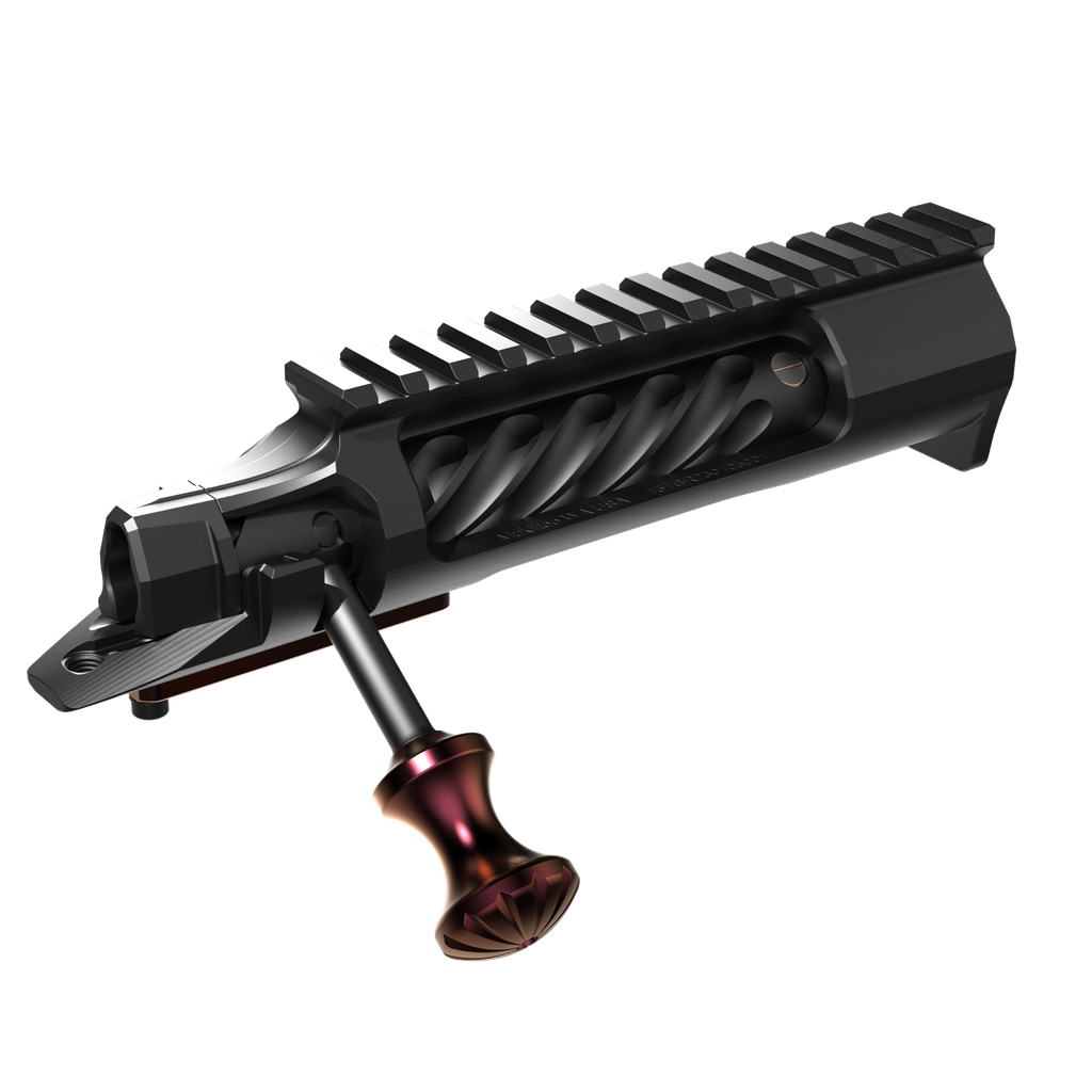

Would you go and build one on an MDT chassis with say a Detroit barreled action etc? Never shot one and want to build one. Is there a huge difference between something like that and a good off the shelf rifle? Not to say $ isn’t an object, but would spend it you said it was that much difference. Thank you sir!

I wouldn’t build on any action that you can not buy a shouldered prefit barrel for. I wouldn’t buy a factory rifle if you are serious about accuracy. You can get a long action Zermatt Origin for $1000, a 28” PVA Osprey 9 twist shouldered prefit barrel in a nice heavy contour, trigger and stock of choice and be on the way.

Defiance makes good actions too. I just mentioned the Origin as it’s less expensive and still quality. Also you can change the bolt face easily as well but that’s not something that will probably happen with the long action and your needs.

Excellent. I have a good set up to see splash. Did you build your 300?
And I’m assuming go a steal barrel and not Carbon for the extra weight on the 300PRC?
Of course. No reason to spend more for a carbon fiber wrapped barrel in your use. I’d get something heavy like a Comp Contour or even a straight 1.25” barrel. The weight will do nothing more than help deaden the recoil.

Wrt to the Origin action: My son has just started shooting his Origin-based 6.5CM with a Trigger Tech Special trigger and Bartlein 5R barrel chambered by a buddy of mine. It's temporarily in one of my MDT ACC chassis, but as soon as son saw one of Rob's rifles in a Manners TCS stock, he ordered one of those. The thing is a HAMMER. Hint: call Southern Precision Rifles and other vendors who carry Zermatt actions and ask them when they expect to receive long-action magnum-bolt-face Origins. You may be able to get on a wait list, or learn when the next shipment is expected.
Wrt Defiance actions: I have a Deviant and like it fine... but it's a different action than the Ruckus. My point in bringing it up is to compare to the Zermatt Origin wrt accuracy. The Defiance Deviant is a much more expensive action, but the rifle built on it provides no better accuracy than my son's Zermatt build - both in identical chassis, identical barrels, identical Vortex gen-3 Razor scopes, and near-identical triggers. Similar results comparing my .223s - one in a Defiance Deviant, one in a Terminus Apollo, otherwise same builds. Same accuracy.

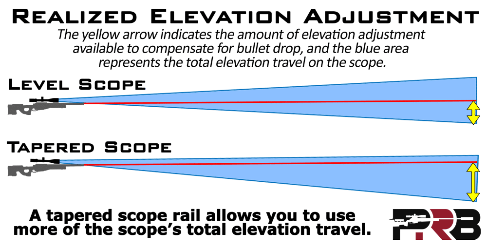

It looks like they only have 20MOA bases. Id like 0
If you're shooting longer ranges, you want 20 minimum. This will do a couple things for you:
- You pick up additional elevation you can dial in, meaning your scope is useful out to longer range.
- You're looking through an area that's closer to the center of the glass for more of the elevation settings you'll be shooting at - which means a clearer view at the ranges that you need it.
On my 300, I have a 20 MOA base and a 20 MOA mount. On my 375, I have a 40 MOA base.
How do you shoot it at 100 yards or closer distance?
You use a scope with enough elevation. I have 40 moa bases on my 22s and I have 20 moa mount and 20 moa bases on some rifles. There is no issue as long as your scope has at least 80-100 moa but you will want more with where you are going. I’d be looking for at least 100moa or more.
Your scope generally has half the elevation travel up and half down with a 0 cant base. It may not be exact but for broad strokes.
A canted based tilts that so that where the rifles relative 0 point is at in your scope is lower, thereby making more elevation travel available at the cost of down travel.
You dont utilize down travel once youve established your zero for long range shooting.
So for something thats intended to shoot long range, 20 moa should be the minimum I would want.
Thank you sir! Very helpful.
And look at the bottom image in the one that @spife7980 posted. At 100 yards, you're looking through the top of the glass. Image quality degrades as you move away from the center, but you really don't care a whole lot about that at 100 yards - if you can't see well at 100, even through the edge of the glass, you got other problems.
As you dial for elevation, you get closer to looking through the middle of the glass until you hit center. With 40 MOA of cant, that would be somewhere in the neighborhood of 1300-1400 yards with my 300 PRC. At that point it starts travel away from center again, and the optical quality starts to degrade.
Then, as I mentioned above, you have your max range. Again, using my 300 PRC as an example, I have 35 mil of vertical capability in the scope. If I had no cant, I would be able to get 17.5 mil up and 17.5 mil down worth of travel. Without the 40 MOA (11.6 mil) I have in the mount and base, that means that I'd be able to dial to about 1650 yards, give or take. Anything longer, and I'd have to hold over to get the range.
With the 40 MOA built in to the rail and mount, I'm able to dial 5.9mil down and 29.1 up. That equates to just over 2100 yards that I can dial to.
