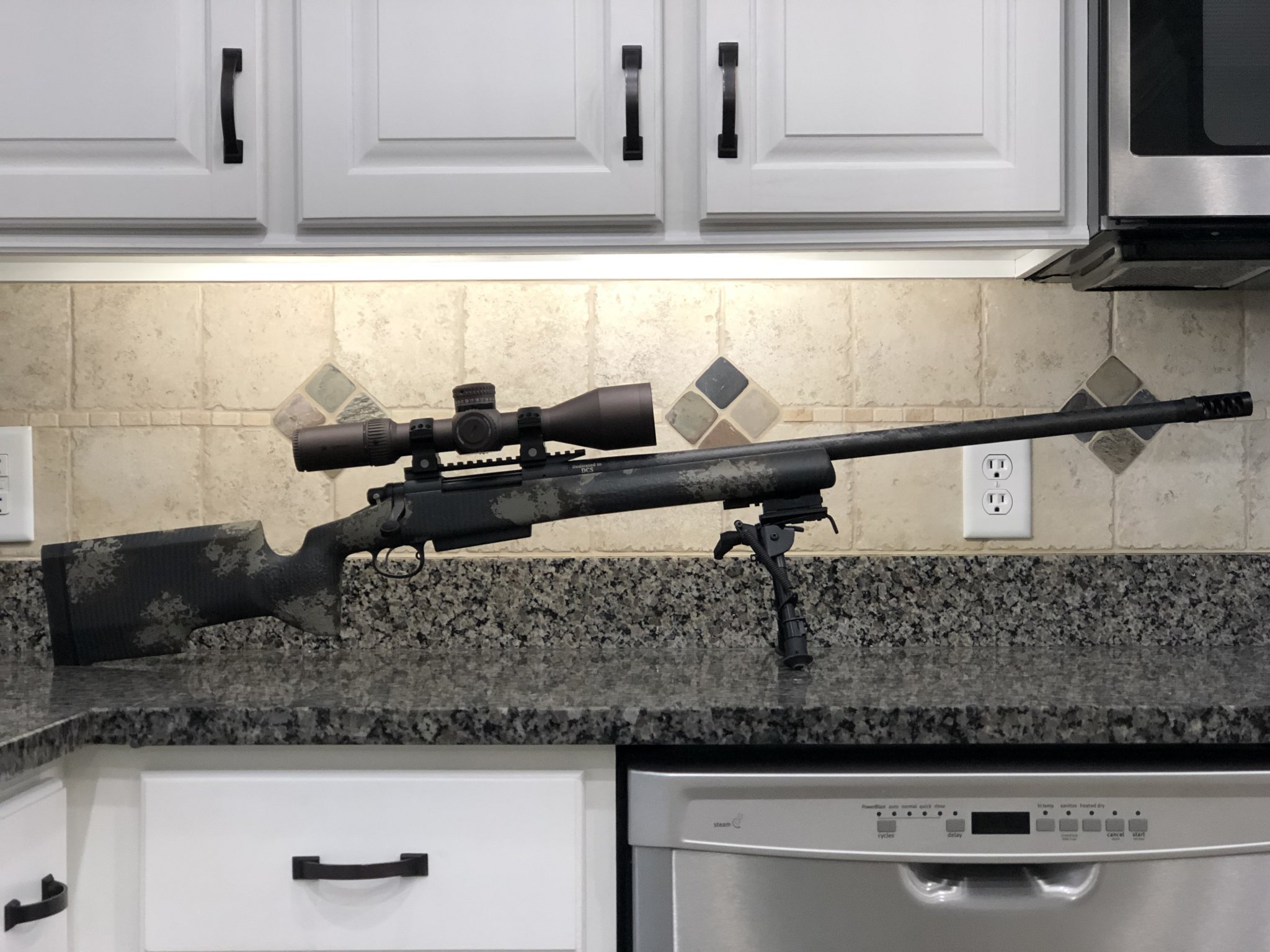

I just built a pair of these and may I offer a few suggestions. I would chamber in 300WM with the Rhian Manthis reamer and shoot 215 Bergers. I am shooting a 215 Berger over 3100 FPS out of a 26” proof barrel using VV N570 powder and its a fantastic and accurate load. I went with a Manners EH1 carbon fiber stock, NF base and rings and NF ATACR scope. I used HS Precision DBM due to its ability to sit flush with the stock. This package weighs just over 10 lb and was even less when I had the Zeiss V6 scope on it originally. Honestly, it needed a slight bit more weight to be accurate. The other one I built almost exactly the same for my son except he wanted a T4 elite stock and went with a Razor Gen 2 scope. If you have any questions feel free to PM me, I would be more than happy to help. Go over to longrangehunting and read some of Broz’s posts abt the RHian Manthis reamer with the 215 Berger.

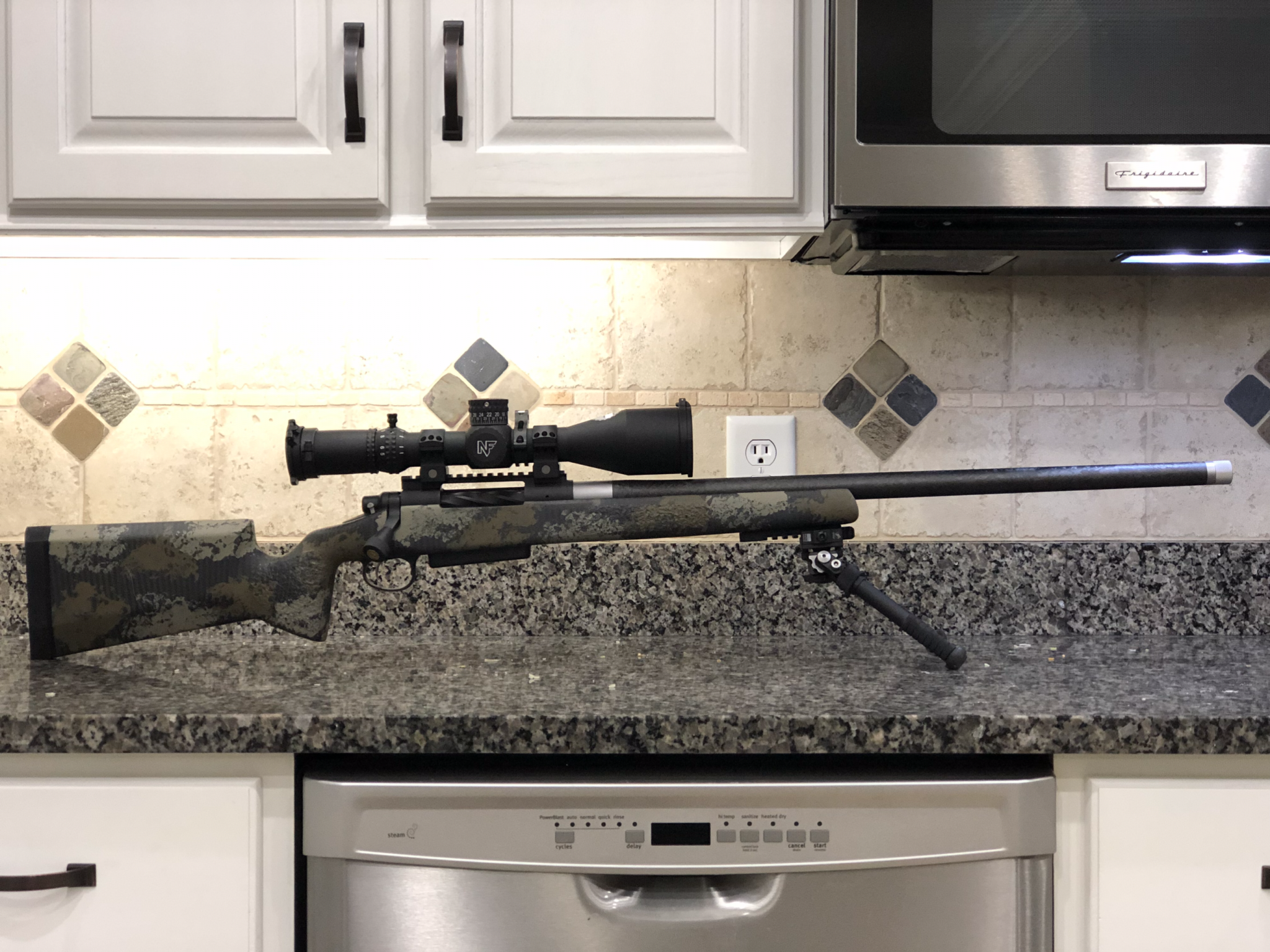

I did a similar concept without the titanium. Carbon 6 Tikka Pre-Fit in 280 AI. Tikka T3 action, need to order the McMillan Sako carbon stock this week. I ran numbers on the 168 and 175 Nosler Accubond LR and I will have 1500 ft lbs of energy at 750 yards, which should be plenty.
