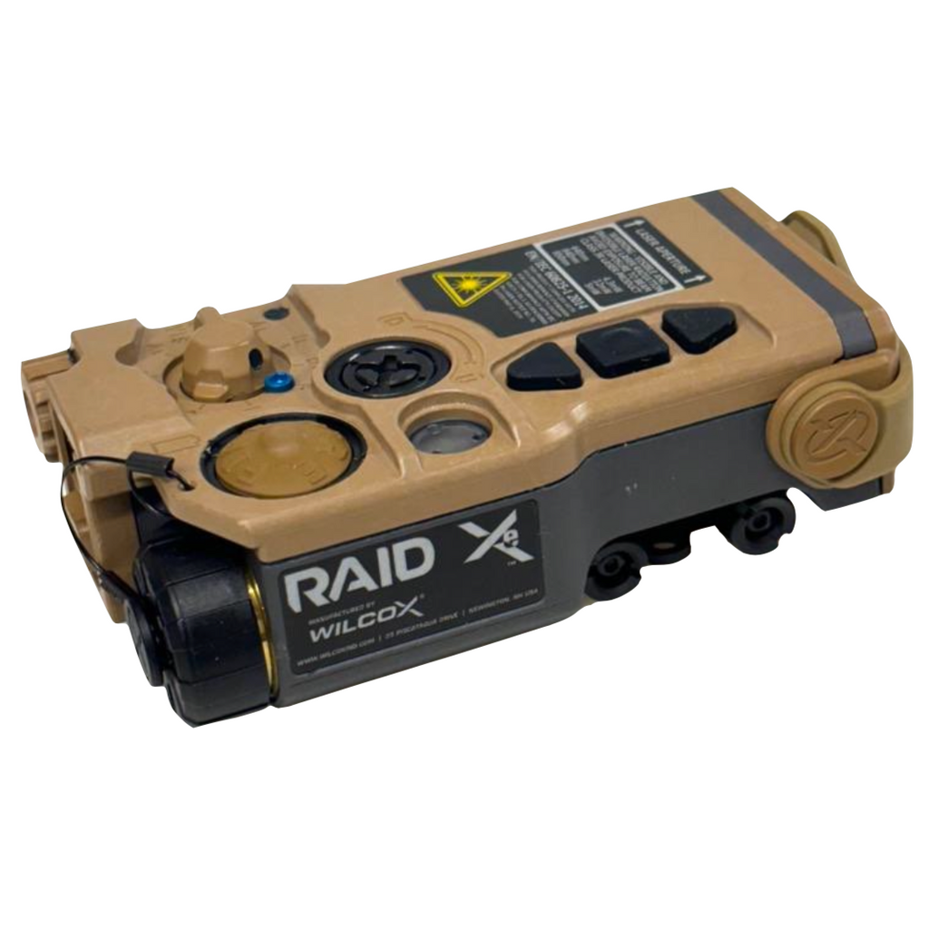

Wilcox has two new options being released shortly: A RAID-X with a rangefinder, and a miniature RAPTAR with ballistic software (also capable of sending info to a thermal with a disturbed reticle).
Neither will be cheap (3500ish for the RAID with rangefinder). Raid would rock for an assaulter who was more precision oriented. Mini RAPTAR would rock for snipers.

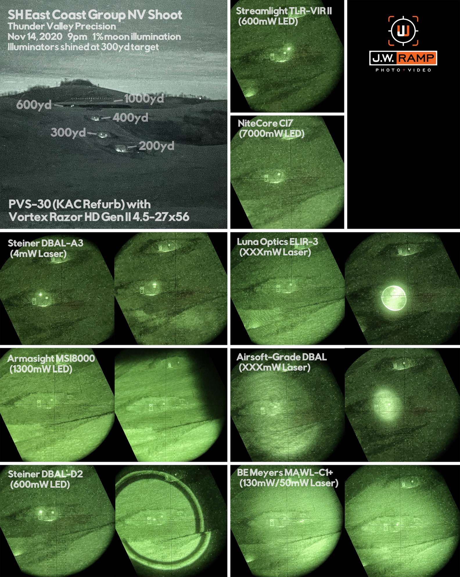

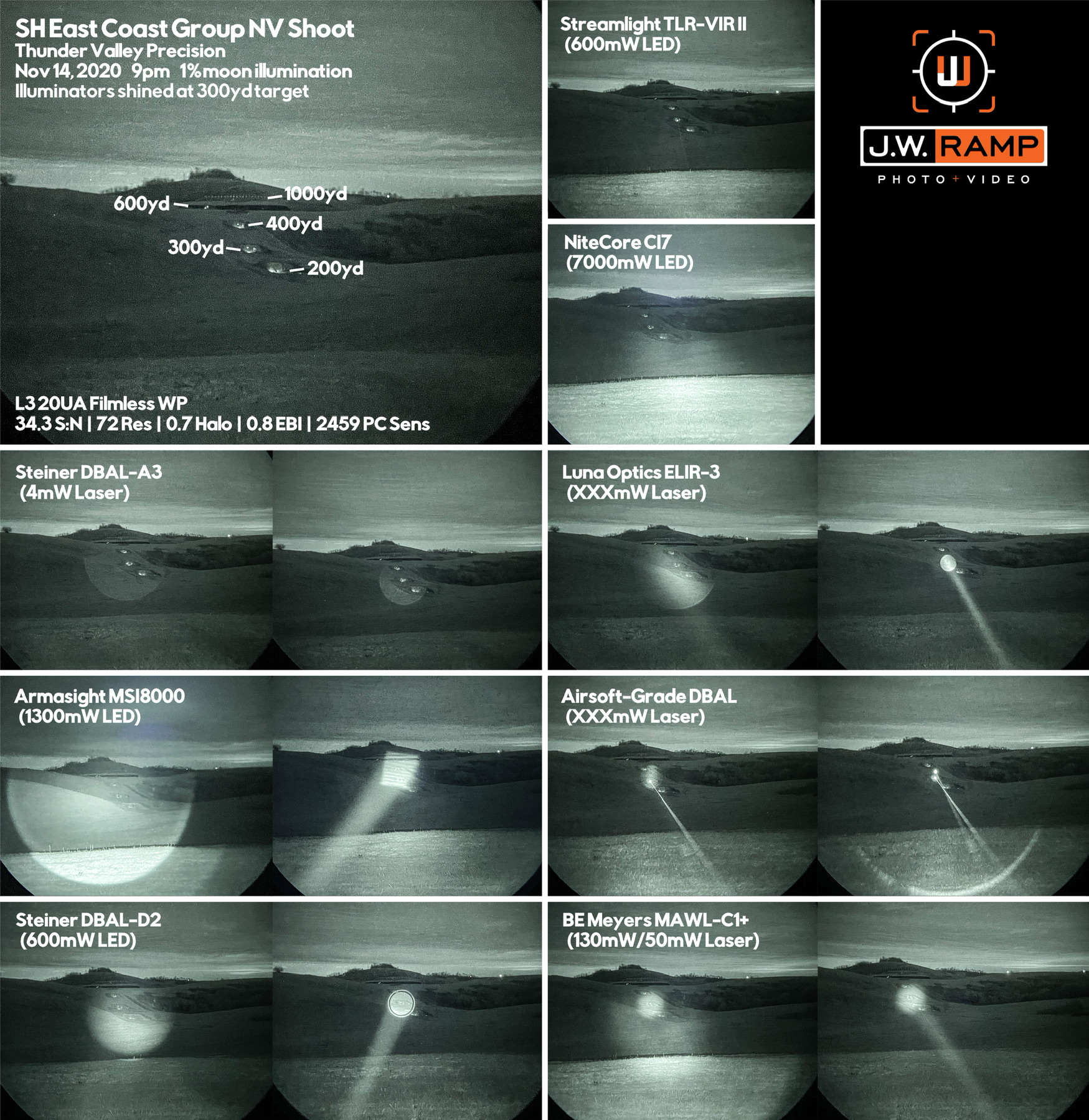

Some illuminators to compare against for distance shooting -
The last I had heard was that the luna was a 250mW laser - I have compared it to a 250mW lab laser we had and it seemed comparable.
DBAL D2 is actually one of my favorites in some ways - and the SPiR as well. Main reason is safe illumination and good performance.
Would love to see a D3 model with a new 1000mw+ emitter.
I dont think the Luna is quite that powerful. I have a 45mw Peq and a 200mw Dbal as well as the Luna and the Luna I'd say is somewhere in between.
I used to have a D2 and I miss it. Very nice beam on the D2s.
Russian laser power output is all over the place frankly. I dont think they measure/adjust it at all before shipping the units.
Took one unit apart once when we broke the lens on it just for shits/giggles. It didn't have any sort of potentionmeter or anything for laser power.
It worked by prayer.
There are two of those for sale in marketplace 😁 😁
Reactions: NHPiper
Early Lunas were advertised at 90 mW. Current versions are 70 mW.
Any info on the Raid-X w/ Rangefinder anywhere?
You’re right, I’m not sure what happened. I’ve kept that page up for a month and it’s not the same info now.
there’s obviously still this:

Wilcox released the MRF range finder. Very similar in size to raid xe but does not have an illuminator. I don't think you'll see any new LRF with Illum in the near future from US DOD suppliers. We use very little Image intensifier clip on NV anymore in a mil capacity. The move has been made to thermal ( mid and long wave) so the LRF development has been morphed to smaller, lighter more powerful LRFs like the MARS and MRF. The lasers are there for collimation only.
