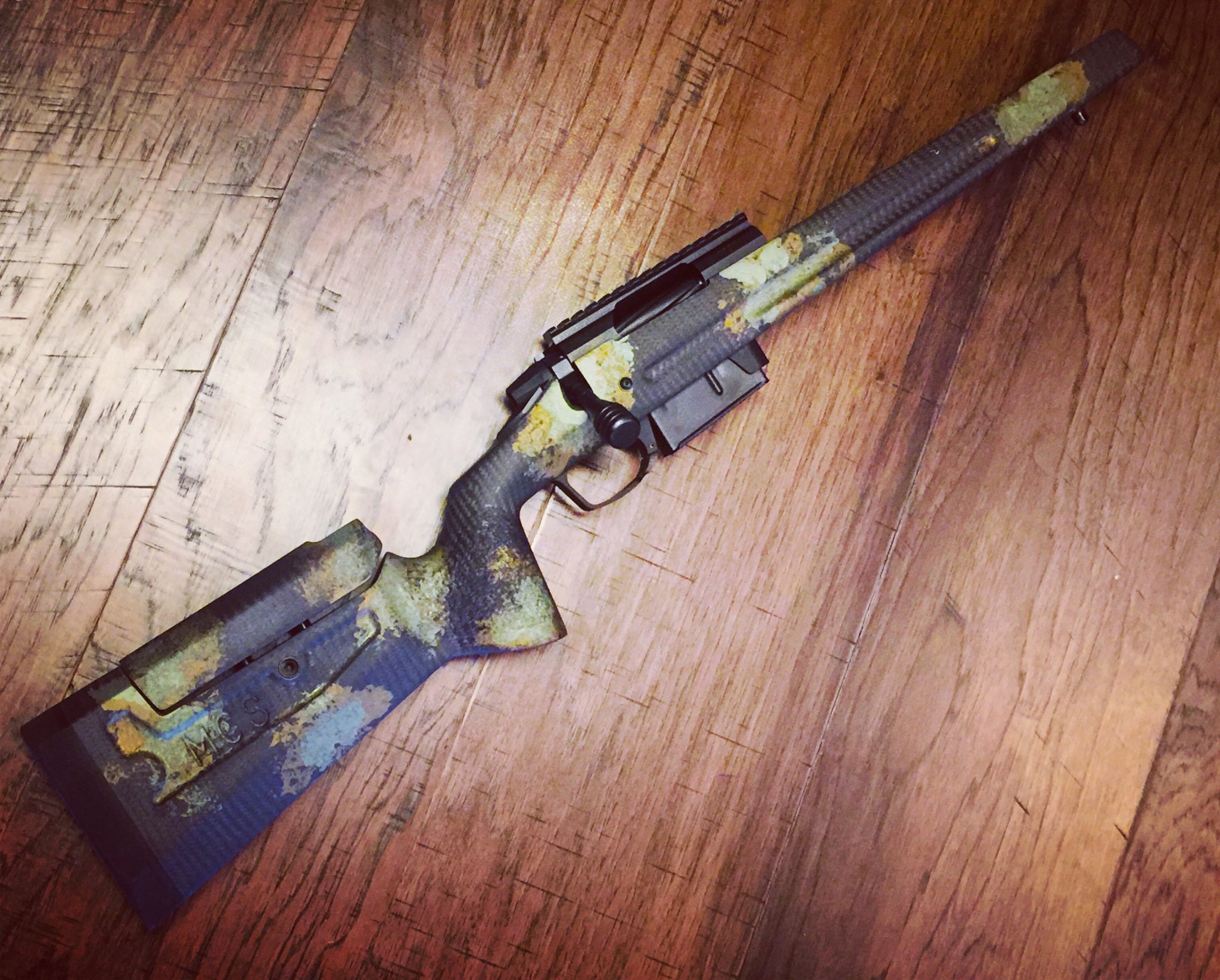

Working on something similar. This is 6# as is. So add a 2.8-3# barrel and a scope I’m thinking 12# tops. Just need to decide 7 saum or 6.5 prc. Western Oklahoma hunting rifle occasional Elk...

There's lots of different chamberings available now, but I don't think there's anything particularly wrong with a Win Mag either. Personally, not having any Magnums now, I'd probably go for a Win Short Magnum ... or .300 Norma Magnum, if I wanted MORE.
That’s my favorite stock for looks, I am just going with the EH to save weight.
Reactions: KPK
This one with the chassis system and mag weights 3lb 11oz. Without the adjustable cheek it would be really light. I’ve just almost gotta have the adjustable cheek.
The scopes my biggest weight problem. I want to mount my Schmidt but damn they’re heavy!
I have a manners with adjustable cheek and one without on rifles, both have ATACR scopes on them and both seem to fit me fine. I may need to look into the PRS series stock, I just assumed it was way heavier.
I actually think it’s lighter man. Apples/apples with cheek and all.
