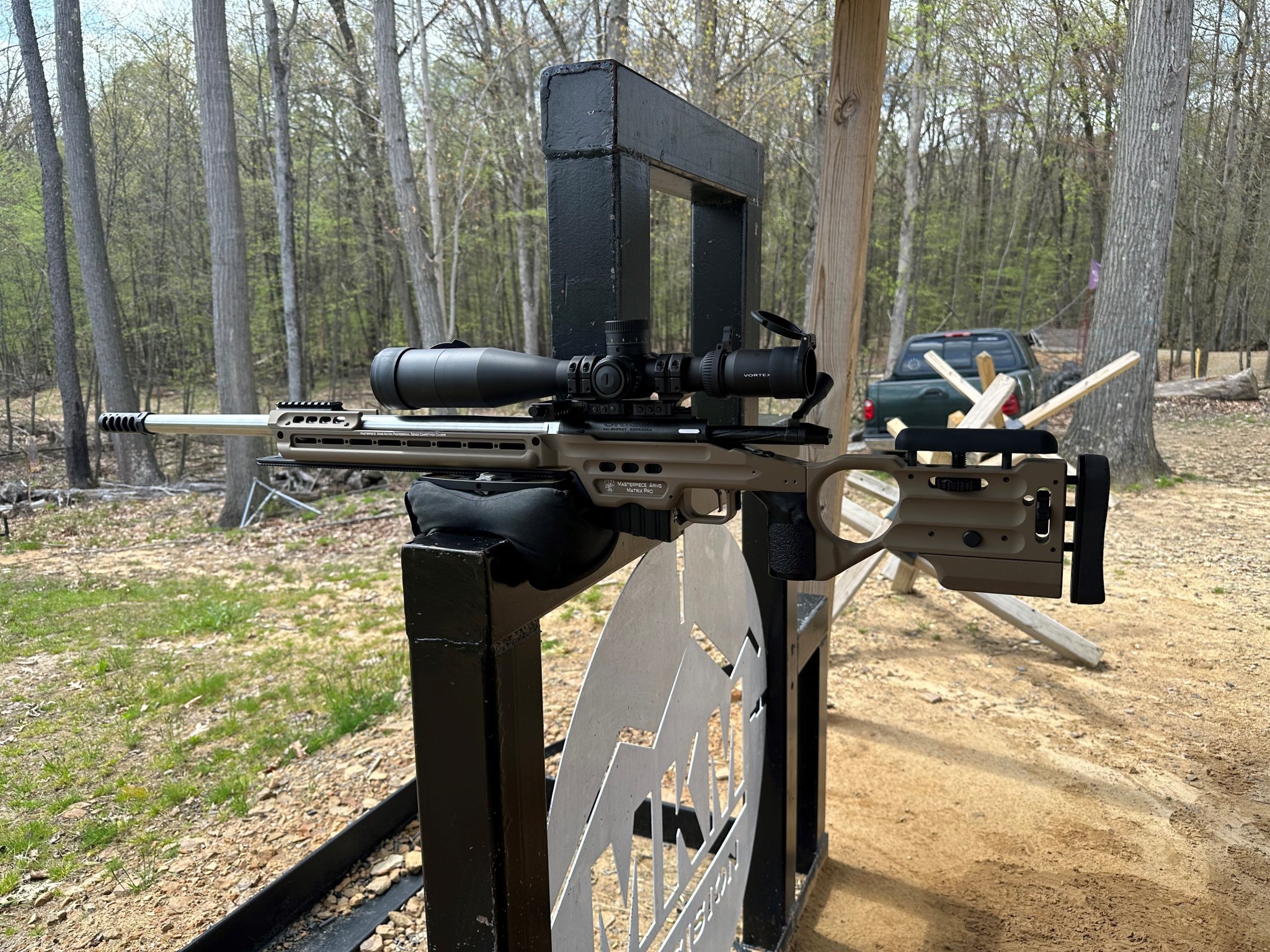

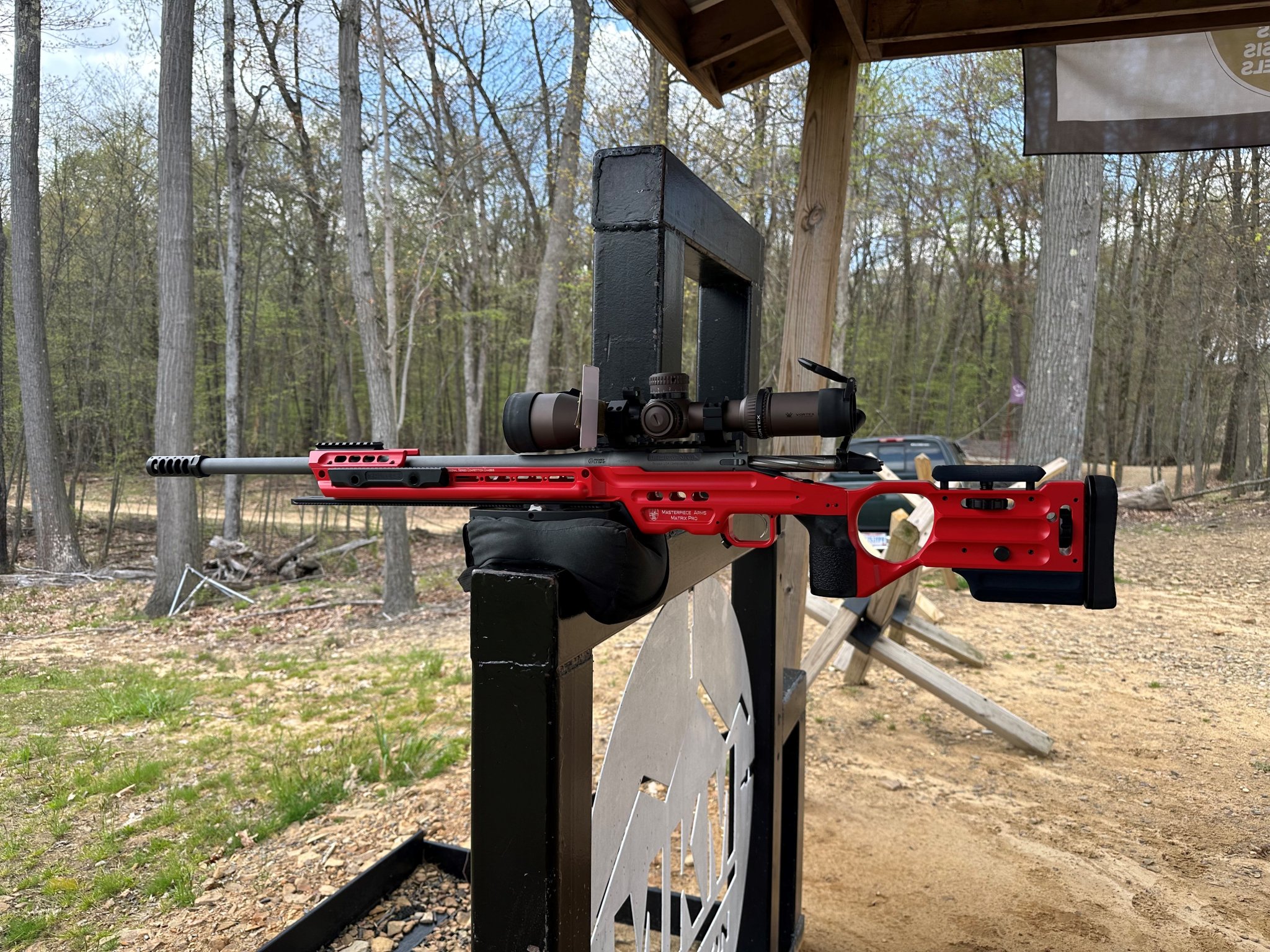

Zeiss S3 6-36x56 or for less money the Tract Toric ELR 4-25 with MPA or ARC M Brace mount- Glass
Would kind of look like this when done. That MDT scope mount was swapped out for an ARC. Bought the MPA Matrix Pro chassis for sale in the PX.
There's many ways you can go with this build.

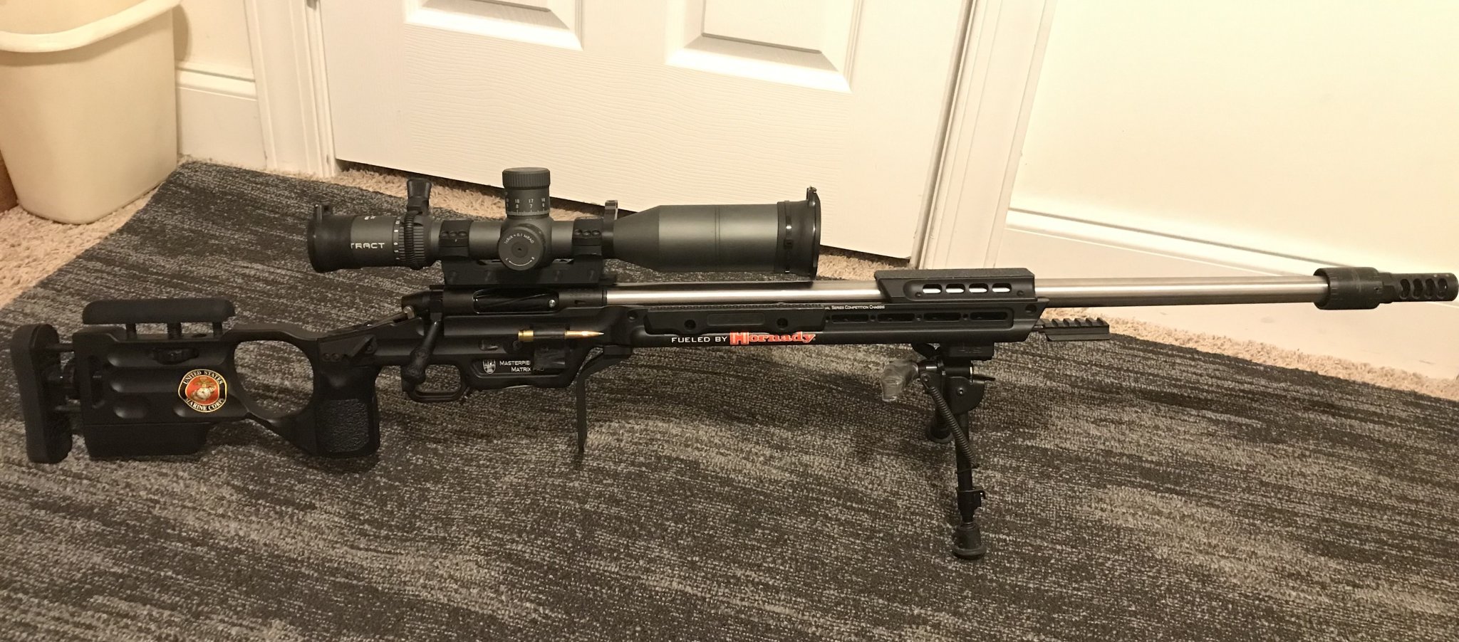

The 3 big expenses on the rifle build will be the action, barrel and chassis. There's options all over the spectrum for pricing. Rob's build spec will be hard to achieve under budget, unless you buy some of the components used.
Here's a build that will get you right under $3K:
- ARC CDG or Zermatt Origin - $900
- Prefit Barrel - $800
- KRG Whiskey-3 Comp chassis - $1000)
- Trigger of choice (TT or BnA) - $275
Total = $2975
I put $800 for a prefit, as that's a fair representative cost, and what TS Customs charges for a Benchmark Prefit (amazing gunsmith btw). You can save $100-200 elsewhere on a prefit if you want. The above would go over budget with a muzzle brake, which are $150-200 typically, FYI. A Proof or PVA pre-fit would save the $150-200 needed for a muzzle brake. Or take the ~$200 out of the scope budget.
For bipod I would just recommend a good old Atlas, which are solid and about ~$250. If you take the $200 for a muzzle brake, that leaves you with ~$2500 for a scope. EuroOptic has this Khales K624 for $2300, which is a great scope: https://www.eurooptic.com/Like-New-Kahles-K624i-6-24x56mm-LSW-CCW-SKMR4-FFP-Riflescope-10682.aspx
All in, that would be about $5725. I think this would be a really solid package for the money.

I just posted a thread on my build I have about 3600 into mine with an optic. I bought a lot used stuff here and managed to get a great deal on a solus action and barrel locally. I thing you can build a nice rig with the budget you have. There's a member here that sells solus actions for 680 if I remember correctly.

I really like the American rifle company CDG reciever I just got and assembled this gun myself.
got a PVA prefit in 6 creedmoor. 6.5 creed is a better choice for a beginner.
CDG action with fixed bolt handle
Trigger tech diamond trigger
Accuracy international AW magazines
hawkins bottom metal and standard latch
foundation samson stock
american rifle company low mount.
A nice suppressor like otter creek labs or my old ultra 9 will make shooting much more enjoyable and likely make you better for it.
