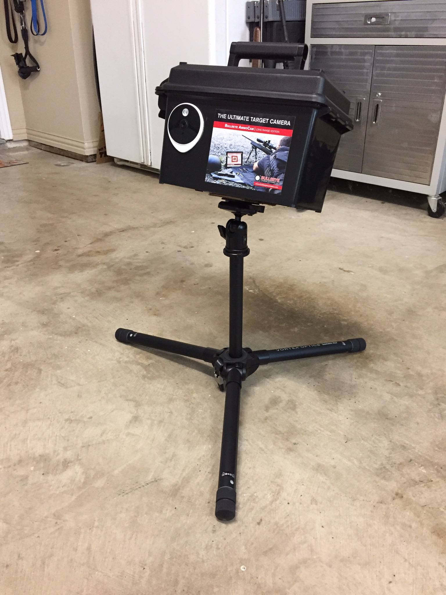

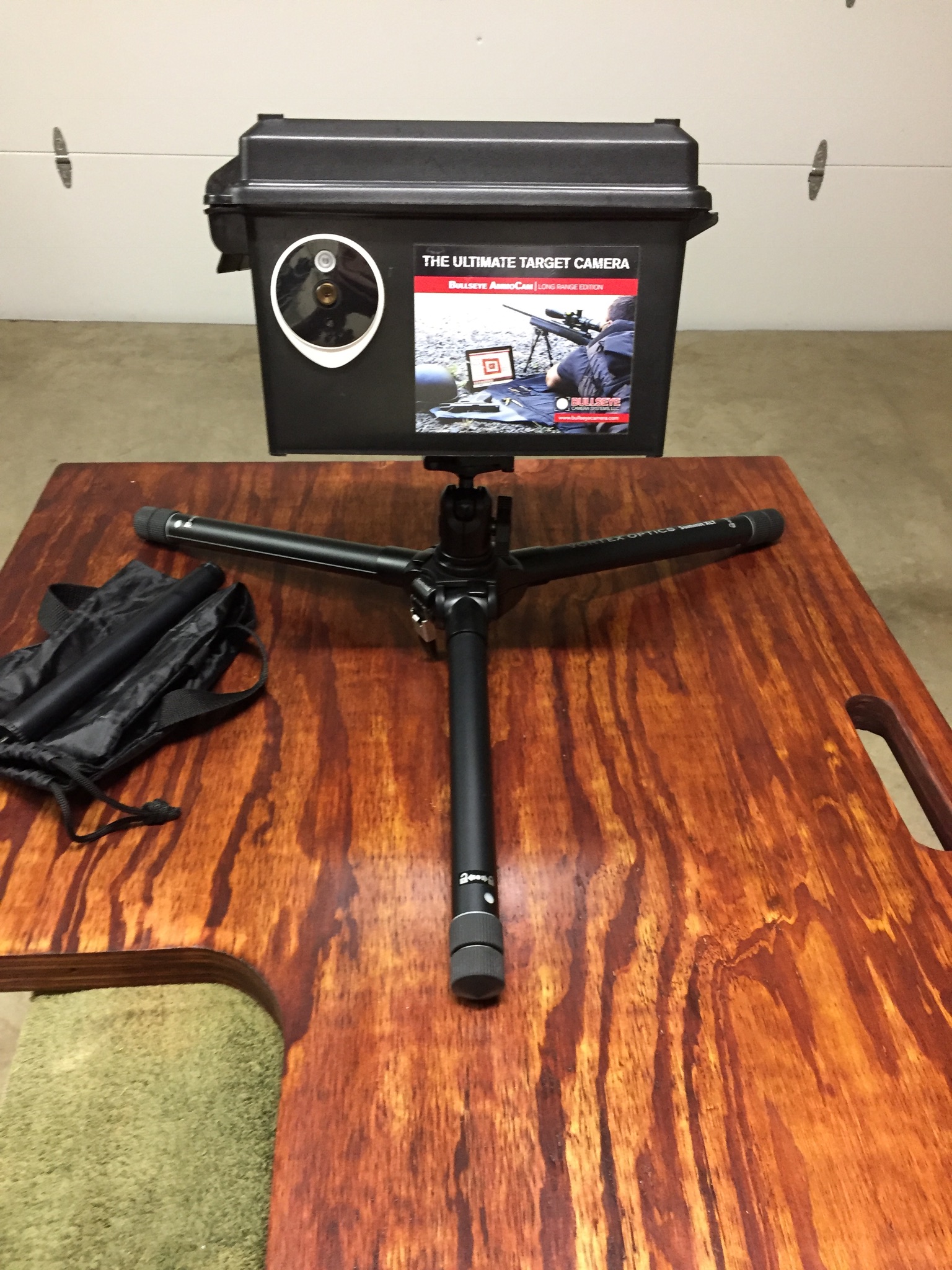

First time at the range today with the Bulleseye AmmoCam long range.
Works as advertised at 100 yards at a fairly congested (lots of steal, wooden baffles, small berms etc) range in DFW. (Halthom City gun Club). Works great except would not paint .22 rounds on a black bull. Am told turning on the night IR helps with this, but don't know how to do this yet.
Will try at 200 yds Sunday and report back. It really works well with white background targets and paints near hole in hole 22 shots with ease. Seeing each blinking consecutive shot really is a blast. Ladder tests at 200 will be a whole lot easier.
Also paints pellet rifle shots perfectly.
So far, I really like it. Beats the hell out of a spotting scope.

DIY
Reactions: stevenc23
I have the bullseye ... I guess I also got one of the early ones. But I got the extra "long distance" add on. I think that was supposed to make it work out to a mile. My experience was I could get it to consistently work out to 200yds, but only about 10% of the time out to 500yds. I live in the "Flint Hills" of Kansas. When I talked to the BE folks on the phone they acted like it would work fine on flat ground with no vegetation. Unfortunately, we don't have anything like that around here.
It anyone wants to give it a try, pm me, I will let it got for pennies on the dollar. Sounds like upgrading to the "HD" system might help. And living in an area with flat ground and no vegetation might help also.
