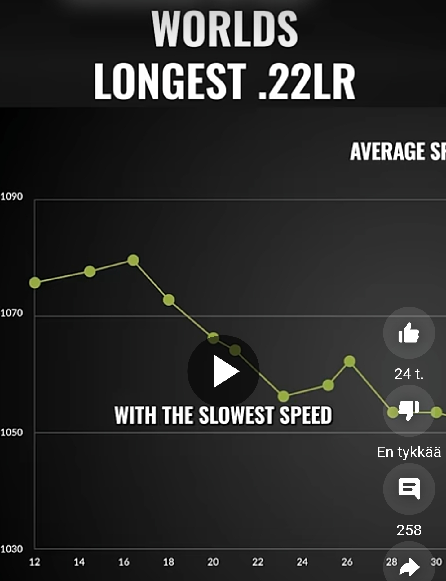

MDT ran a 31" cut to 12" over a chrono
Here is the plotting, do not mind the slowest speed text.

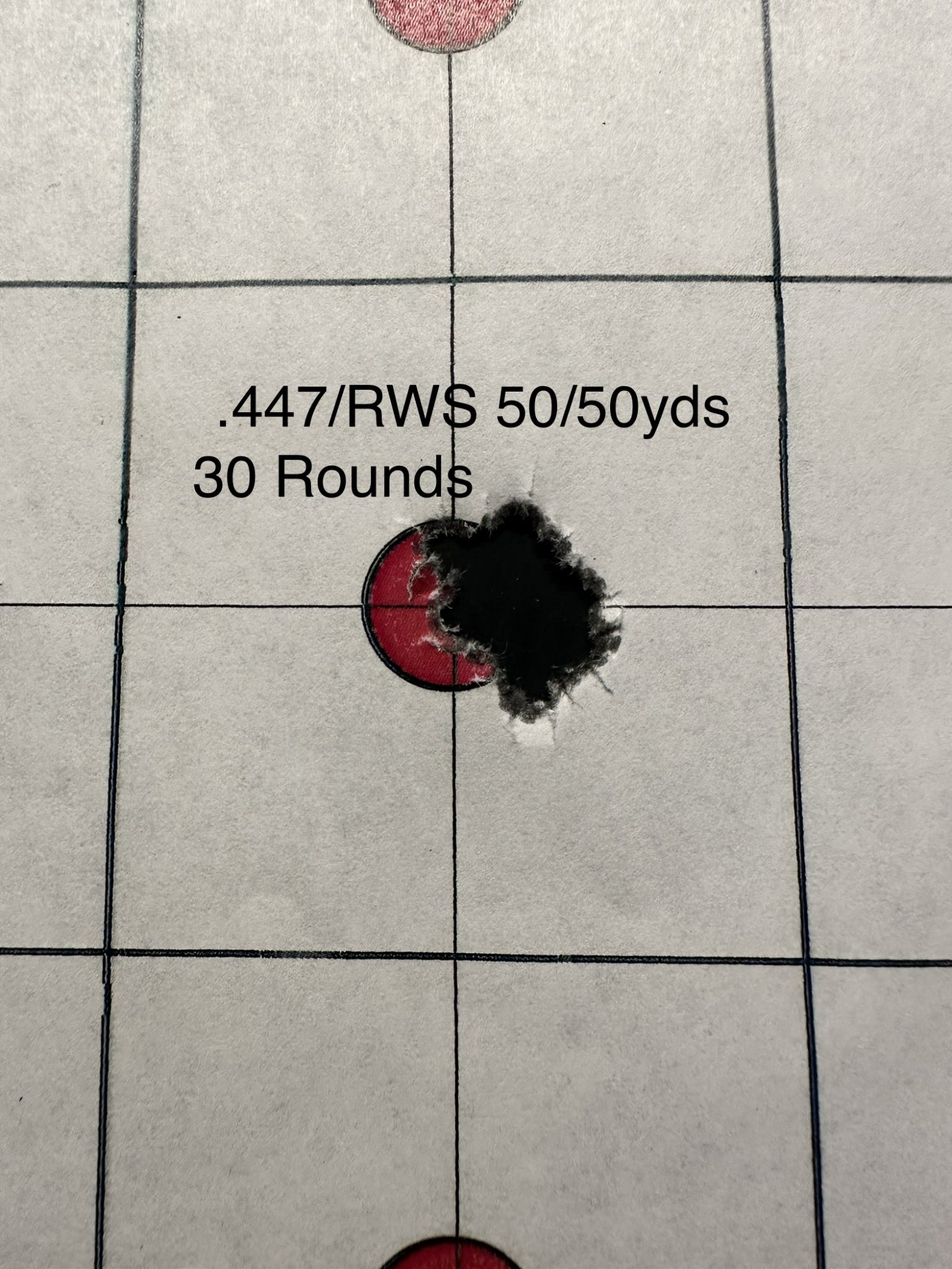

Yes sir I agree. I did notice this with Lapua ammo. I ended up using RWS 50 cause it showed me the most consistent box after box. Like this past weekend I was just messing around at 50yds and shot this 30rd group. I’ve been very happy with RWS.
