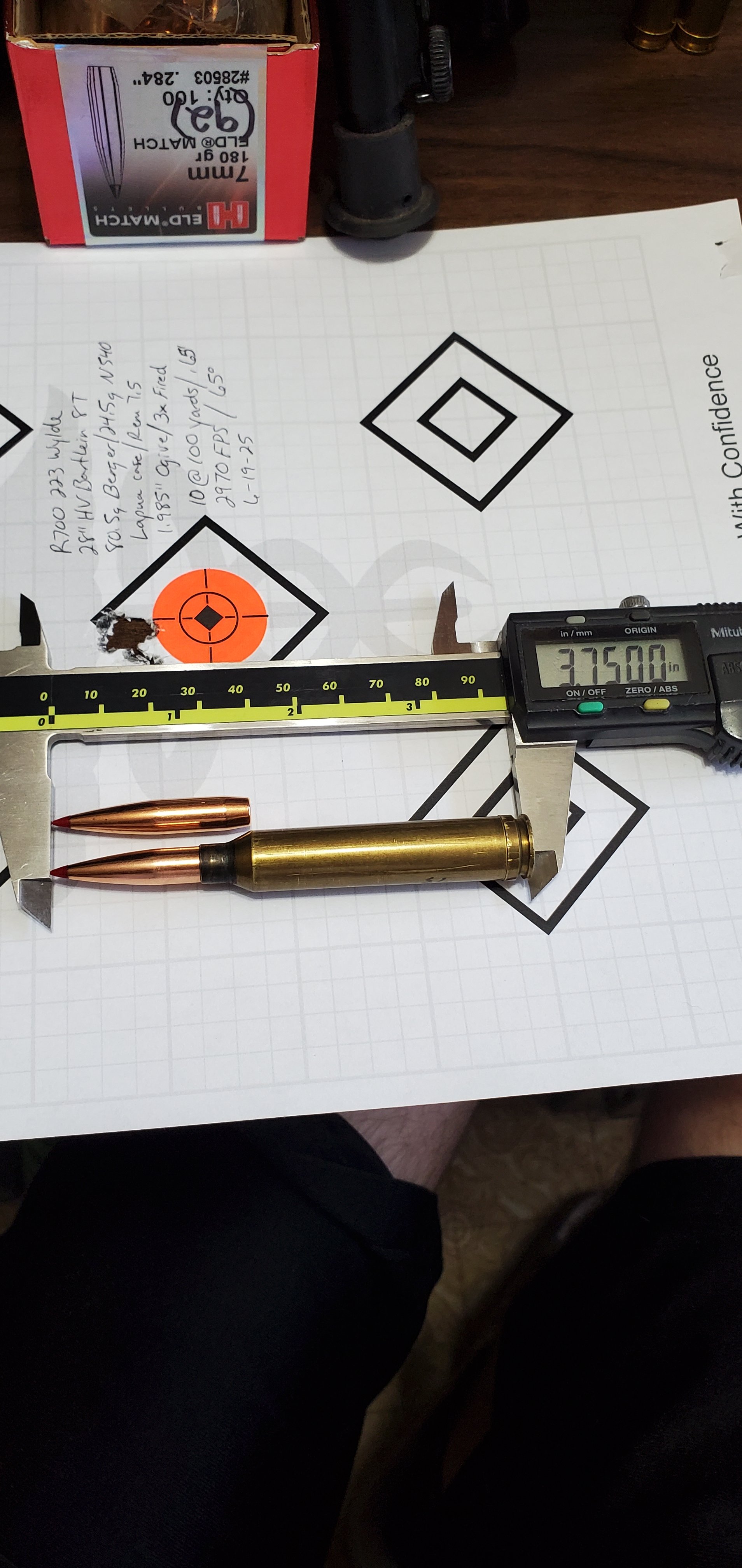

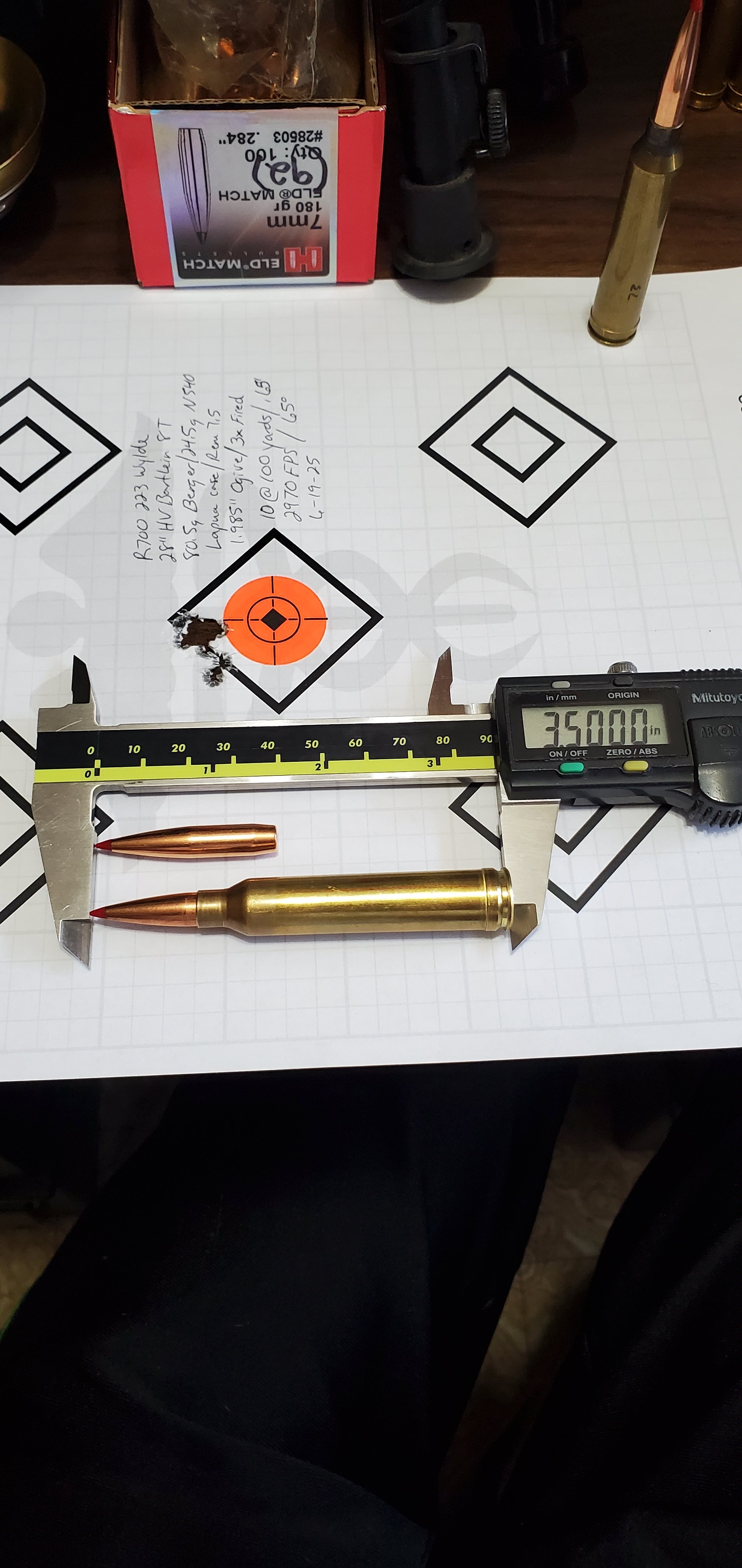

I was doing some tinkering around with my Rem 700 in 7-300 win mag earlier today with bullet measurements. The smith who built the rifle didn't really throat it properly unfortunately. On the flip side of that, its also probably the best shooting rifle I've ever owned. When I had it built 10 years ago, my plan was to shoot the 162 amax from the 28" Bartlein 9 twist. There were no really good high bc bullets other than the 168/180 bergers back then. Anyway, the 162 amax hit the lands at around 3.450" which is very short, and the bullet is seated way down in the case. I shot them for 7 years or so before finally switching to the 180g ELDMs. These hit the lands around 3.5" But again, these are seated very very deep in the case. The dreaded "donut" got me thinking well just how far out do these 180s need to be seated to not be in that area? I haven't experienced donut issue yet from the Nosler brass that's been fired about 10x, but just got me curiois anyway. From my crude measurements I'm coming up with around 3.750" which is a tad bit longer than you can fit, feed, and function through the factory mag. I'm well aware of Wyatts extended box mags as I had to have one for my 338 EDGE/300g SMK build years ago. I think that allowed me to get to 3.8" or so. I'm just wondering if that is the most cost effective way to get a longer COAL? I have a McMillan A5 stock, but it's just inletted for the standard BDL bottom metal. Would it be worth it to convert to M5 AICS mag setup? Can a guy install the Wyatts mag box himself? The M5 detach mag set ups are pretty spendy from my limited research. Could I have a smith go in and just ream out the throat to the new desired length? And if so, could that potentially be a risk on ruining how it shoots?Here is a couple pictures to represent what I'm talking about with the bullet lengths.

CIP length AICS style box mags can be obtained for 3.850" iirc. You might have to open the inlet in the stock, not sure, you'd have to compare that BM to your current, and then you'd probably have to notch your feed ramp on the 700 action, and then you'd have to throat the chamber out. Then relook your loads with some more development. And then at that point you'd have how many rounds on the barrel? And how many rounds would you expect a 7-300 to go?
It sounds like the most efficient thing to do is simply throat your current chamber out .200" and gain some case capacity within the confines of your current mag box. Might till have to notch the feed ramp. And you could do this with about $175 in tools. I have hand throating reamers in 22, 6mm, and 6.5mm and have throated many barrels out.
