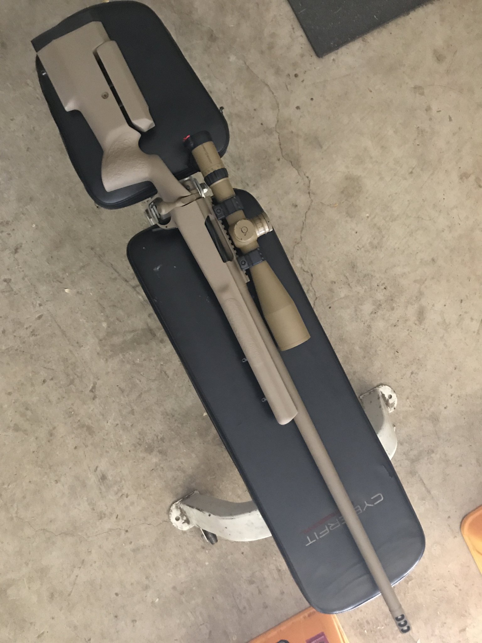

Here’s a 28 inch MTU in a T4A on a stiller 338 action. I know it’s not a Remington, but this has no barrel pad etc.
