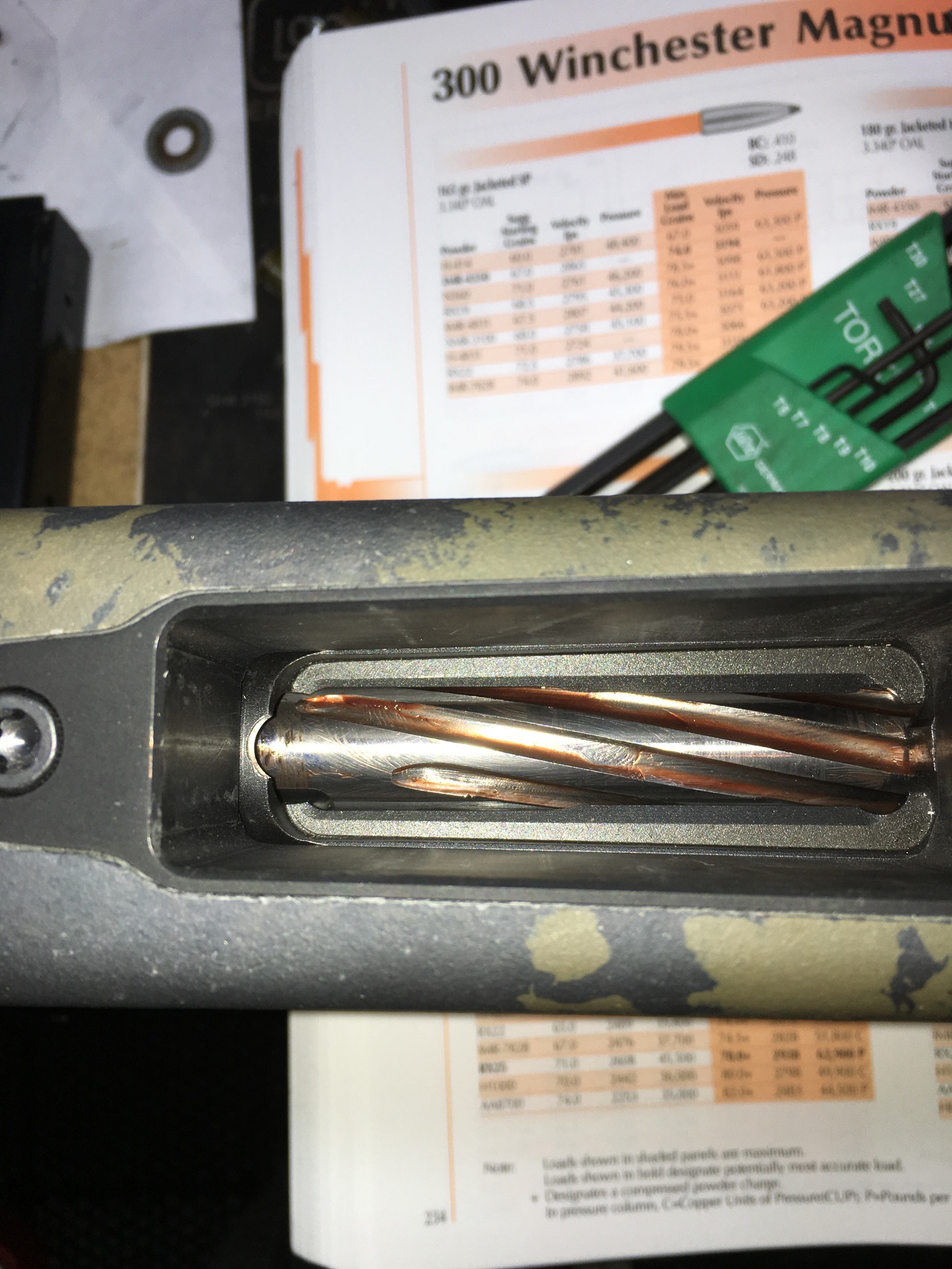

I have a rem700 in a manners stock with the badger mini chassis. I have a few AICS magazines but I need a longer OAL than the 2.89”.
I have an ALPHA mag which fits (and has a longer OAL), but I’m wondering if the AW and AX mags will fit the bill as well?
178gr bthp. They’re loaded at 2.90 but I can go out to 2.92. I’m using modified Pmags right now that allow me to go to 2.90. I’ve milled the receiver to allow the longer OAL, just need to know if the other mags will fit in the bottom metal.

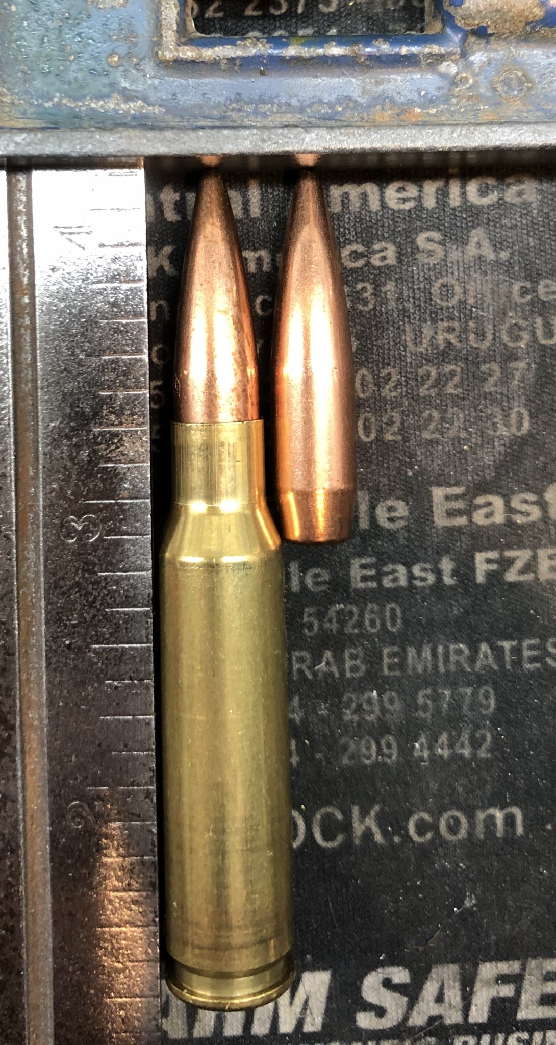

This is at 2.90. 2.923 is when the bullet touches the lands. Maybe I’ll play around with the seating depth and see if there’s any benefit/detriment to accuracy. Accuracy right now is pretty good though.

Bumped some rounds back to 2.86, which now fit in the AICS mag fine. Groups at 100yards were just as good as the longer OAL. Thanks for the feedback.
