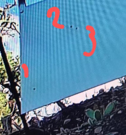

You're looking back at 2017 KO2M? There's been a lot more done since then. I was the only one to hit the 3521 plate at King 2022 with a second round impact after the 1st was .3mil left . The technology being used by us "civilians" is cutting edge, and is later adopted by the military after testing and proving. There's no point in arguing what's going on in the civilian shooting world or the military community as it's very well harmonized and training for a lot of the ballistics technology and new rifle systems happens by using civilian contractors to teach it to the spec ops communities.
Reactions: BCX
38 inches and change? Or did I skip a digit?
The correction from my spotter was right .3 which centered my second shot up on the plate after going just off left edge with the first shot. All of our wind and elevation calls are from center of plate.
During prelims I had a correction after the first shot on target 4 at 2668 where my spotter saw the impact low left on the plate and called .1 up .1 right which ended in shots 2&3 totally centered on the plate within 2" of each other

So yes 38" from center of plate .
Good! I can still think "mil". It's been a while. I got 38 and a bit of change. 38.02+ .
Yes I used a basic calculator. I may have been that good once, no more :-/
