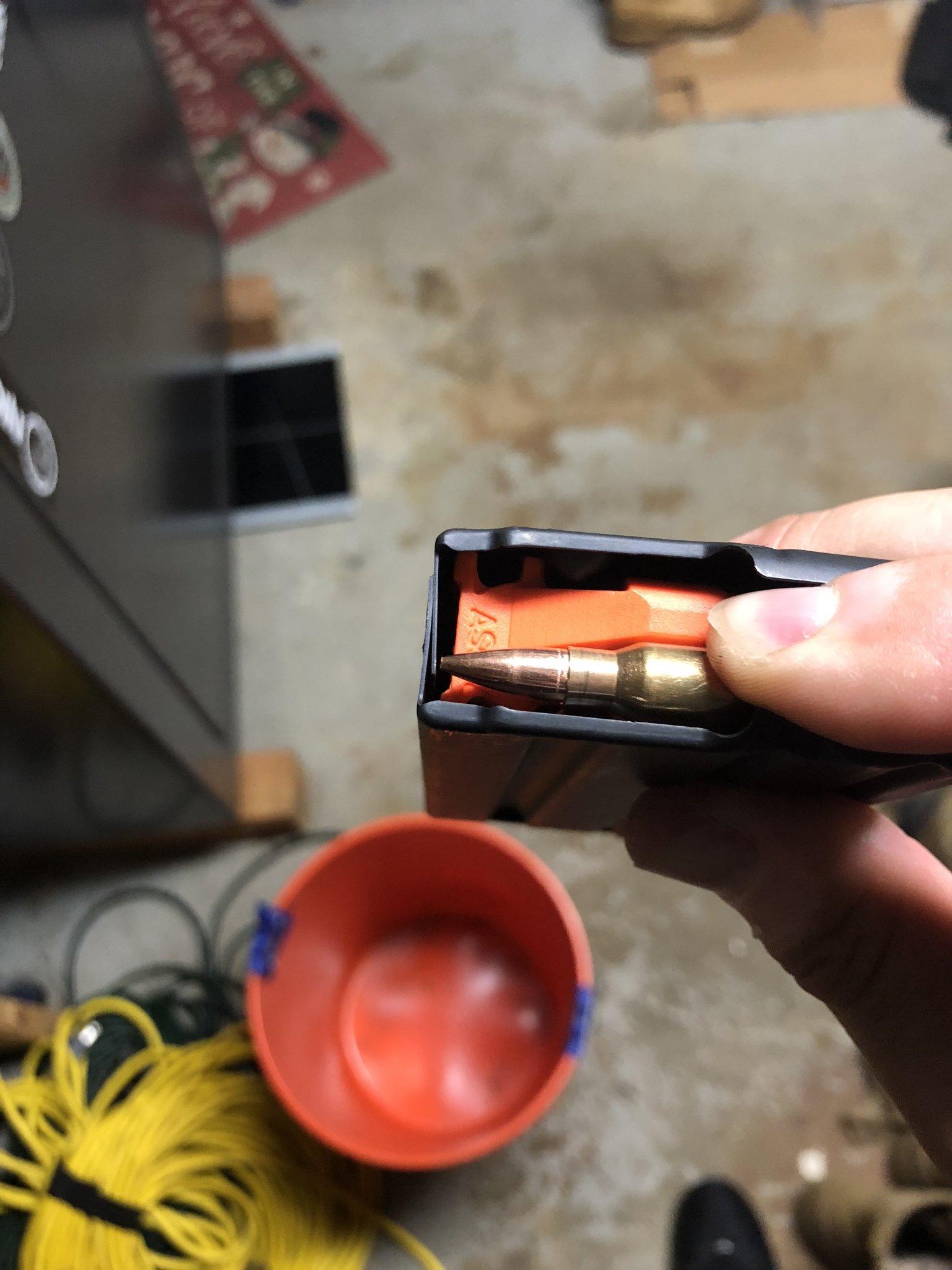

Can you take a picture of the top of the mag facing down?
About half my ASC mags are capable of handling 2.310". The other half have a little tab from an improper weld that takes up mag space.

Sure. That sounds identical to what I have here.
Yep. That's your problem. Unfortunately a number of the mags they put out are like this.
Grabbed them from gun mag warehouse online. I’ll reach out but do you know whether they admit and rectify the issue if you own one of these? Seems the whole order (4 mags) are like this.

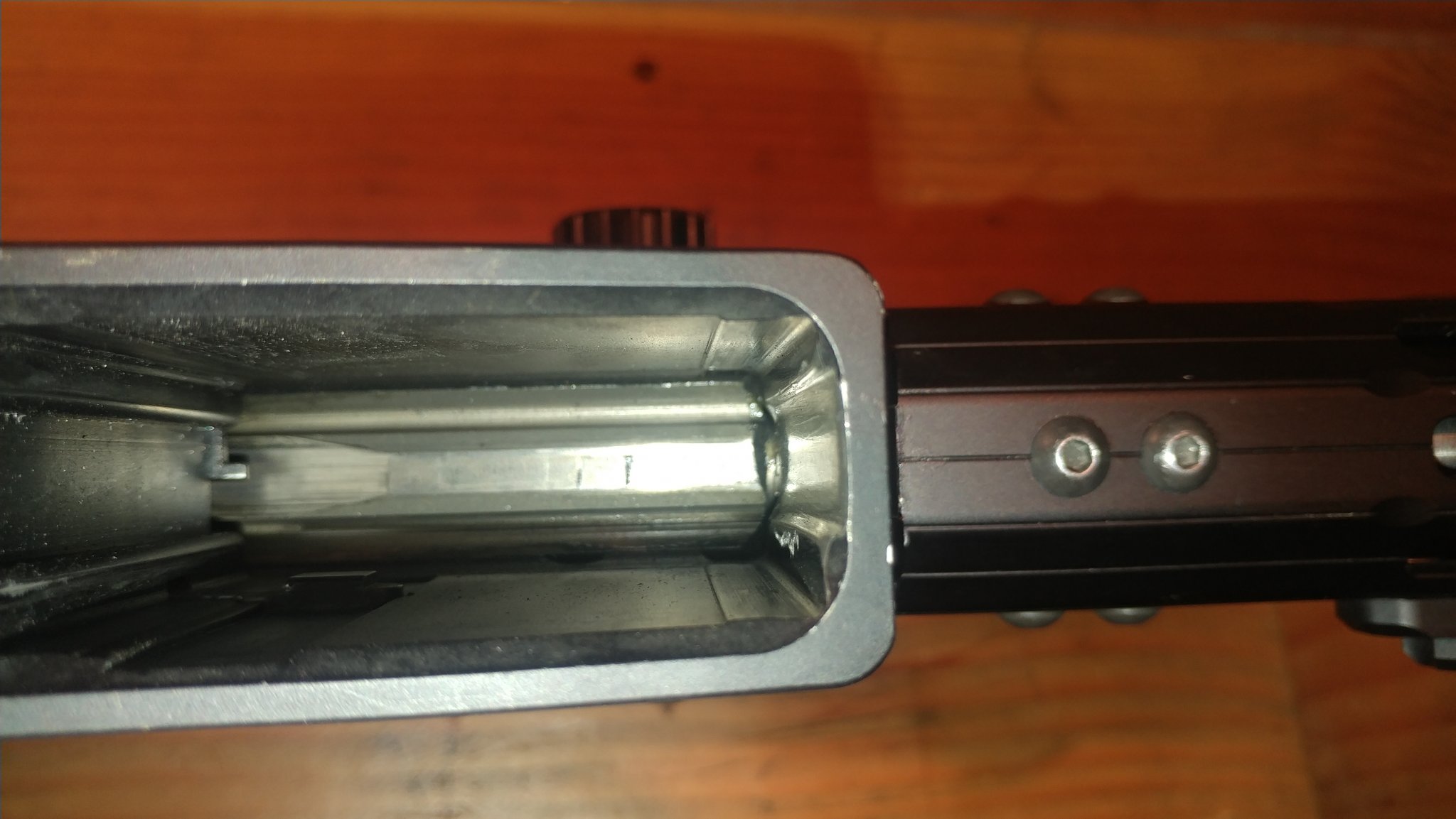

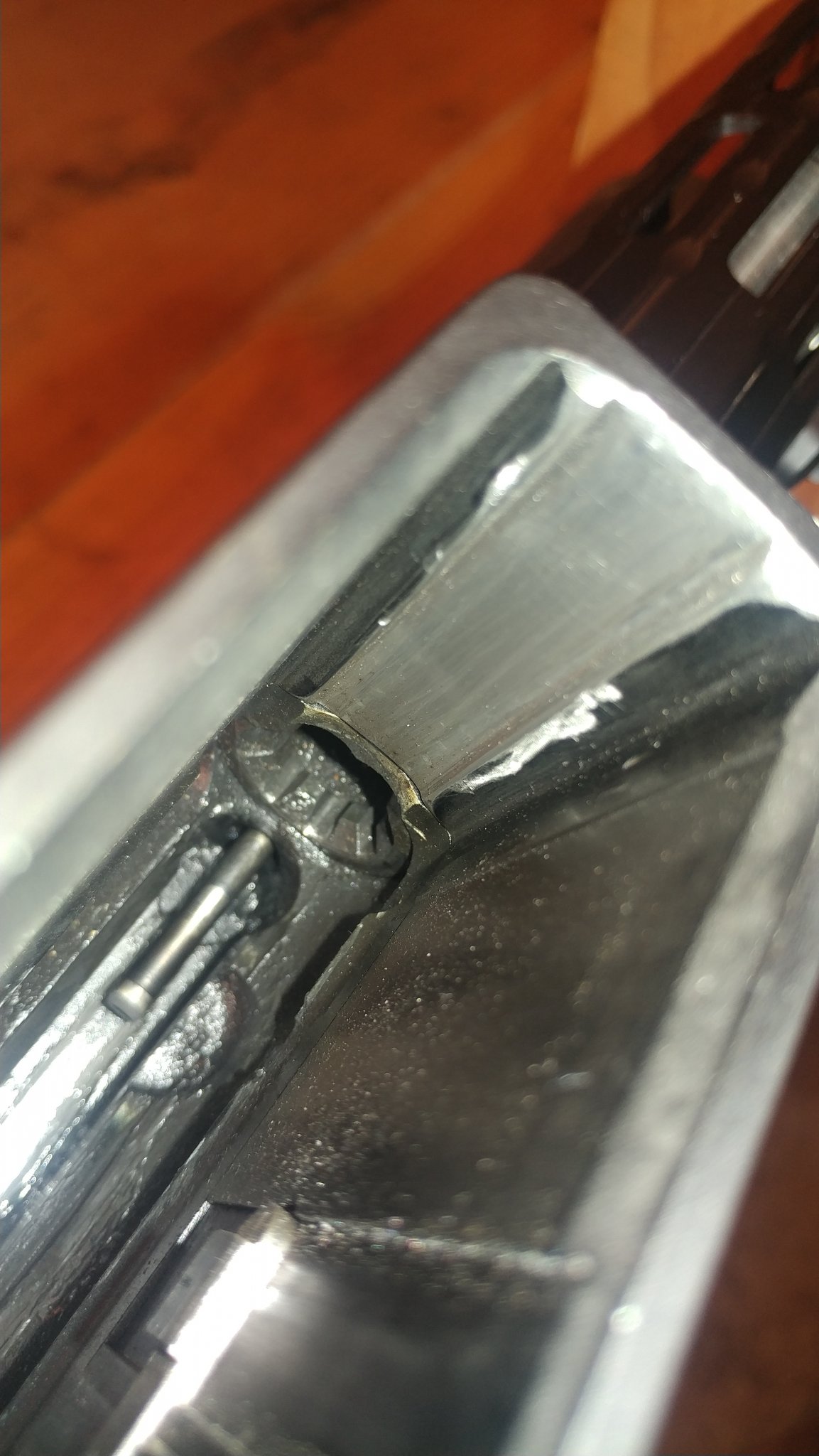

One shooter on 6.8 forum also cutout his magwell and modified his feed ramps to get 2.425" COAL.
I've been shooting a 223 like this for a while now. Loading 75 ELD's at 2.41" near 2900fps really puts it in different league than lower BC 77's at regular mag length.
Just cutting out the front of the mag and filing out a notch in the magwell for more bullet tip clearance then a matching notch in the barrel extension. It's like half an hours work, triple that if you blend it all and polish it to look professional.

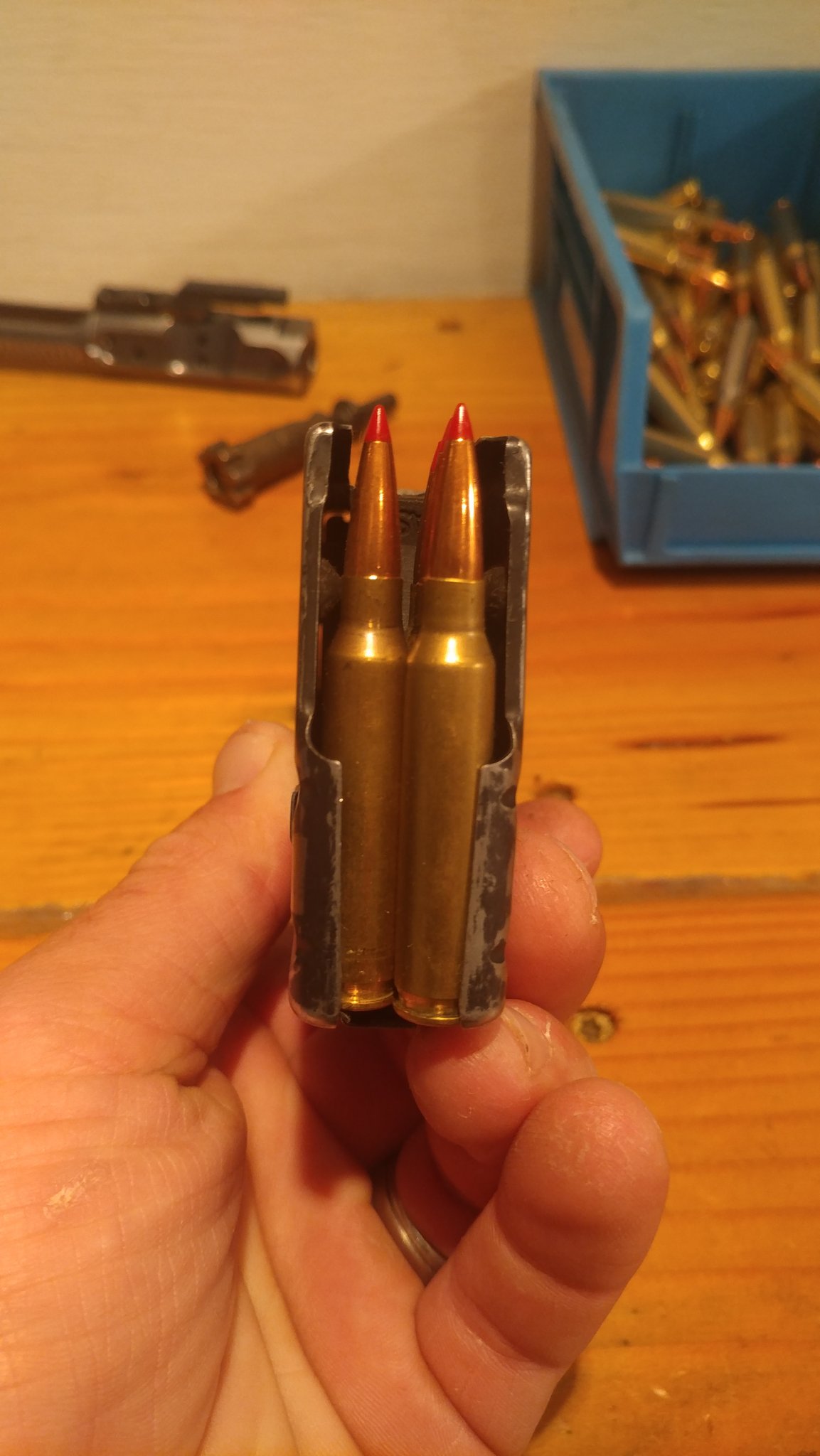

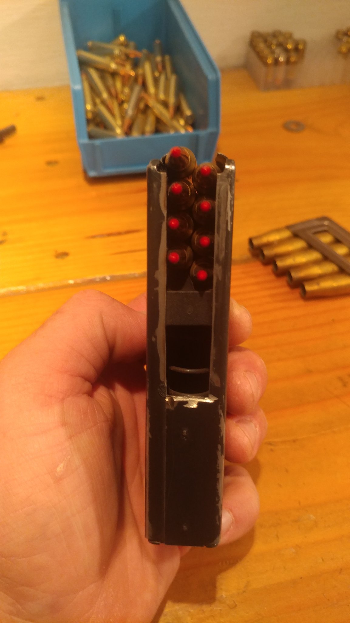

@Longshot85 My load is 24.3gr 8208XBR with CCI450's in prepped LC brass at 2.41" OAL. Obviously the long OAL is a crucial part of getting that much powder in the case without pressure issues, I also have a heavier buffer and the gas turned down to minimum on a rifle length gas system. I suspect if I changed any one of those parameters things could get sporty on me. Brass looks great and I haven't had any primer pocket failures over several firings and the primers only occasionally are slightly flatter on the edges, but all that said go slow if you want to try this yourself. Oh and I wouldn't bother cutting any mags that aren't stainless. Aluminum or polymer won't do.
Very interesting! I have a 6x6.8 that I've cut the front of the mag out. I can run 2.350" long and get reliable feeding. I like what you've done. 2.41" would let me try the 105 grain Berger VLD bullets again.
Thanks for the pics......I'm now inspired :cool:
