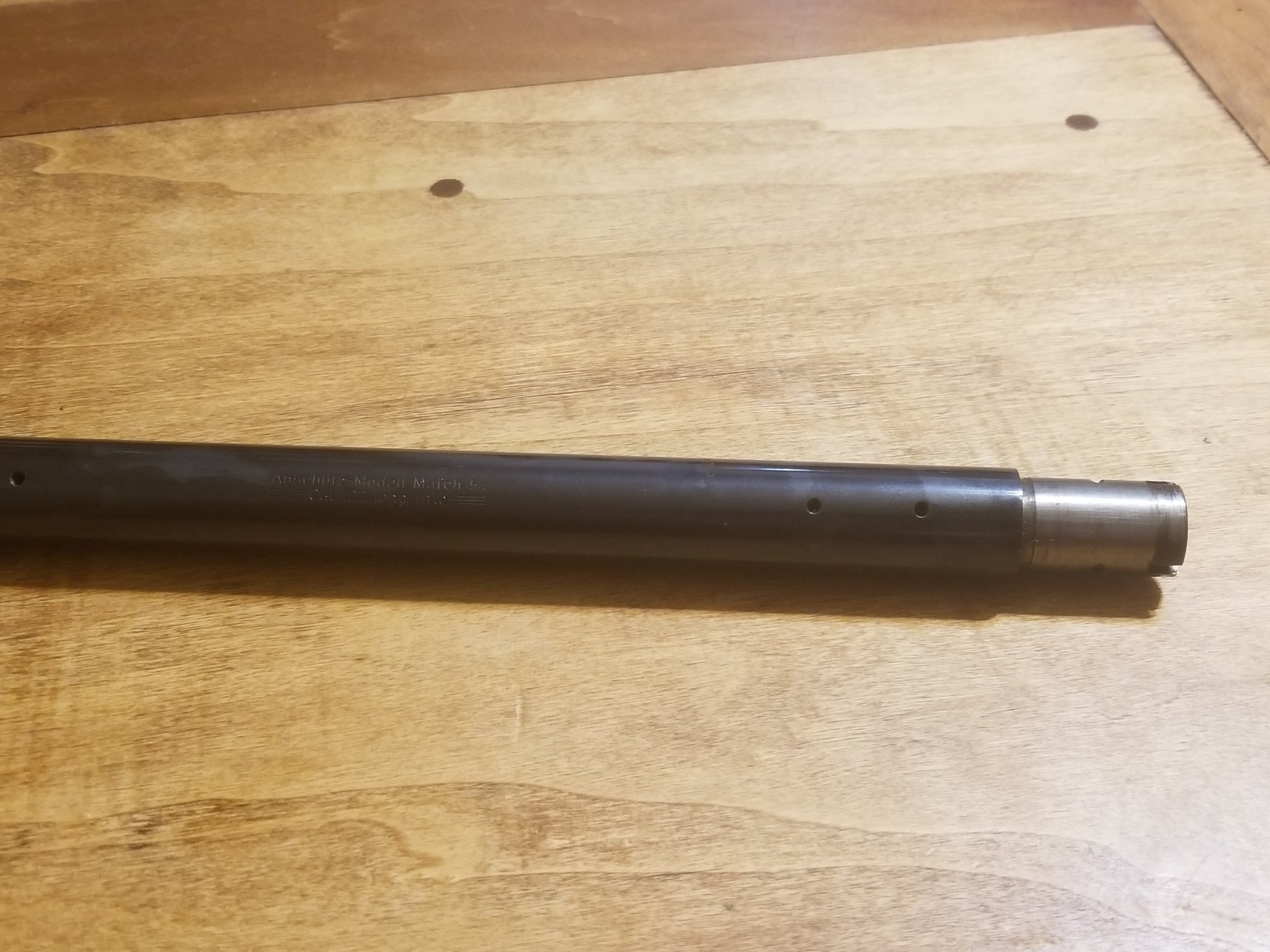

For what it was worth most (all maybe) of Matt Emmons medals were won with Lilja barrels not the factory barrels.
Reactions: rick137
