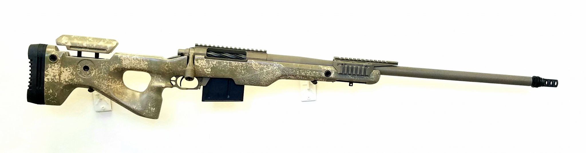

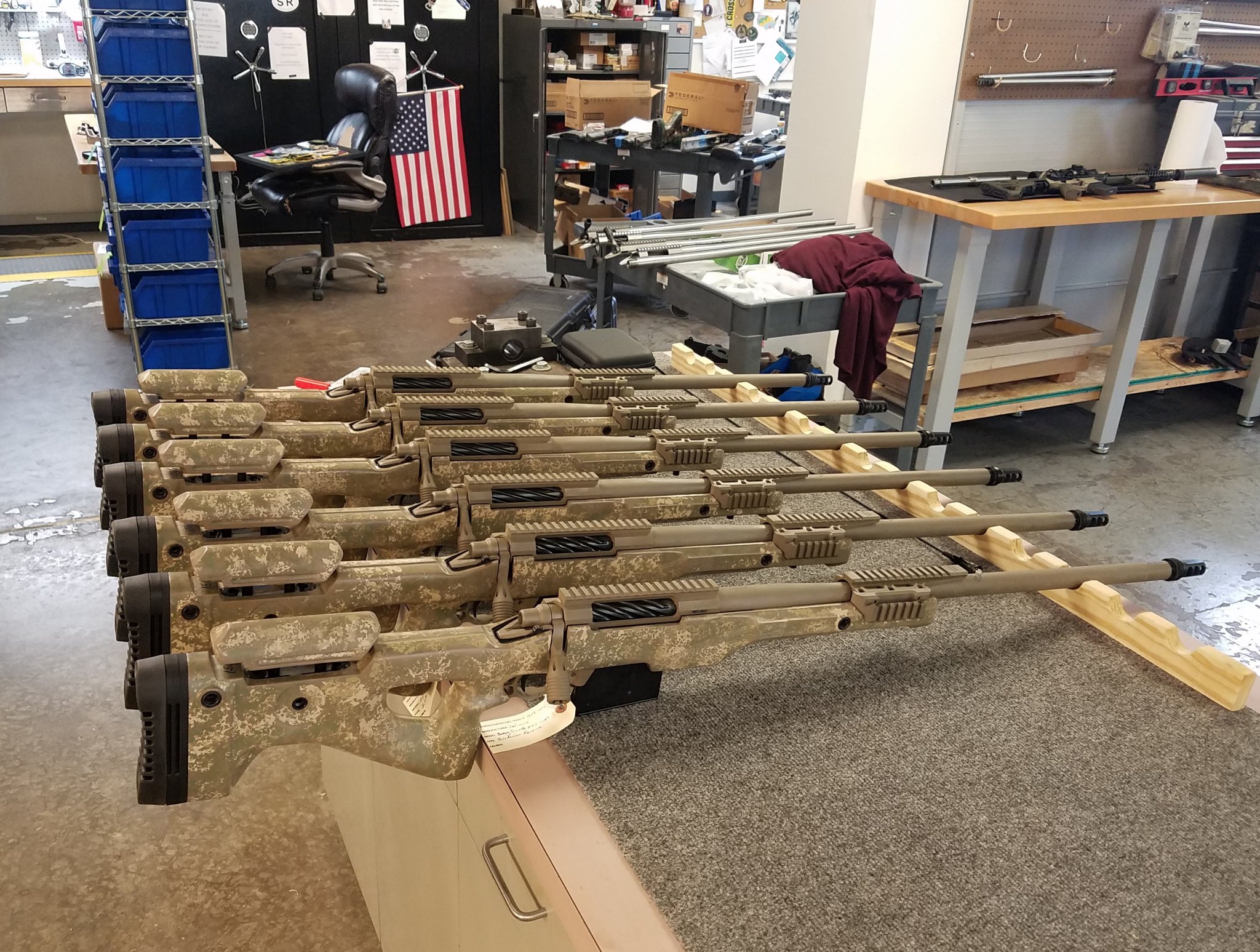

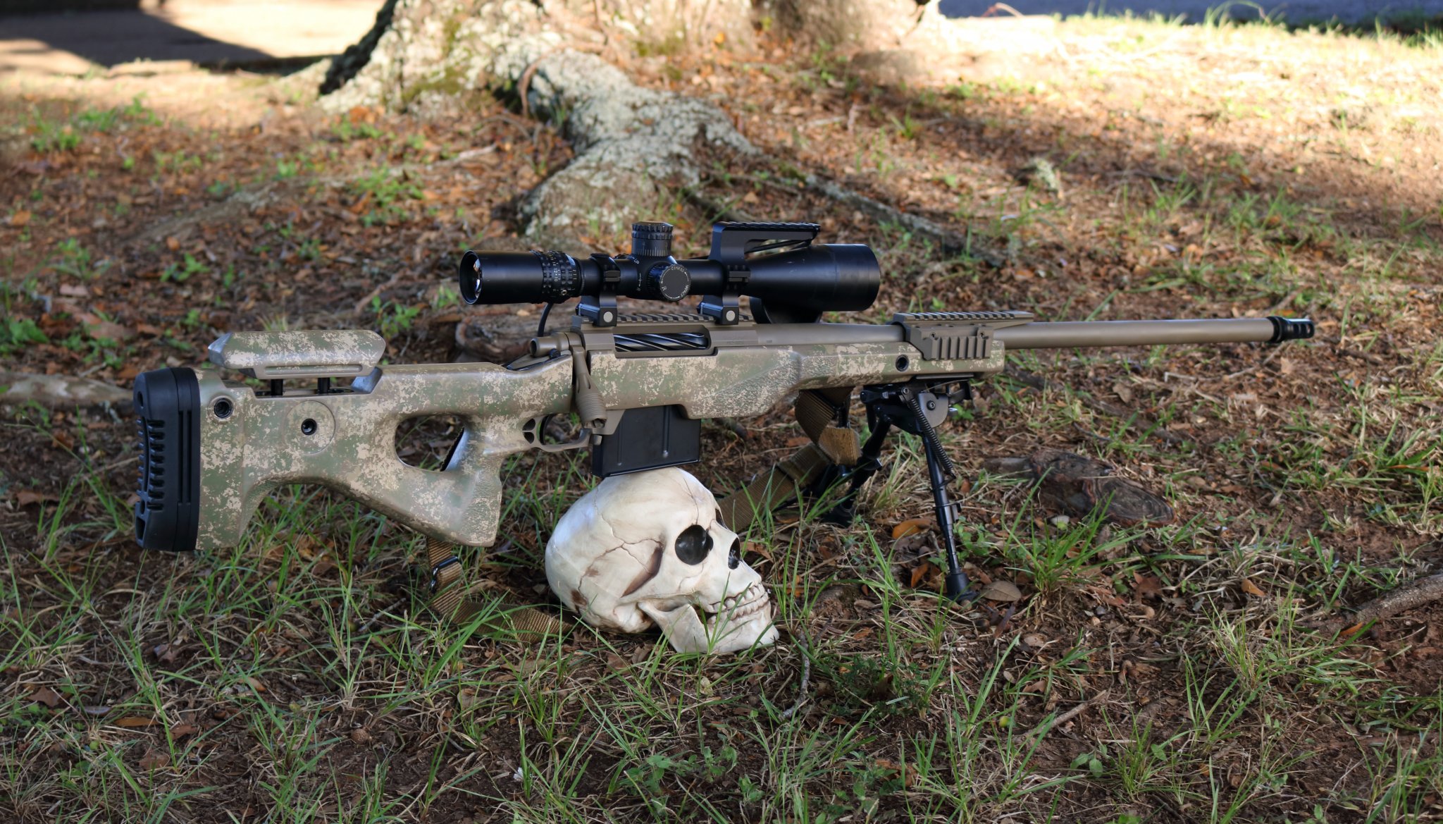

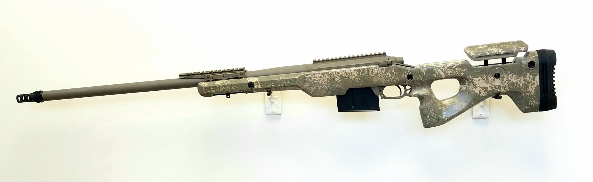

I don't usually make time to take pictures of most the work around here before it ships out. These were nice looking batch and also shot some of the best control groups of any I have fired so I snapped some images before packing them up to ship.
By the time I post this, these will be on a plane headed to the northwest part of the country to be put to work.
All are LongSwords in .338 LM.
All of these have the latest updates including the new KMW long action DBM hardware.
The agency taking possession will be running all of them suppressed.
The color renditions in the last 3 photos are off due to me being clueless about photography but this first pic is the most accurate color portrayal without glare, etc. This image on the table is after inspection and getting ready to take them to the range.
Side profile shots that I take for my customer file
One last image before packing.

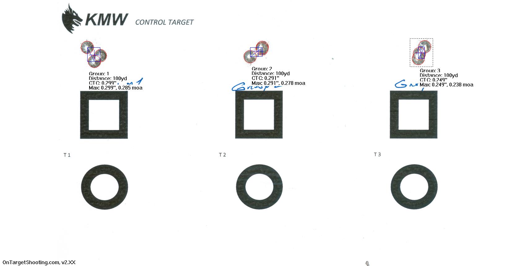

Each rifle built has to go through a short range session before it can ship. This makes sure all feeding, extraction, ejection and basic functions are double checked in addition to the need to pass a minimum accuracy threshold.
After mounting a scope and getting it on paper (usually 2 to 3 shots) every rifle has to fire 3 consecutive groups under 1/2 MOA on one target. I use factory ammo since most of my customers will not be using reloads.
I have a target that is printed on 100# index that is used for this. The fired target is then scanned and measured with OnTarget software then saved to the documentation file for that rifle. This insures that I have a healthy rifle and am not cherry picking groups.
This is an example of the targets used.
You will never see me post a single group from a rifle.
In my opinion, I could take an open sighted Winchester 94 and eventually shoot a sub 1/2 moa group.
On the flip side, I suck at shooting groups. I you gave me your personal BR gun that shoots in the 0.1"s , I would average in the 0.2"s.
My testing is done from a bench or prone while using a bipod with rear pinch bag. If my dumb white ass can get on the gun and shoot 3 back to back groups under 1/2 moa in this manner, I certainly know that the rifle is capable of even better.
A total of 18 groups were fired from the rifles shown. The agg. for all 18 groups was. 0.395" which is below my average agg for .338LMs .

...A total of 18 groups were fired from the rifles shown. The agg. for all 18 groups was. 0.395" which is below my average agg for .338LMs ...
