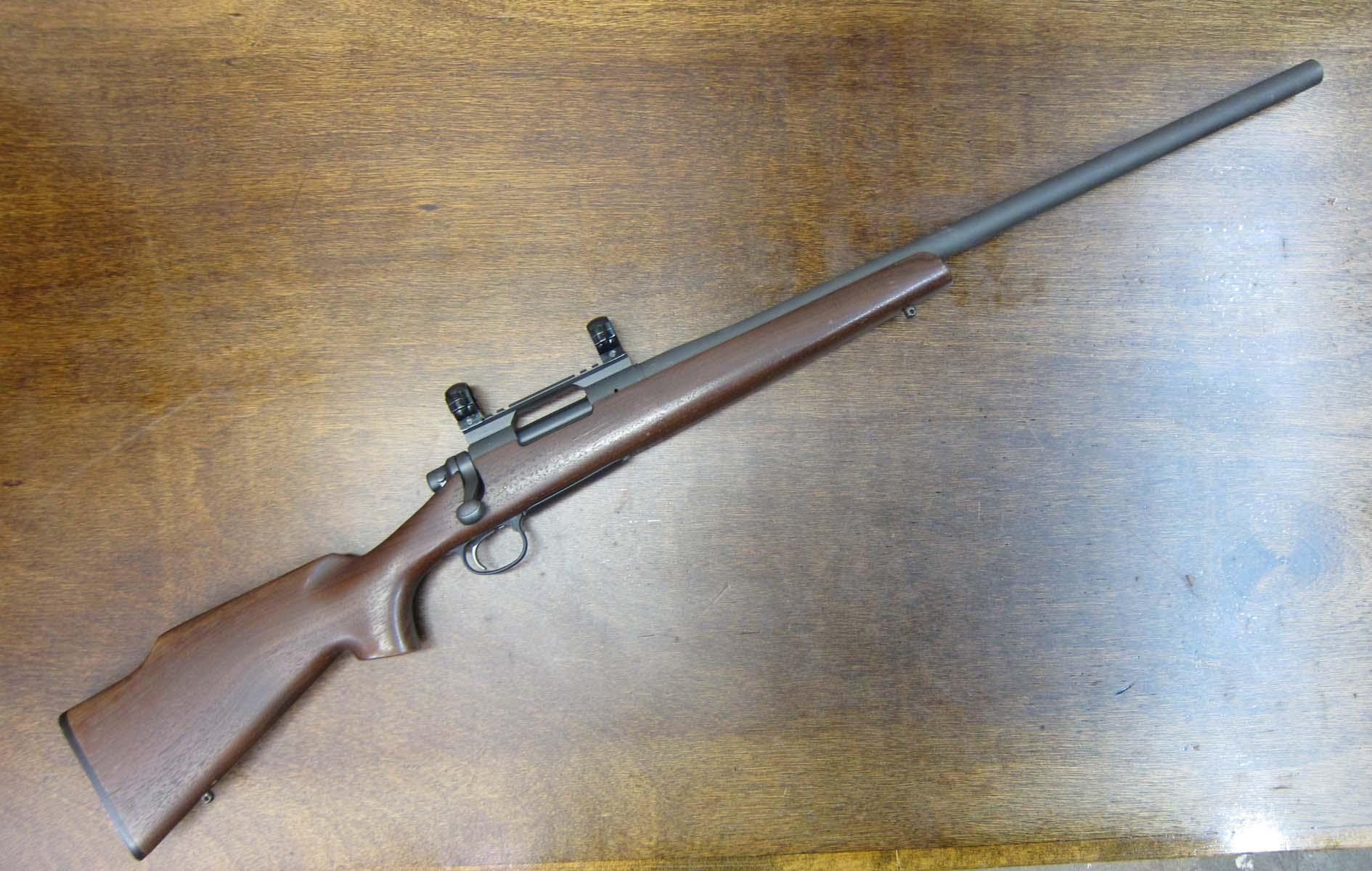

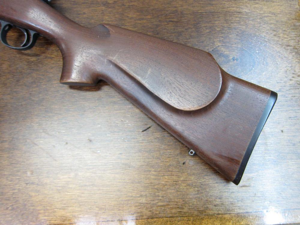

I've been thinking for sometime about the original mid 60's USMC M40. I know the originals are unobtanium and even the reproductions that Remington came out with a few years ago are quite expensive. But they sure are appealing.
What about starting out with a "look and feel" version based on something like this. It seems to have many of the features...matte finish, 24" heavy barrel, smooth wooden stock, BDL hinged floor plate.

Thats a Remington police.
Many of the repro stocks are that exact stock modified to M40 config.
You need to round the nose of the stock - the easy part.
Than you would fit a curved 16601 butt plate - the hard part.
I fit a curved butt plate back in December and its amazing how much wood you have to remove to do it.
That is a great start to a 40 build. Go for it!

I also say go for it if the price is good, unless you want to spend an extra $1k hunting down the old-school a BO M40 scope rail, having the receiver clip-slotted and re-finished and all that is involved. Profiling/rounding the forend and adding some old-school swivels and a green web sling would not cost too much $.

looks like you're on the right track! Besides the aluminum butplate and swivels, I would strip that finish and redo with BLO. The Leupold 1 piece short action bases have a square look to them, that would be a good add too. How far do you want to go down the rabbit hole is something you have to decide. I found my stock and butplate on Ebay. The swivels at Numrich gun parts... all were relatively inexpensive.

Personally, I'm a van of vintage Remingtons and that rifle has a lot of history and is unique in it's own way. Only thing I'd do is refinish the stock with BLO and maybe get a Redfield base and set of rings. Doesn't matter what kind of upgrades you do, it'll always be a 700.

My plan, If I can get the rifle for a reasonable price, would be pretty much what you all have suggested...
--refinish and reshape the stock to more closely match the M40 stock
--replace the scope mount with a Redfield Jr mount and correct rings
--find a 3-9 vintage Redfield scope
--swivels and sling.
Not sure of the cost of the Tomstone safety. Probably would not mill in a clip slot--fairly expensive I'd imagine and not very visible with the scope mounted.
What would you guys think a fair price for that Remington 700 would be, if it is in good shape bore-wise?
