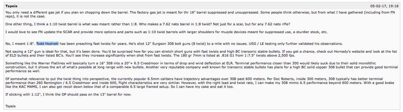

The main reason I am doing this is fun honestly, I read something that made me really scratch my head, problem is I can't find any more details or the original post at this point. The idea of a short .308 seems neat to me for some reason, I realize there are better ways.
Having said that, here's a screenshot of the post that got my noggin jogging, they are discuss the merits of the 13.5 SCAR 17. Plus the Mcmillan CS5 Alias is a neat concept of course it is a bolt action.
