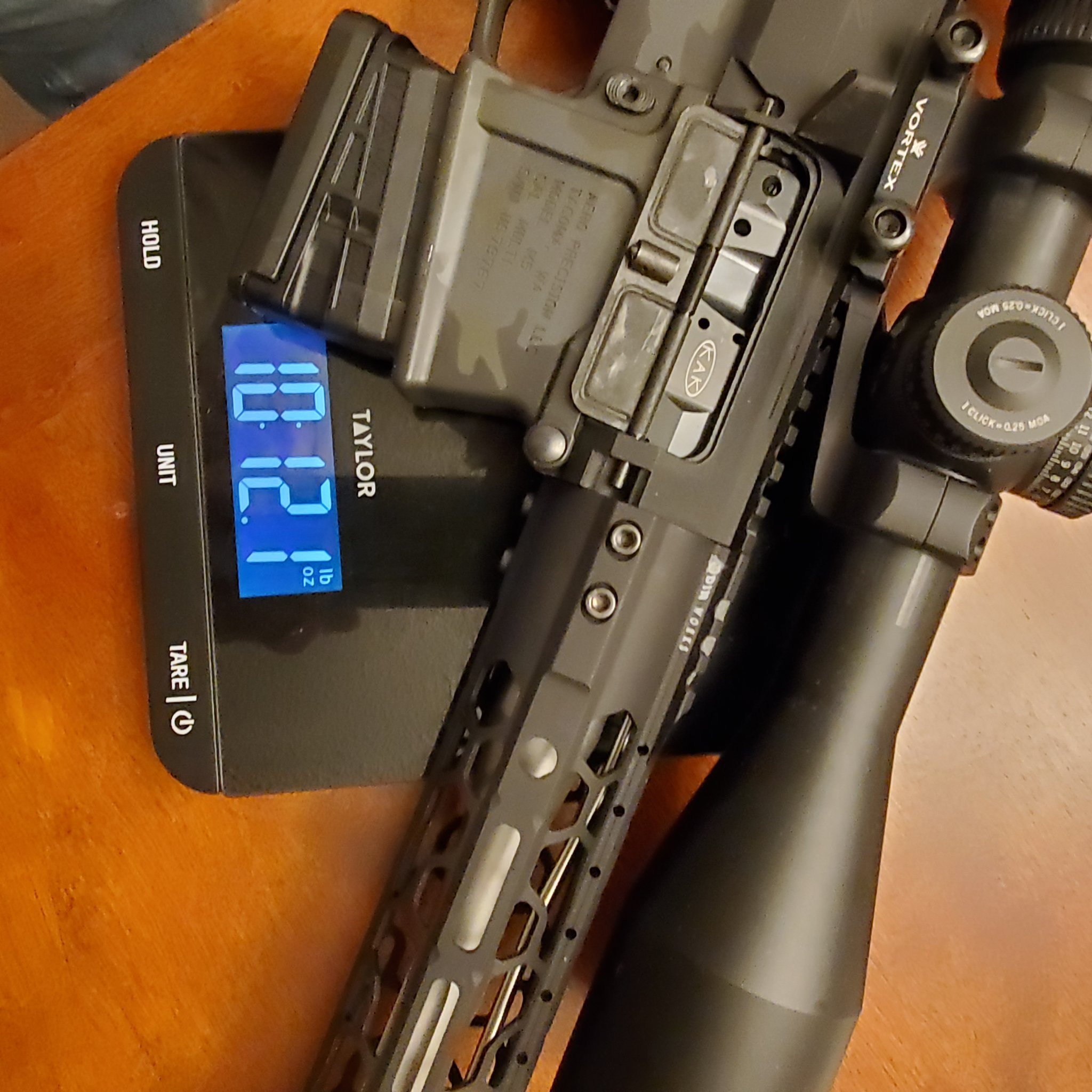

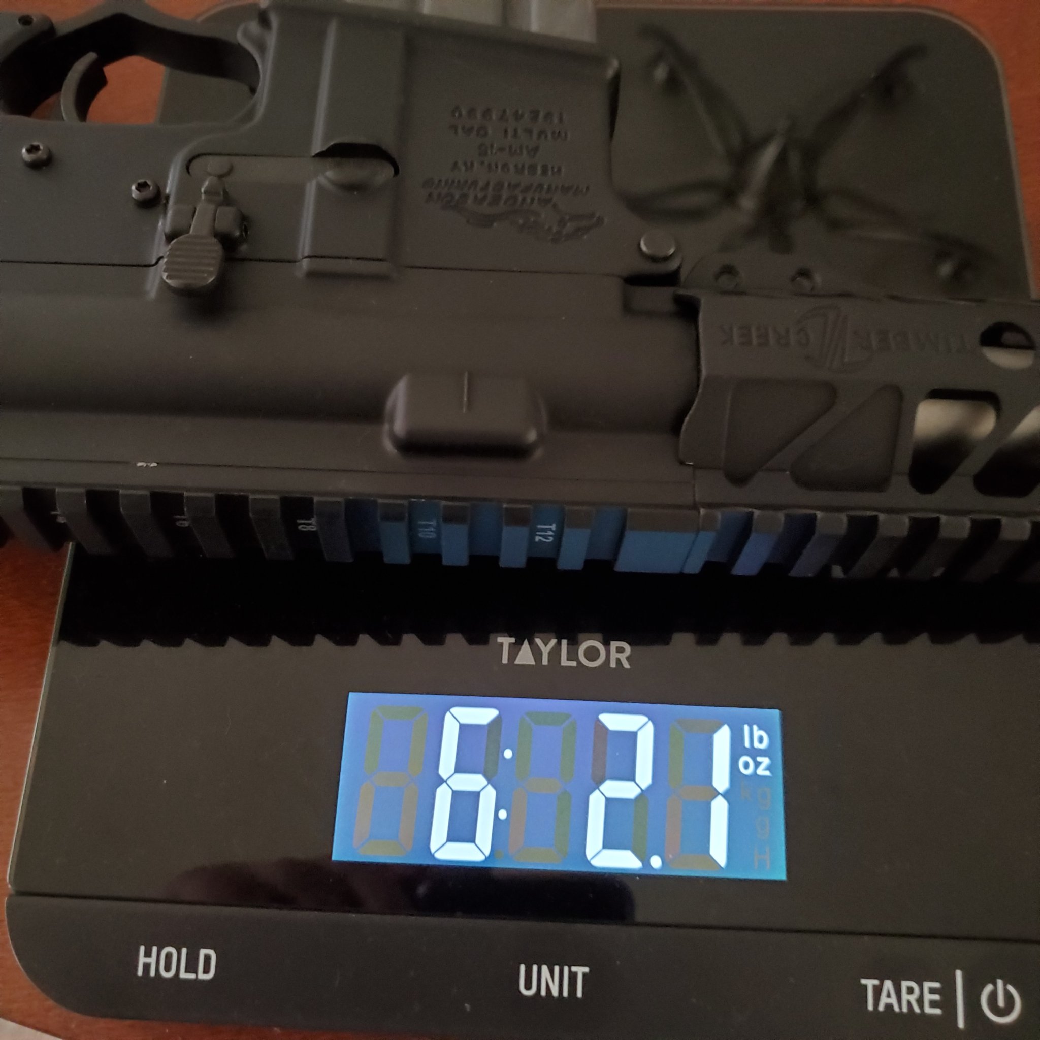

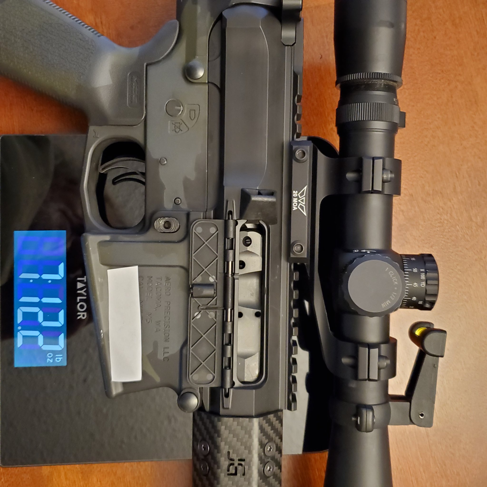

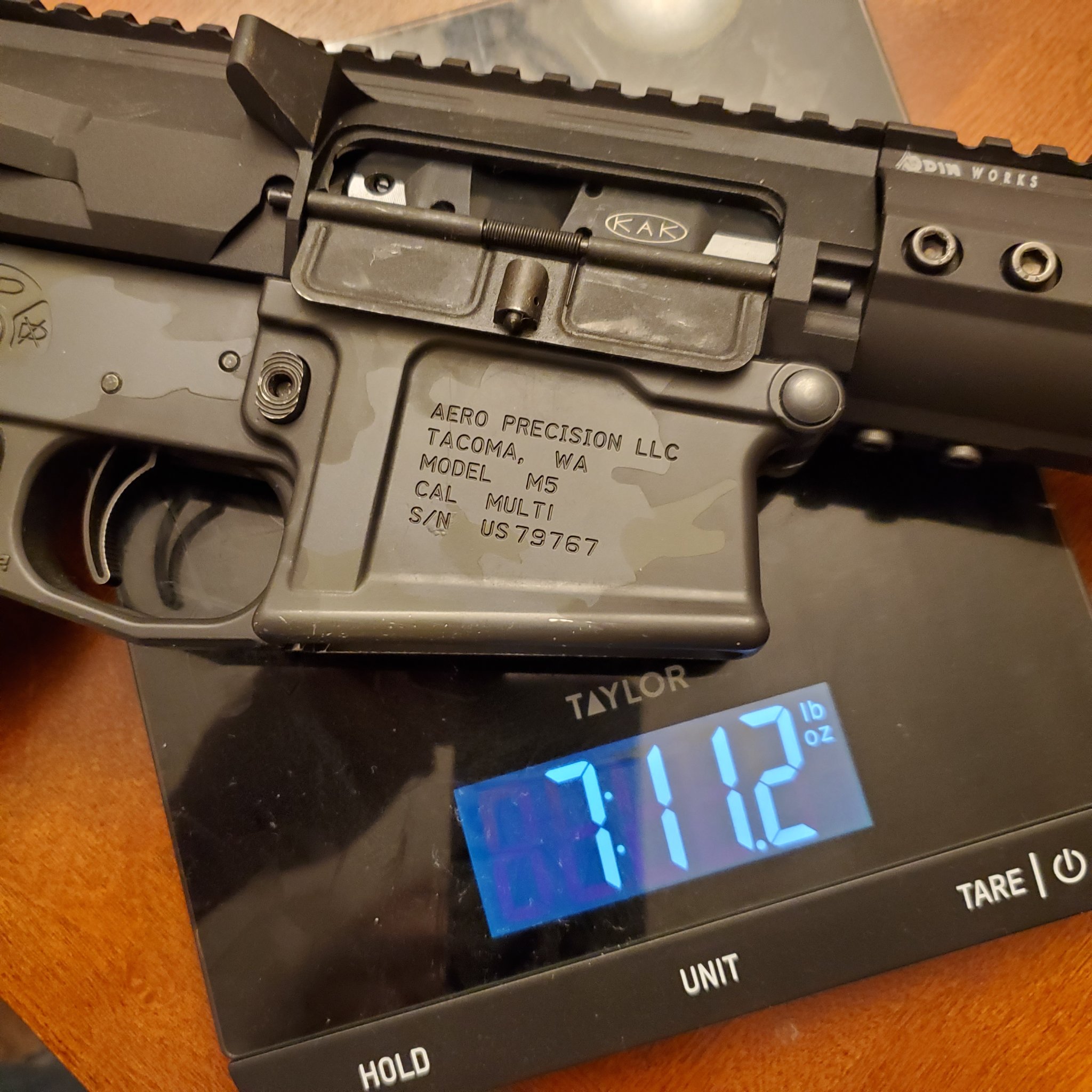

338 Fed, I went to the 338 RCM with a 18" light fluted barrel, so even with a big 25 power scope its 10 lb 12 oz. Or a 338 RCM AR 10, 7 lbs 11 oz , with whatever sights you want. The magnum rd with 18" barrel will do better than a 24" 338 Frderal plus take 250 gr GS hunting bullets to 2575 fps for heavy game. Capable of excellent accuracy and up to 3700 ft lbs of energy .
Or go completely ultra light with 6 lb AR 10, 16" fluted barrel, titanium bolt carrier, & muzzle brake, magnesium upper, carbon fiber handguard. But this will cost more for the light weight components, to get a 7 lb 12 oz AR 10 with Leupold Mark 4 M3
3-10X with calibrated turrent to 1200 yds, and bubble level. A delight to carry, and accurate.
So your weight goals can be absolutely met, with power and accuracy...some options just cost more, to get the weight down.
