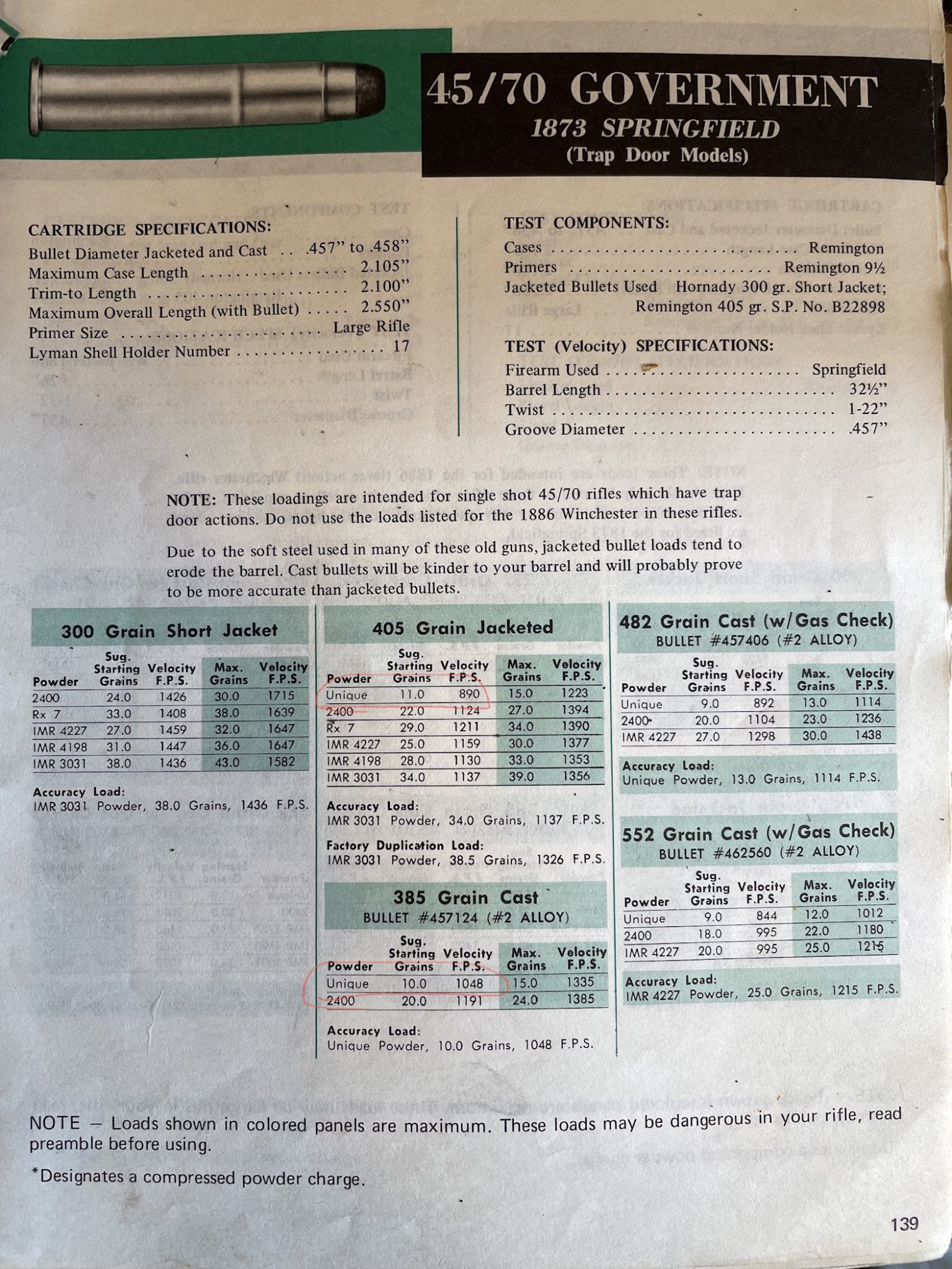

I can't help you too much. My 45-70 is a trapdoor so I search for loads with a very low CUP numbers, low teens if possible. I use a missouri bullet 405 and have had great luck with those.
My load is quite subsonic, and I found it over on loaddata.com. It is not that expensive and suggest taking a look at it, it is a great resource for old and outdated cartridges. Mine is a VV powder that gives me low 900fps numbers and a 13k CUP (IIRC).
Give that site a check out, I think you will find what you are looking for. IIRC it is like $30 for a year.

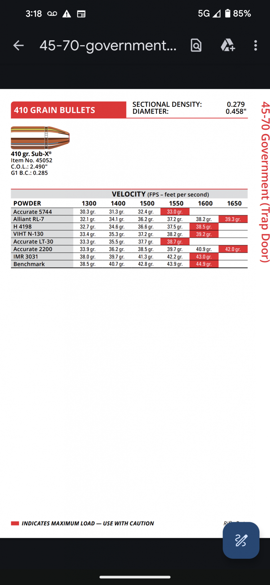

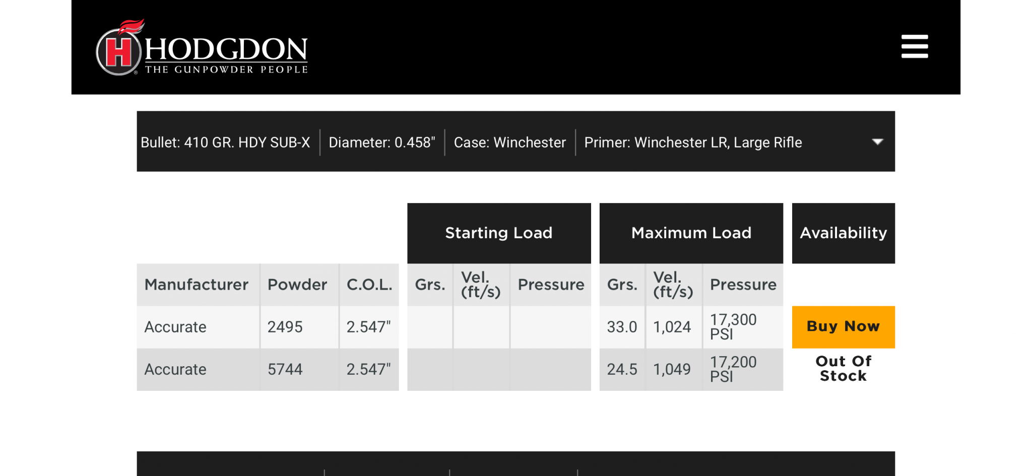

I’d run a heavier bullet. Not sure if Hornady will publish its load data for its SUBx bullet. I doubt it.

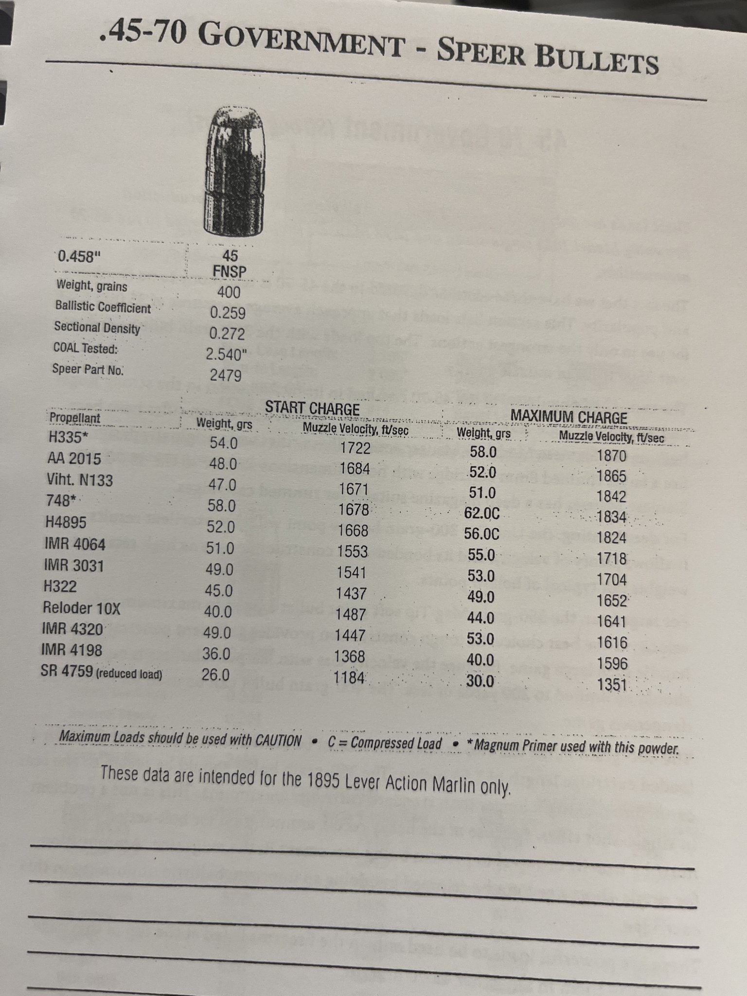

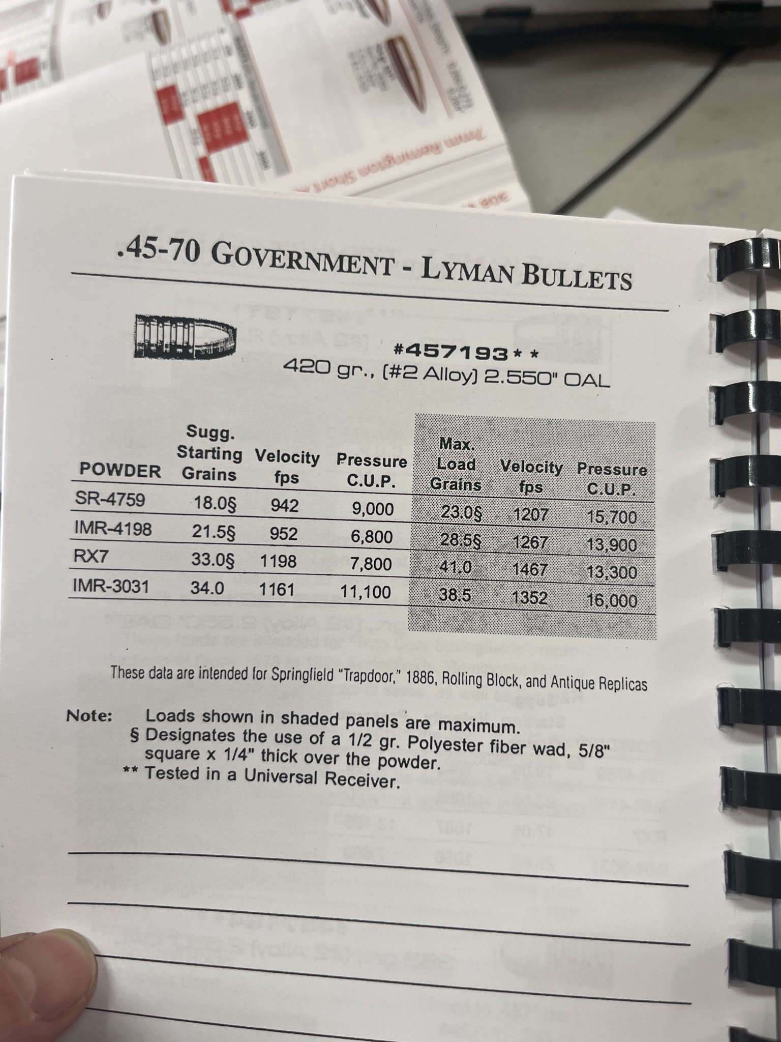

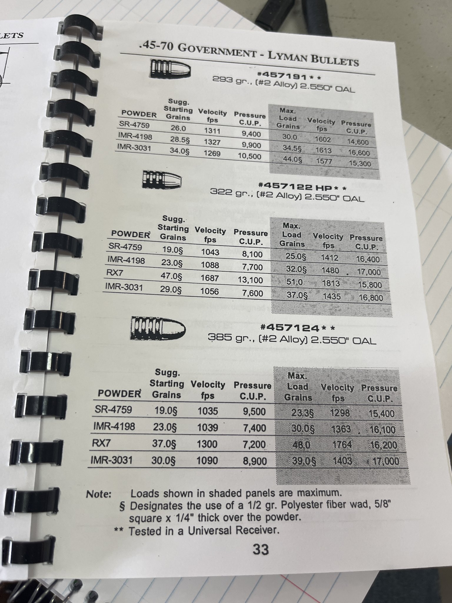

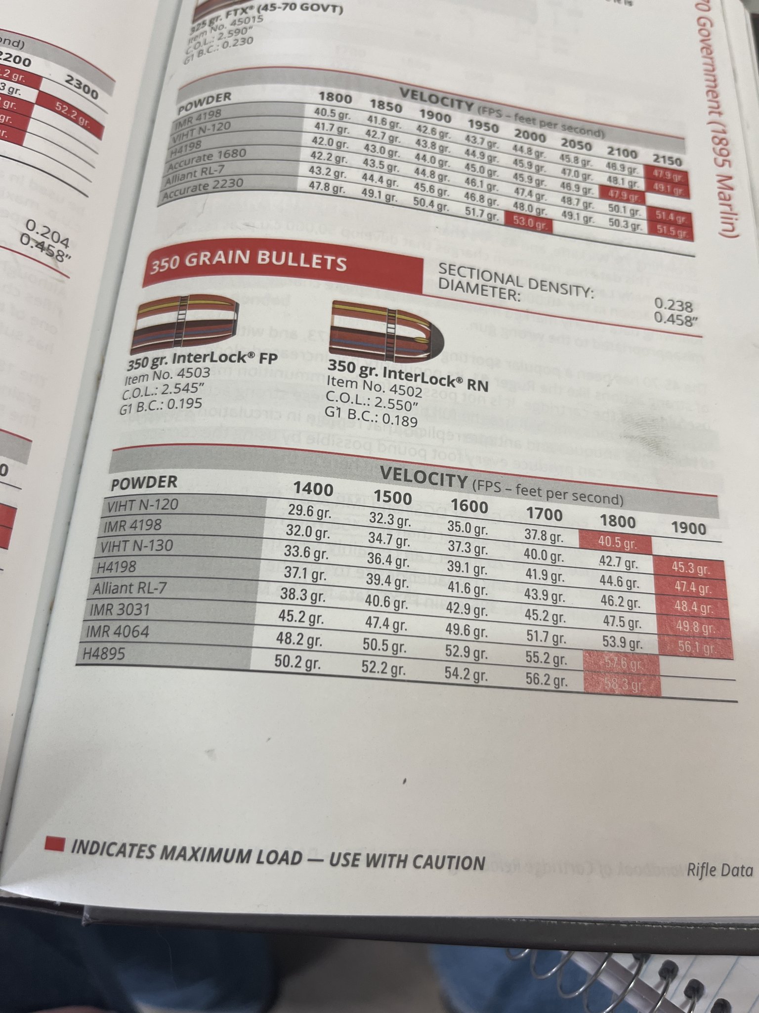

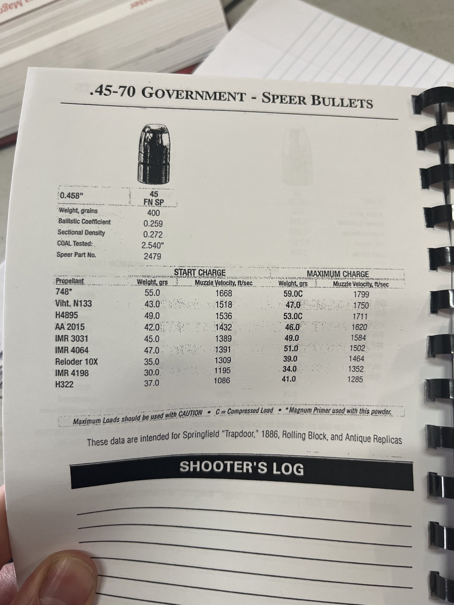

Agreed with above posts. Trailboss may be the easiest way. May not even have to go super heavy on the bullet. Wont know for sure until you chrono a few.
I have used unique and trail boss with success from a 16 inch barreled encore. You may have to be careful if your pressure ceiling is for a trapdoor.
Those guys have some helpful info for loading weird stuff lol.

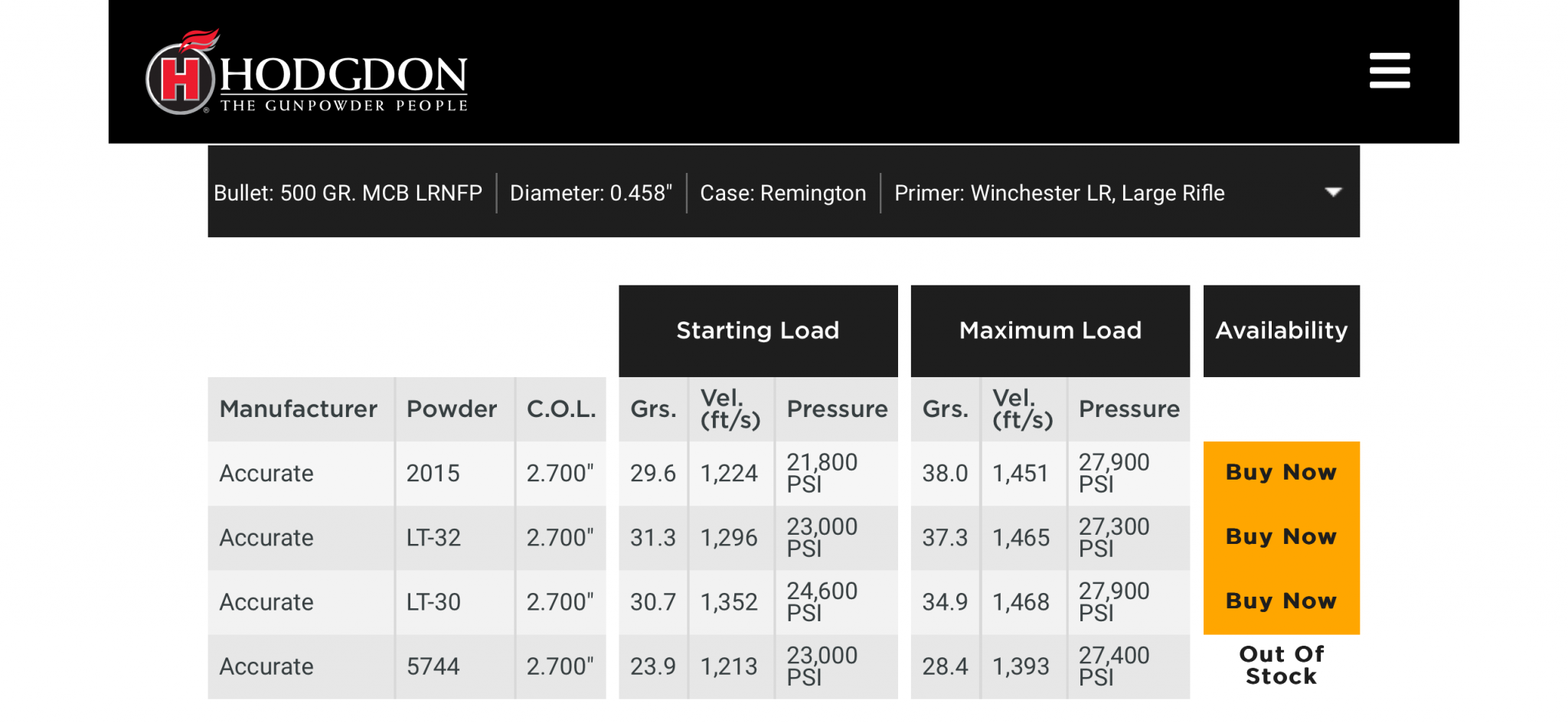

Can we go heavier on the bullet and take up case volume?
Proper powder selection and bullet weight are really the best avenue of attack here.

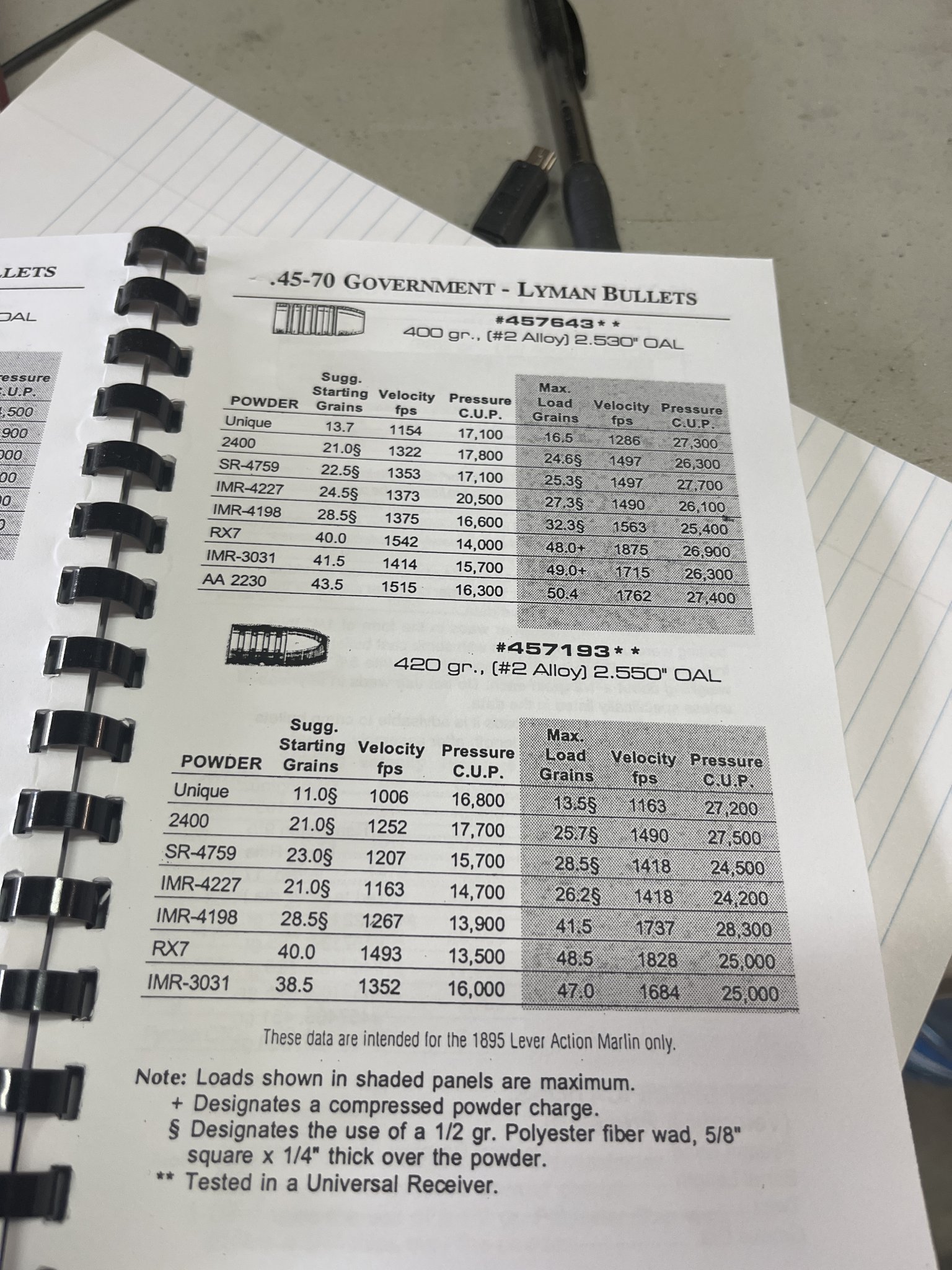

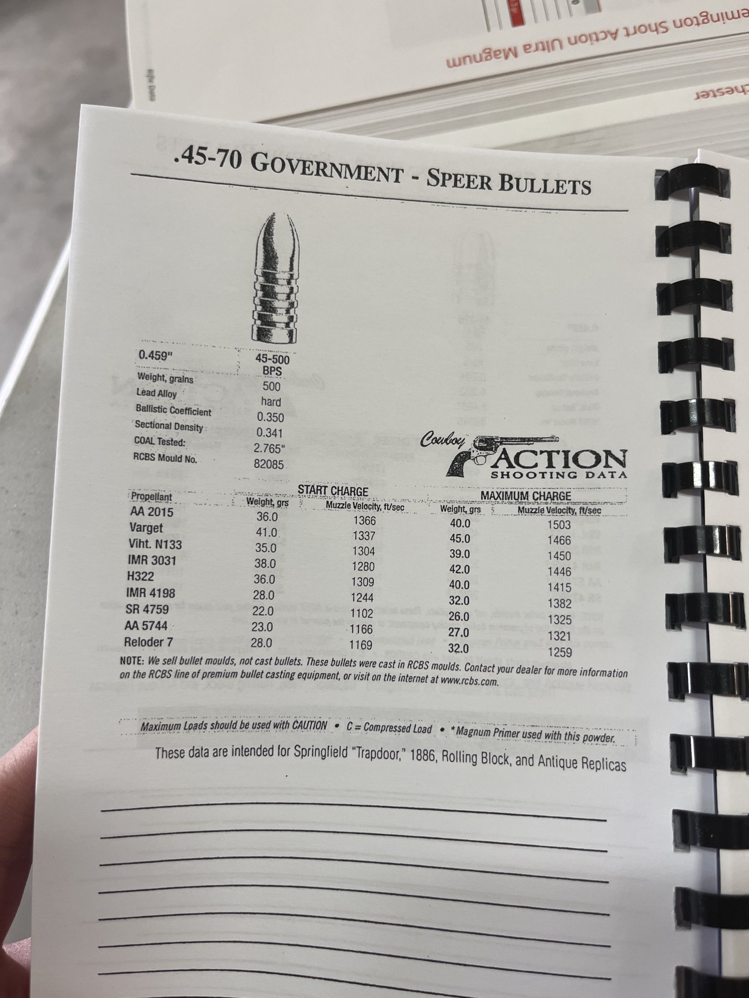

I've been shooting a Lyman 500 gr cast round nose with unique in my 45-70
It is a dirty powder
I've switch to 2400 and it burns much cleaner but roughly double the powder
I use the loads listed in Lymans #45 hand-load book the charges are posted in reply #10
Also I paper patch my boolits
