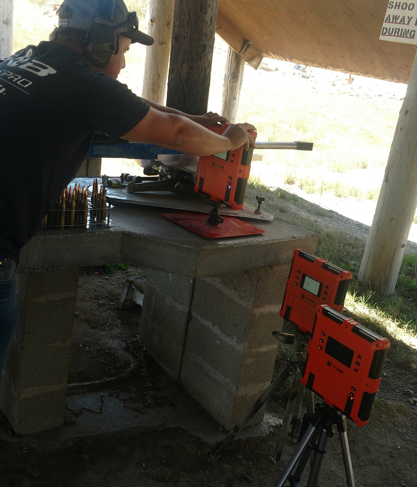

Here are three LabRadar units trying to capture shots from my Mach V. We captured about 40%.
I had a shooting chrony for about 15 year; it died a sudden death last year. Bit the bullet and got a lab radar. I love it, it’s so much better than messing with the shooting chrony. I have been able to capture far more than 40% of my shots, but I set it up much closer to the end of the barrel than the one in the picture above. One thing is for certain, it eats batteries and it’s best to run it off an external battery you would use to charge a cell phone. It has a cord for you to do that. Also, no worries with poi change nor group size with a lab radar.

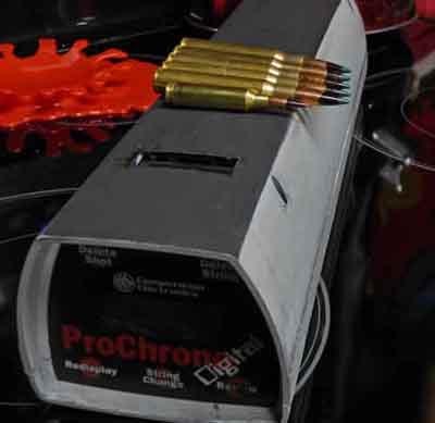

I set up my new ProChrono Digital on the last range trip. I quickly came to the conclusion that it cannot divide time fine enough to resolve speed in less than 5 fps increments. All 20 shots were either 2609, 2604, 2599, 2594, 2588, 2578 or 2574, nothing else. It's statistically improbable to get 7 shots each at 2599 & 2594 with nothing in between. It casts doubt on the calculated SD. So 5 fps in that range is 0.2%, still within it's stated accuracy, but...
I'm curious if users of other chronos have observed a similar phenomenon.
