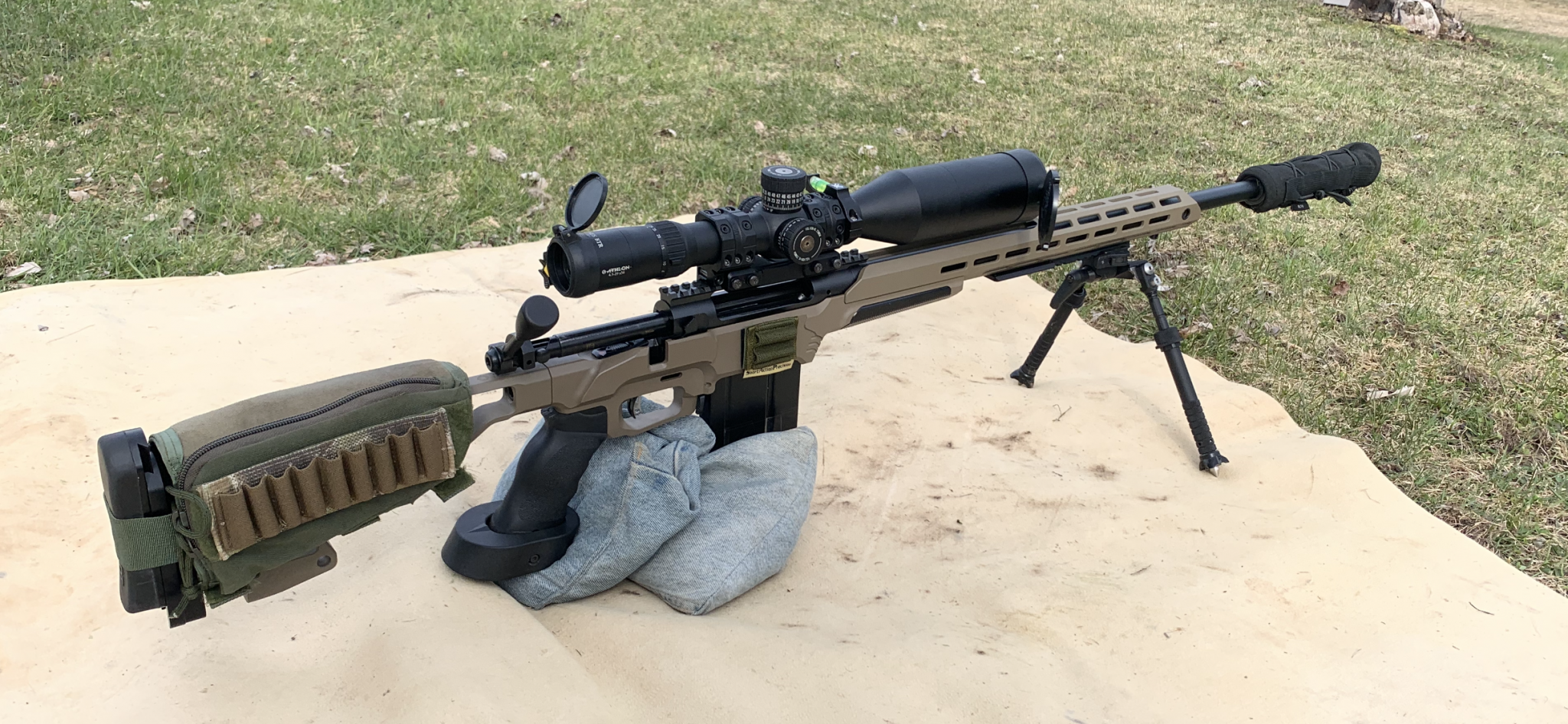

I have my short action savage sitting in a cadex chassis (they make long action versions too). Pricier than average, but it's really a nice piece of kit.
(the FDE one in the front)
