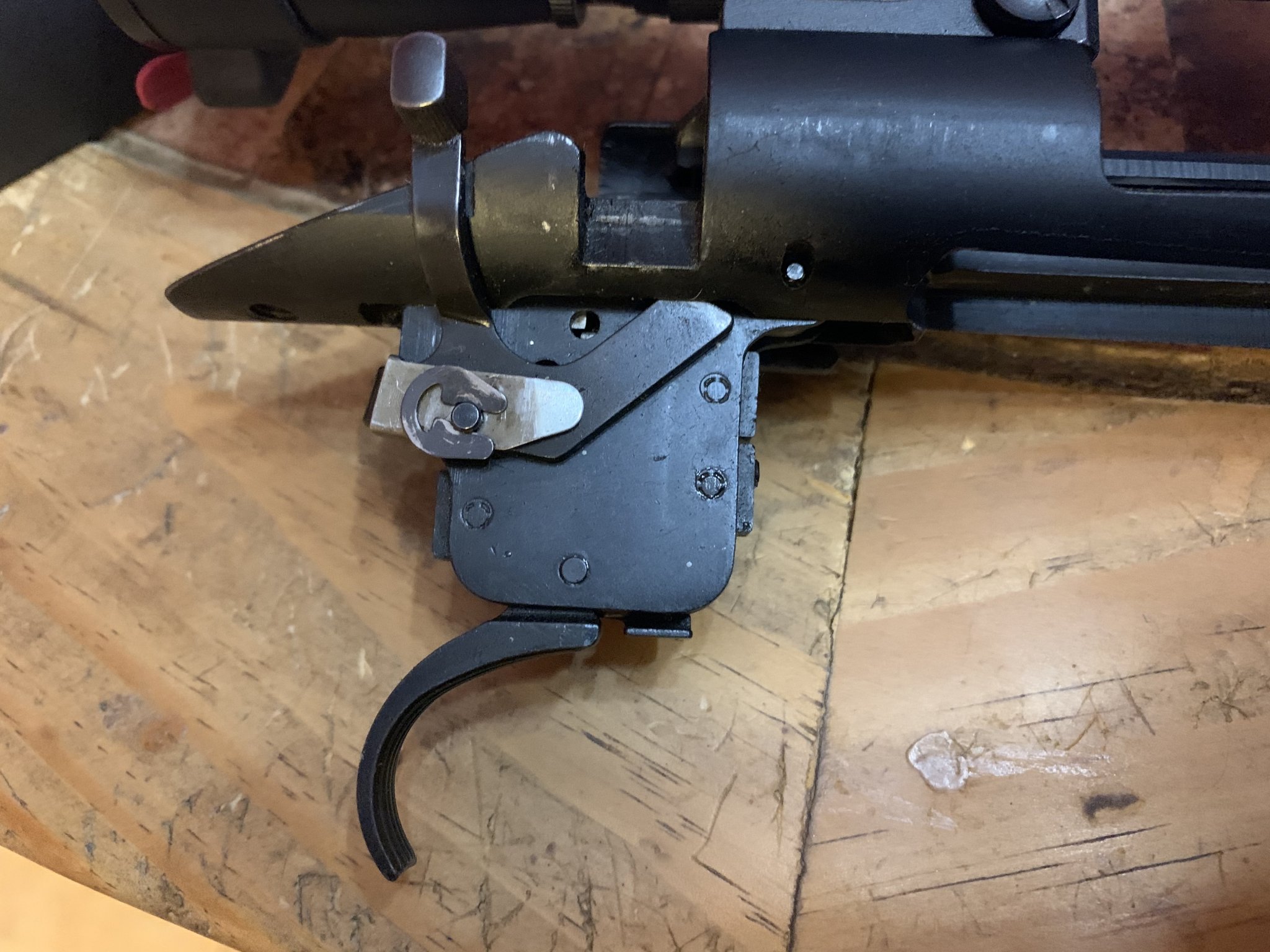

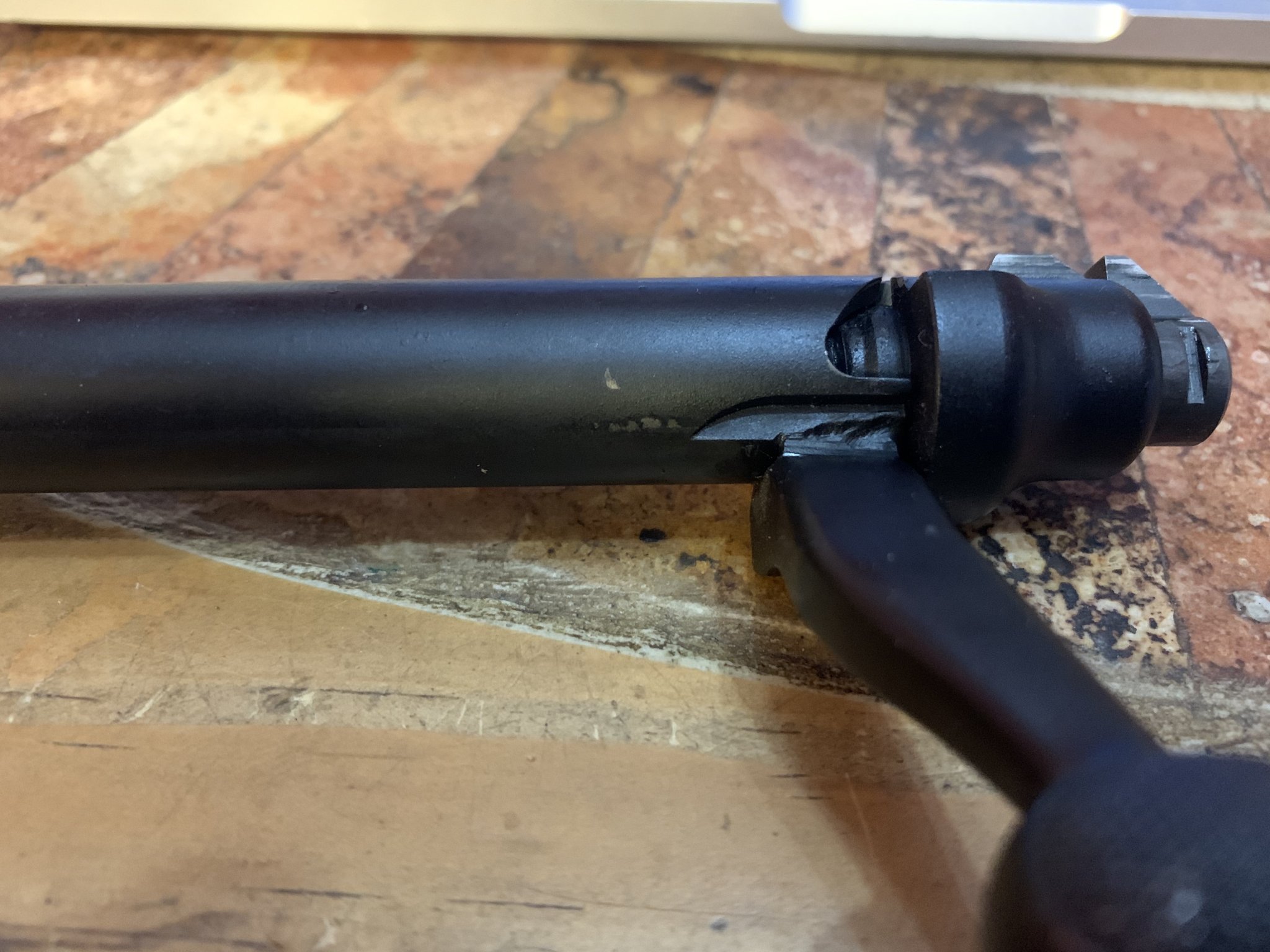

If your willing to drop the CRF then you can find the older 700's which have a bolt lock on them. Here is one on a 280AI that was built on a 6 digit action. I kind of liked the feature since it was built as a hunting gun so I never bothered to remove/replace it. It even still has the 2 piece thing on the top side of the trigger. ETA: There are probably M40's still around in use as old as this action so its definitely a rugged design.
