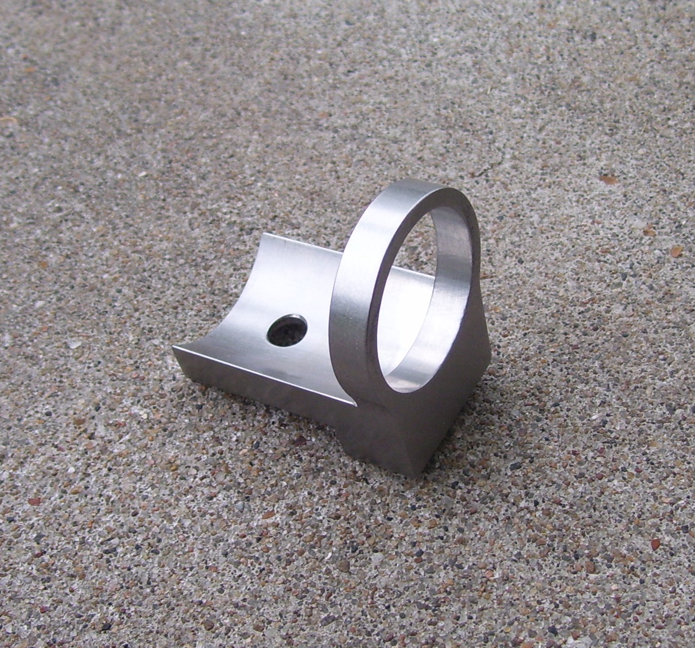

I just got a new "to me" McMillan stock that I'm getting ready to build on. I'm shopping recoil lugs, it will be on a blueprinted 700 action, NSS Criterion Remage 308 barrel, 20-22" length all in Chrome Moly.
I was looking through recoil lugs and have a question I hoped you guys that have built more rifles than I could maybe give some advice?
I'm trying to make this rifle as tough as possible. Something I'll be using quite a bit and getting bumped around in the woods. I always liked the idea of the MK13 style recoil lug. I found a company that makes one really similar, Crabtree is the company and this is the recoil lug:
Does this type of lug add strength significant enough to matter? Or am I just as well to use pillars, an oversize lug and glass bed? If I went with this lug I would still use a rear pillar and glass bed the action. Just curious, I want the rifle to be as tough as possible. A field rifle more so than a full on match rifle.
Thanks...

I've been on this site since around 2007. I've seen hundreds of recoil lugs that looked as though someone robbed a tombstone from a graveyard. What I've never seen is a photo of a lug that has failed or a rifle that has conclusively improved its performance after installing one. A 1/4" thick recoil lug the size of an M700 is more than adequate for 99.9% of the rifles owned and shot by people today.
Engineers do exist and a lot of them are very smart people. If your shoulder/body can manage the "thump" then I have to think that a slab of heat-treated steel can too.
EDIT:
Tikka has become a well-pursued product these days. The recoil management setup they have pails in comparison to most of the popular actions made here in the US. Has there ever been a post on a forum anywhere about one failing? I make a conversion lug for it only because I had a mob of people beating down my door asking for it. Well sell them but in truth all it does is complicate a very simple/elegant product.
Good deal, that seems to be the general consensus on them. Simplicity most likely wins out here. I appreciate all the replies. I was just kind luxurious about it.

A "solution" in search of a problem that doesn't exist for most applications.
I could see this (just as I could a cross-bolt) for an extremely heavy recoiling rifle, like a big-bore, big game rifle where it's beneficial to add some reinforcement beyond a typical lug setup.
