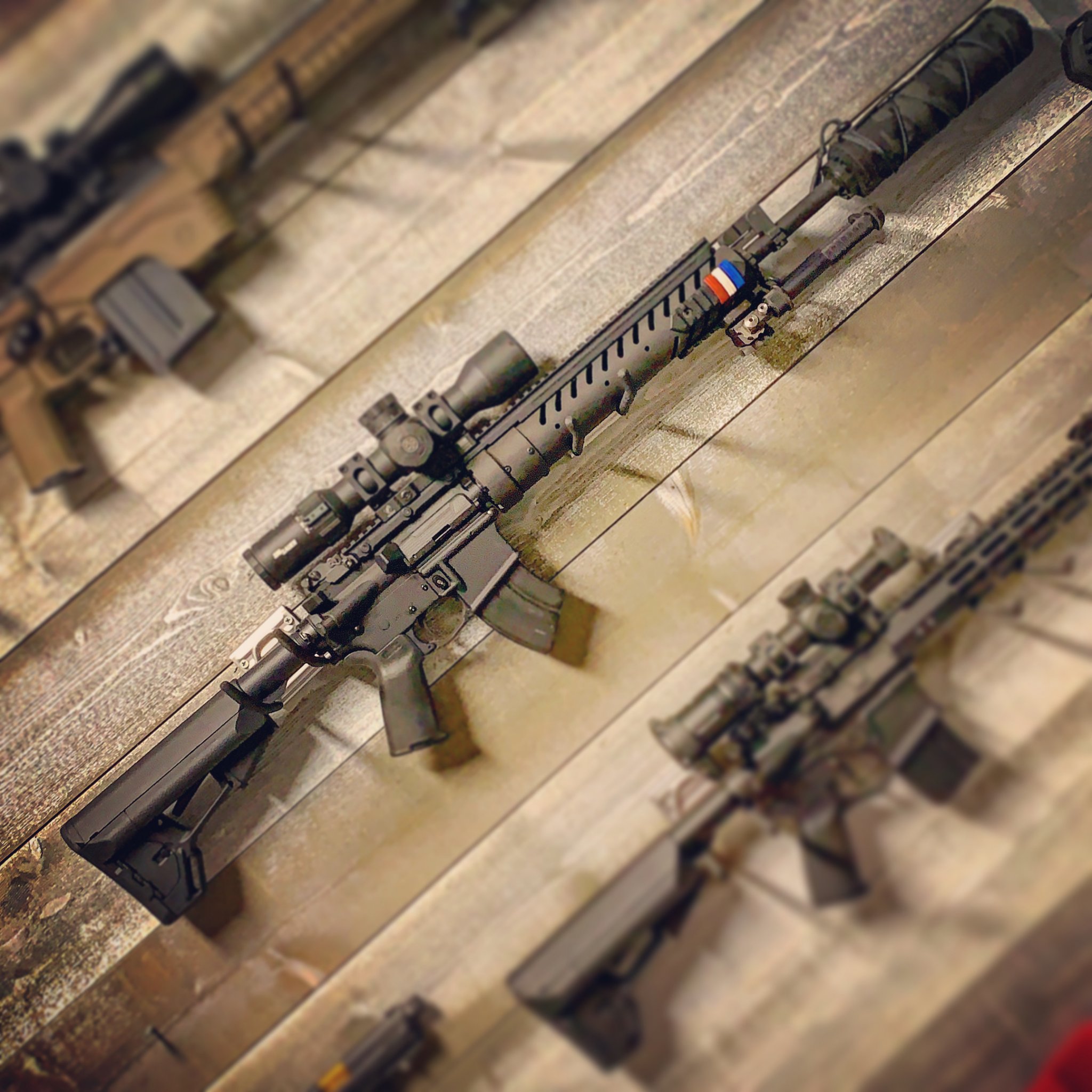

Come out great. Ended up selling it to fund some other projects but I’d build again vs buying. For me I like tracking down the parts and building it out.
Which parts did you end up with? Currently looking at using SOLGW lower and upper, PRI most everything else and bartlein barrel, but the barrel alone is like $750...
i shopped around for PRI parts and scavenged stuff off the px in the hide here. Check optics planet for PRI parts because they will have sales frequently. Barrel, upper and lower I used what I had sitting around. Lpk was a BCM kit and I dropped in an ssa-e trigger. Stock I got a sopmod off the px
I didn’t care about ours being correct and figured I’d make the clone heads lose sleep so I built a Valkyrie on a mega receiver with an ASR mounted can. I love it and wouldn’t change a thing but I’ll always choose build over buy. The handguard and top rail are what really give it the look so that’s all I needed to scratch the itch. Plus commenting gave me an excuse to post the pic.
Edit- aaaand just realized it’s a zombie thread. But the pic is still going here! 👇🏻
