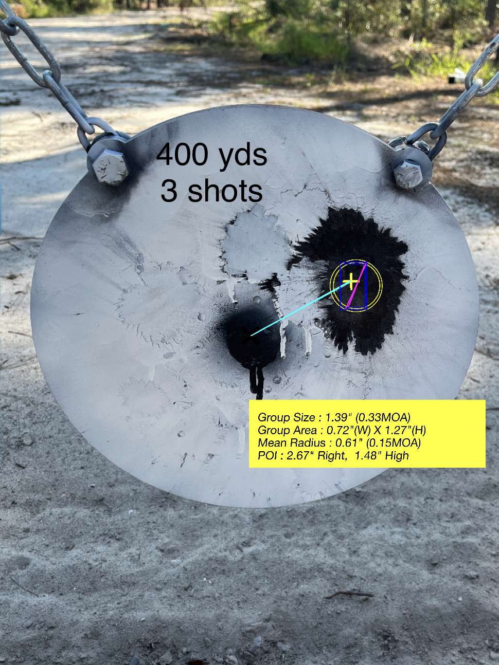

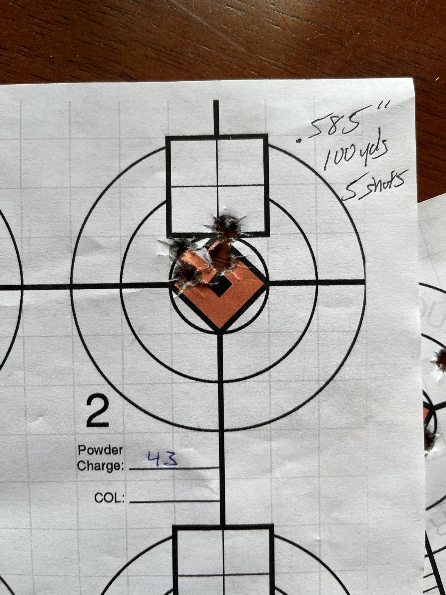

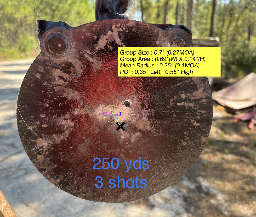

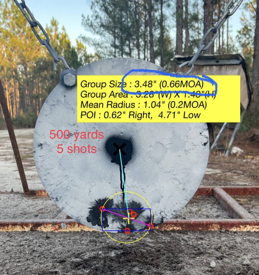

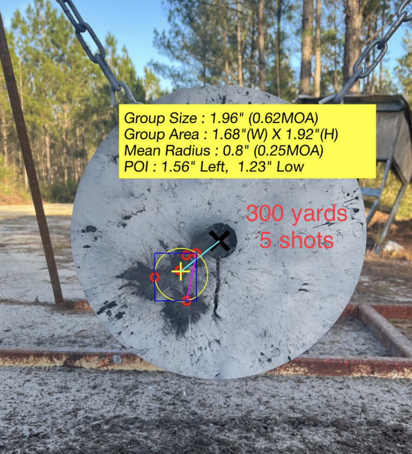

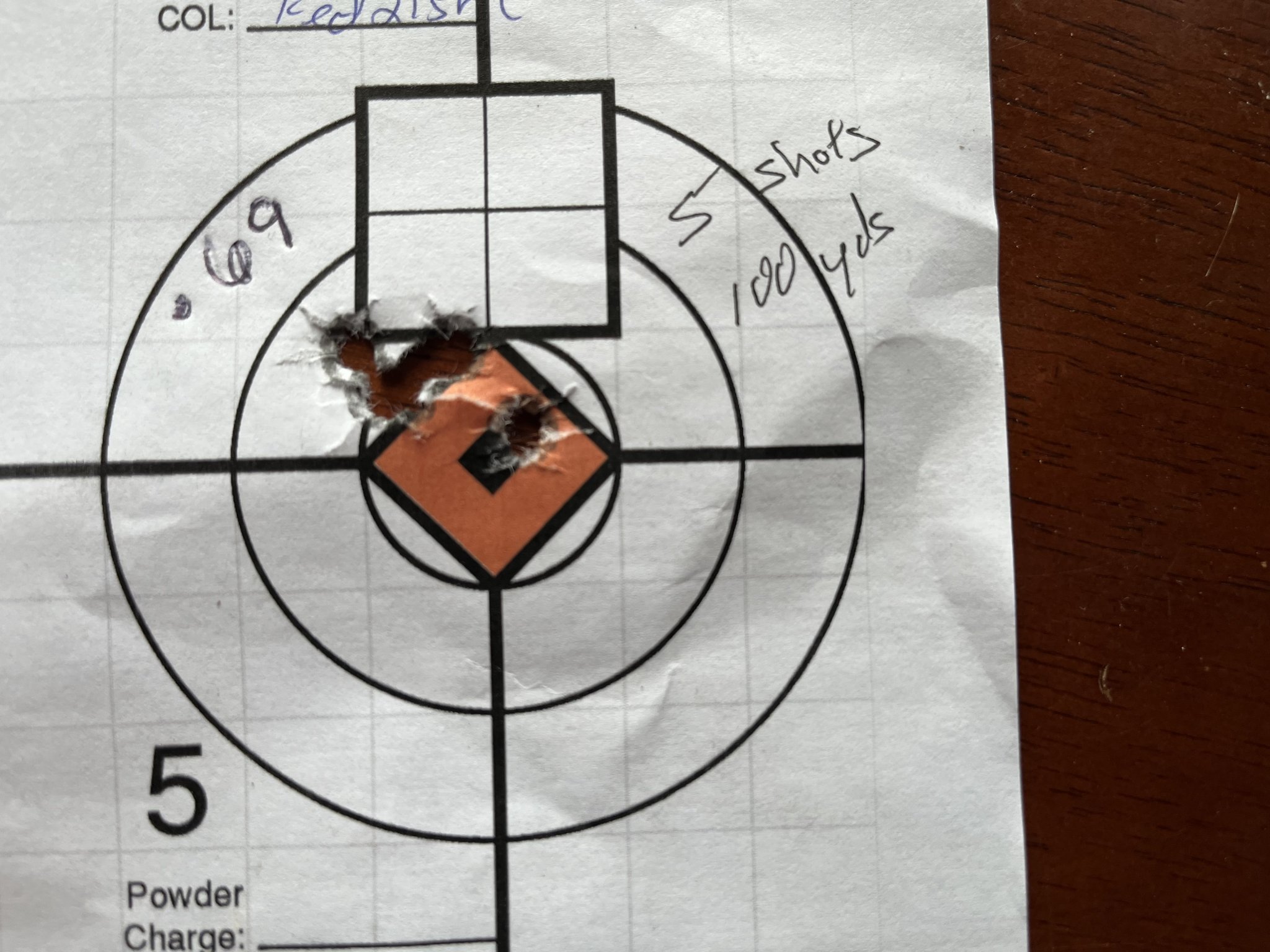

No opinion on the JP, never owned one. But had a RA Ultramatch 20” 308 AR barrel. It was a little picky but loved federal gold medal 168’s and two handload I had with 168 Eldm’s and 125 NBT. So don’t think it will not shoot light bullets. All three of those were roughly .75-.9 moa Avg 5 shot loads to 500 yards. Many groups in the .6’s few in the .5’s and few in the 1.25 moa range. Not a bad barrel and light with the deep fluting.
The 3 shot groups are the 125 NBT’s over Varget running 3000 fps at the muzzle. So mine would shoot light bullets with the 1-10 twist.
