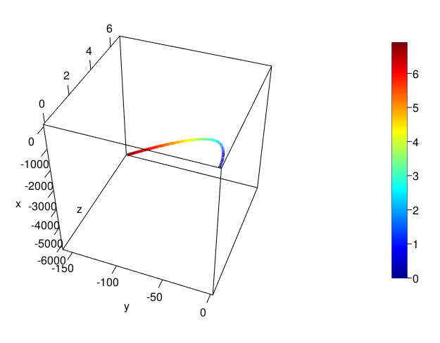

However, since you state that you want to plot the the path in 3D, why not use ballistic solvers that are already out there and use steps small steps for the output? This will generate plenty of data, in which you could plot the drop and horizontal movement as function of tof (Time of Flight).
Here is a plot of a 30 cal 168 BTHP using Hornady 4DOF plotted with drop (X) and horizontal movement (Y) ( spin drift, no wind) over time (Z) (distance of 2500 yards), drop is calculated in inches for every yard. ( Really rough plot from R)
