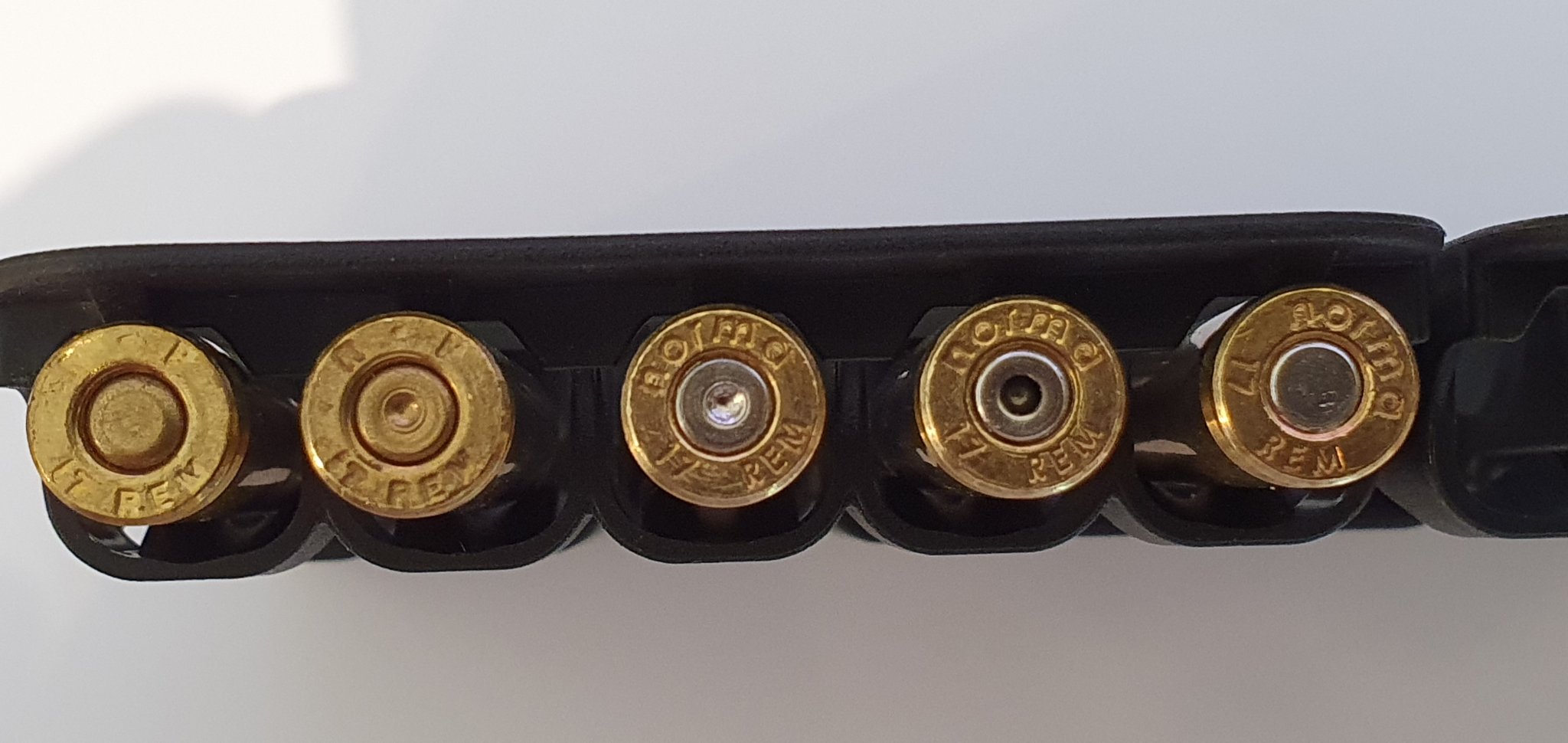

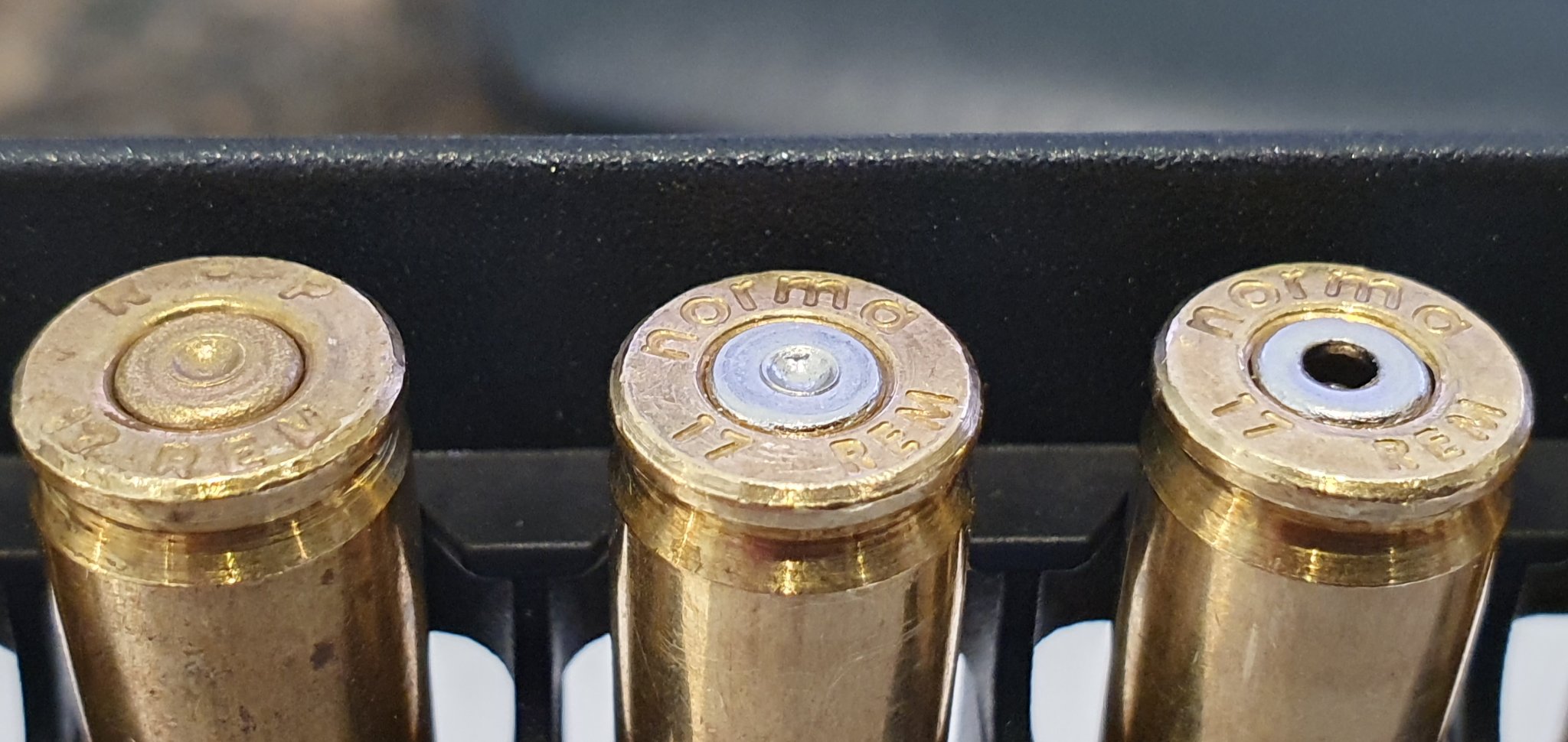

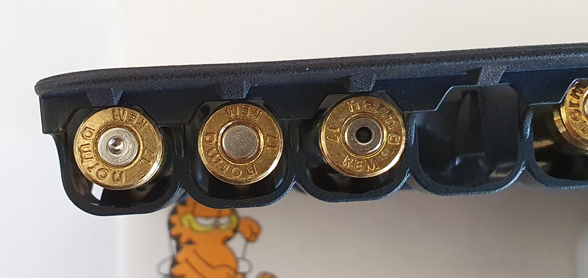

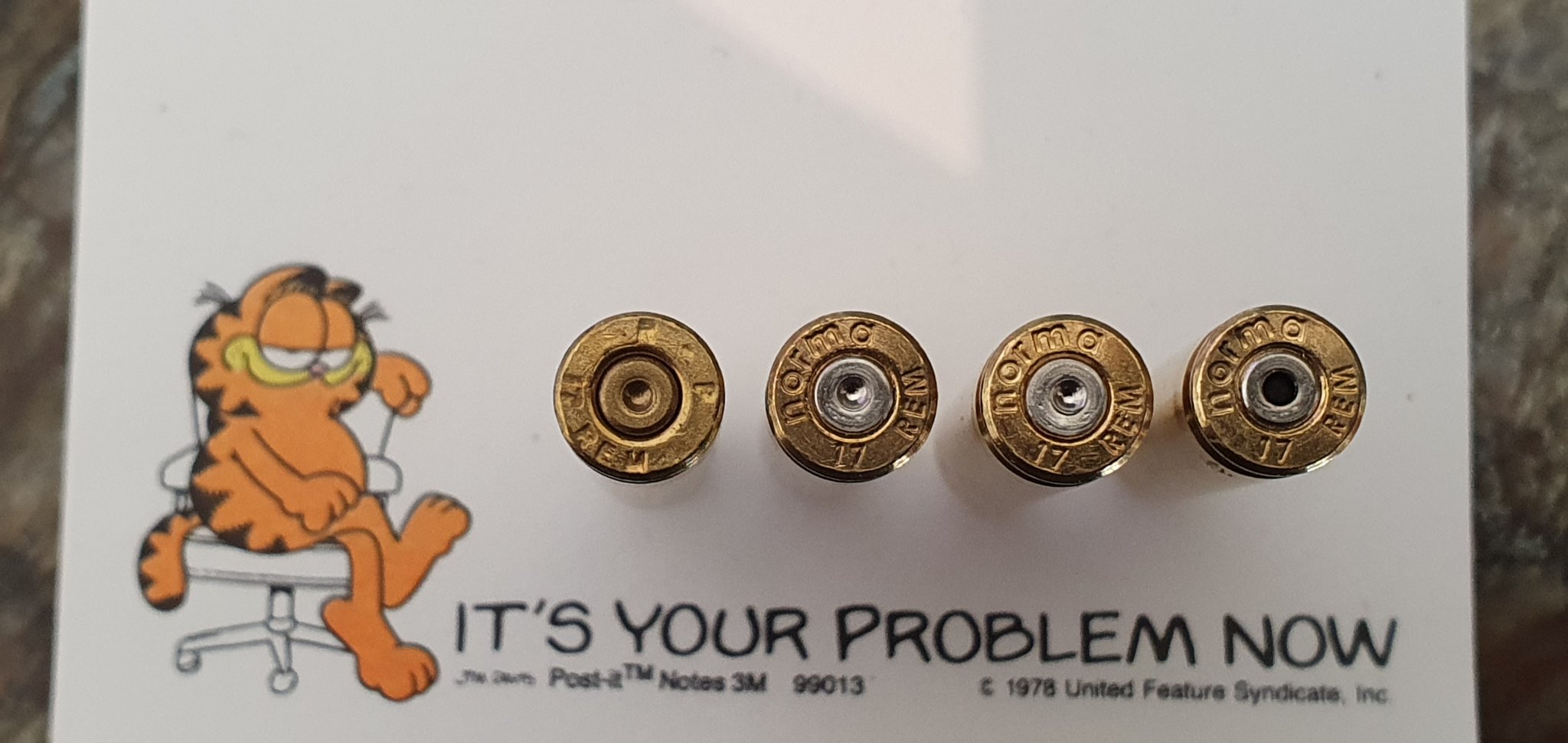

I managed to open the bolt with the gun still mounted and looked at the ejected cartridge. Far right in the photo.
Looking down the neck, I can see light behind the tricorne anvil.
The photo shows a Remington case, two Norma cases and the Norma case with pierced primer. All factory ammo fired that day.

At first I thought over pressure when I looked at the primer and then looked at a live round.
If you look at this photo, you can see that based on the primer post firing, over pressure is not an obvious reason. That's not to say it didn't occur though :)
If you look at this photo, you can see that based on the primer post firing, over pressure is not an obvious reason. That's not to say it didn't occur though :) View attachment 7328642
The over pressure spike in your case was extremely short duration because pressure went in two directions. That's why the primer looks normal other than the hole in it.
If it hadn't pierced, it would have been forced to contain the pressure and would have flattened because of it.

It looks a bit like the Norma /PMC Brass primers are flattened a bit and the dent in the primer is smaller than in the remington ammo.
It could be the Norma is hotter or the case was sized smaller to ensure it fit in more chambers... similar to bumping the shoulder too much

Photos shows the one 'pierced' primer I had along with another Norma and a Remington fired case together with live ones of each
It's not clear in the photo but in 'pierced' primer, the material from the the 'piercing' is actually inside the primer.
In the non 'pierced'
Norma primer, again not clear in the photos, but material has flowed around the edge of the firing pin. Only about 0.001
There's no obvious signs of over pressure.
I then put 10 further rounds of the Remington .17 Rem through. No problems.
So, my conclusion is that Norma's primer material is soft or thin or both.
