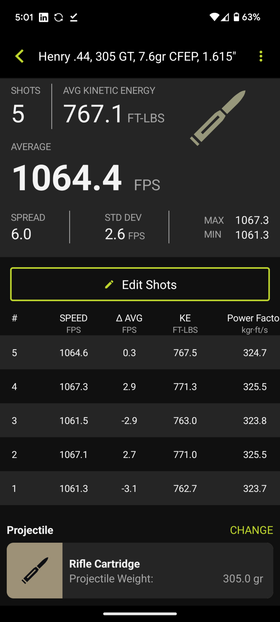

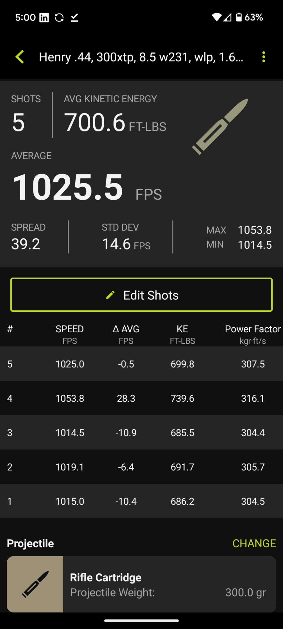

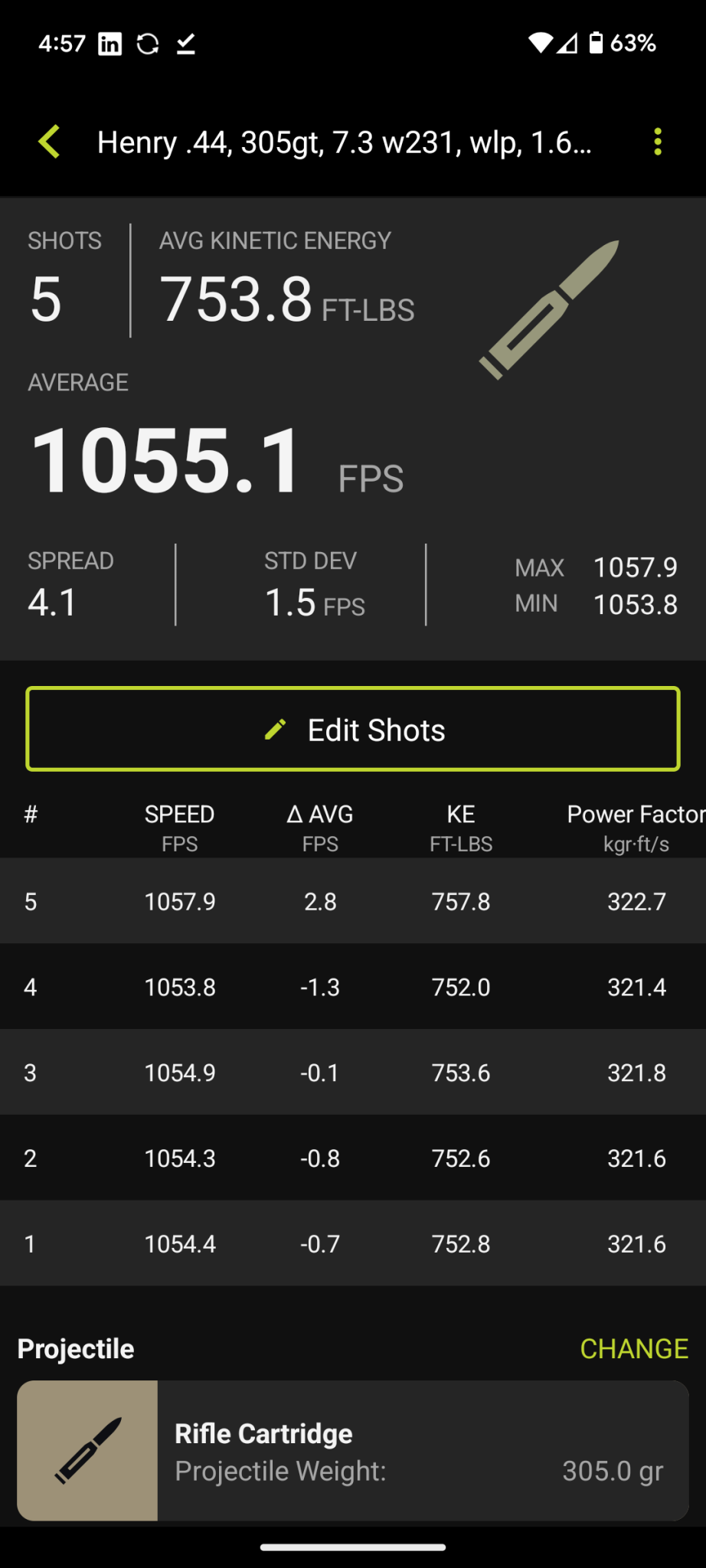

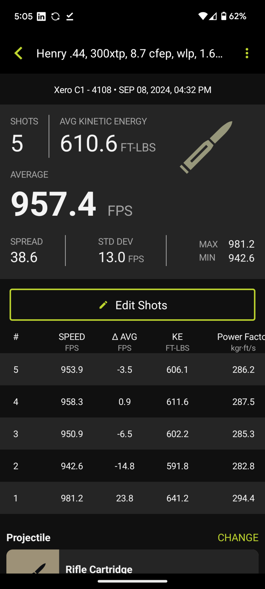

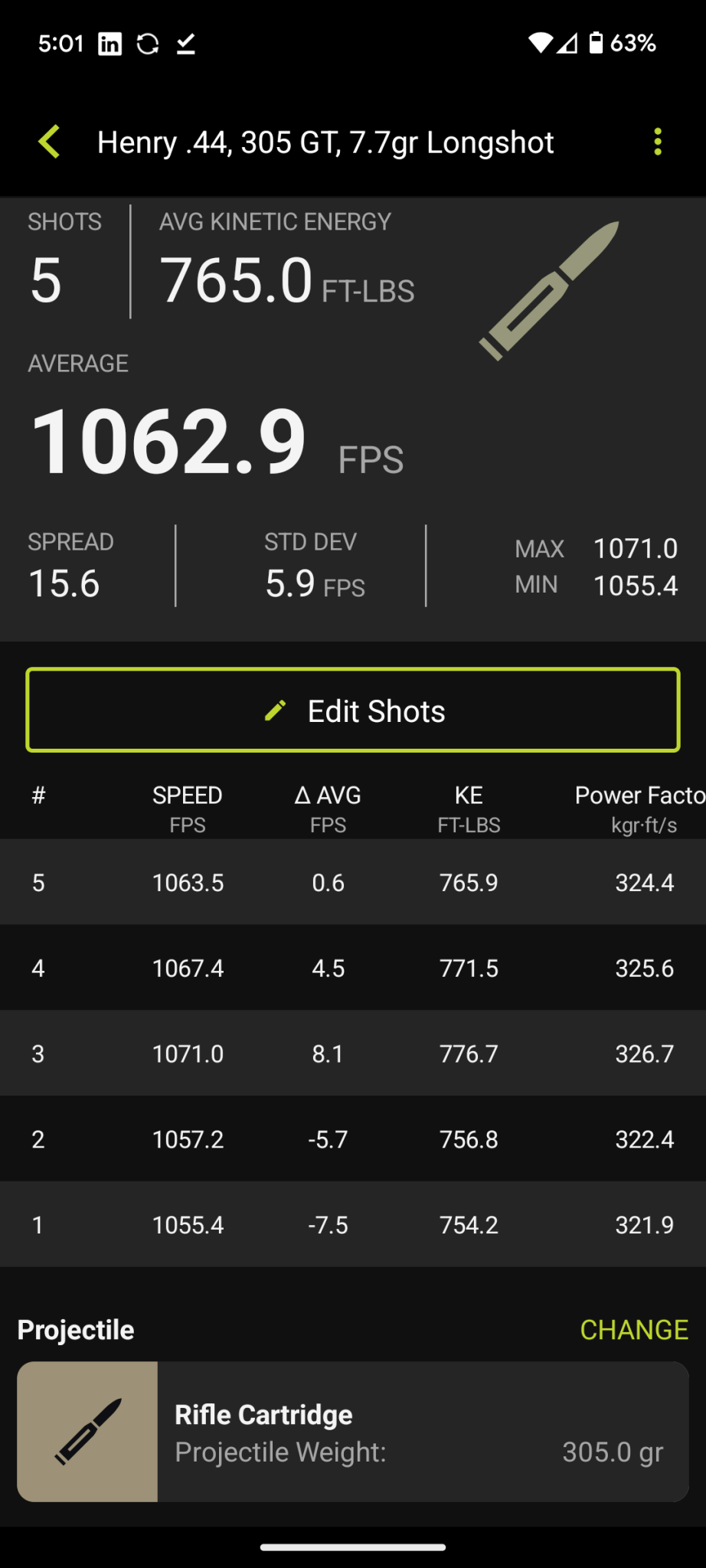

The 305gr below are cast HPs, the 300gr XTPs are jacketed HPs. I have also used 300gr Nosler hp jacketed bullets, including on one of my deer this year and they work well, similar velocities to the XTP for load.
These are out of my Henry X, but I get similar velocities out of my 16.5" 77/44. Pistol powders below that work well are CFEP Pistol, Win 231/HP38 and Longshot.
