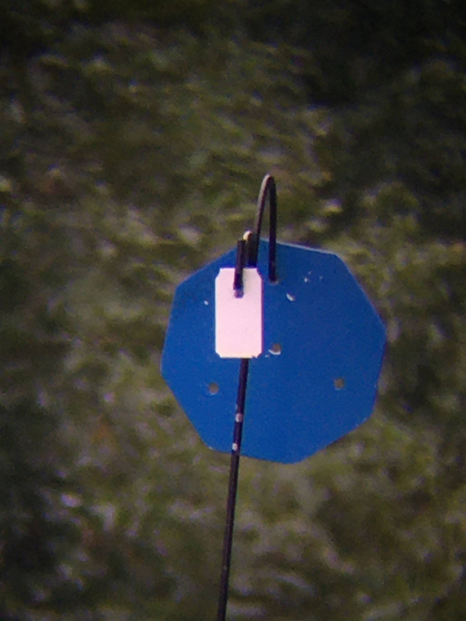

Here’s a low tech approach for our 300 yard soda can challenge practice from a couple years ago.
The can is steel, the backer heavy aluminum, both ring loud and at distinctly different pitch.
