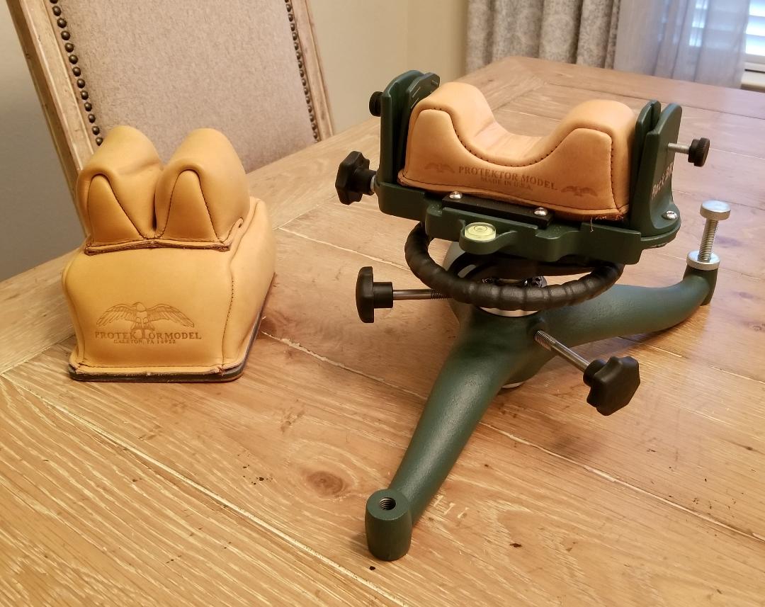

As for me, the dirt shooter, a Caldwell Rock Jr and Protektor #13 were a big improvement over the lead sled.
