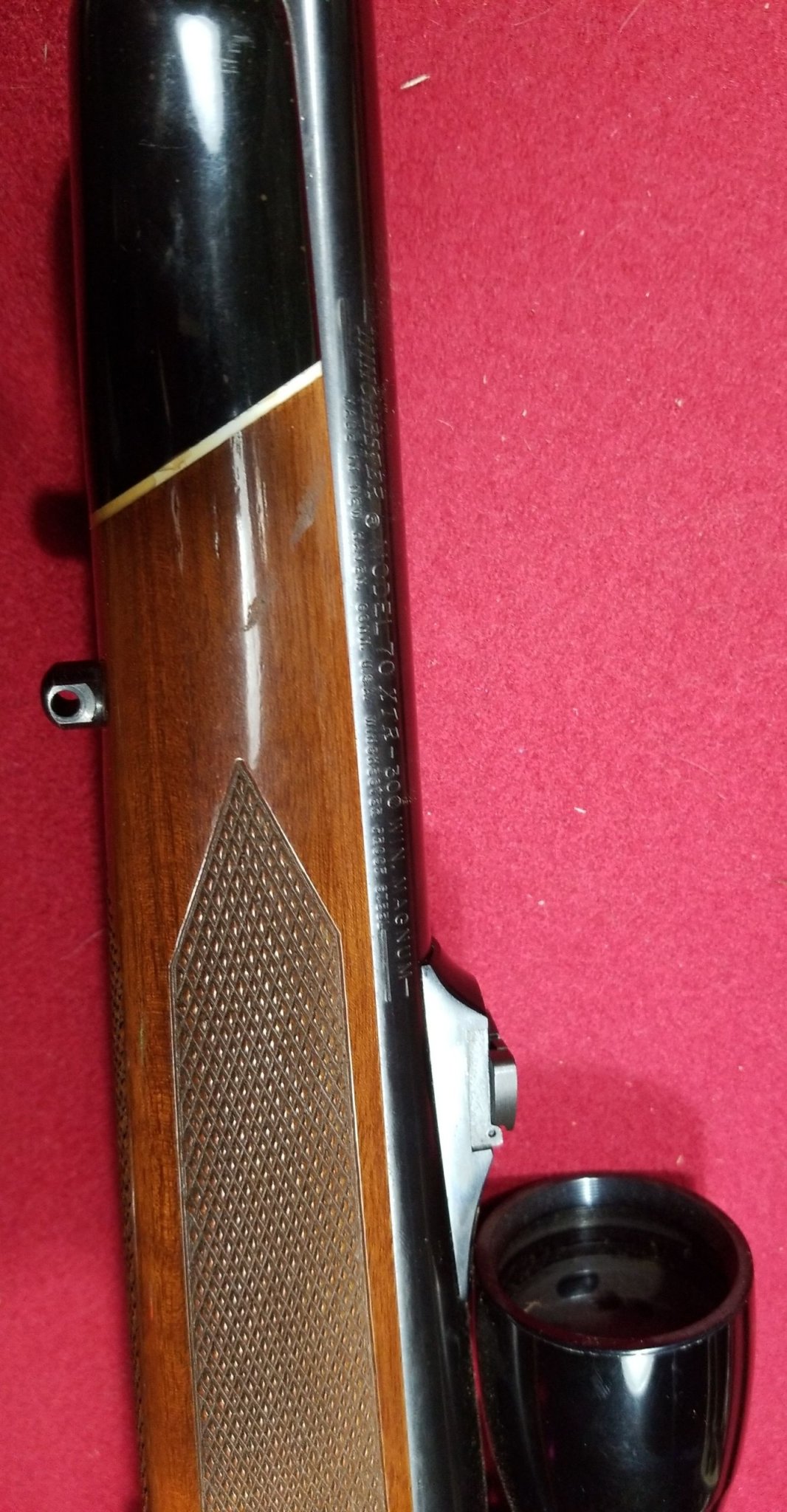

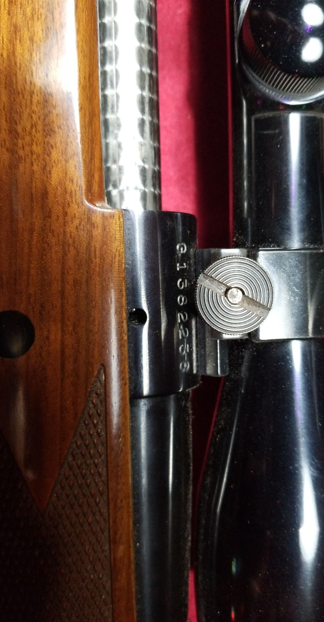

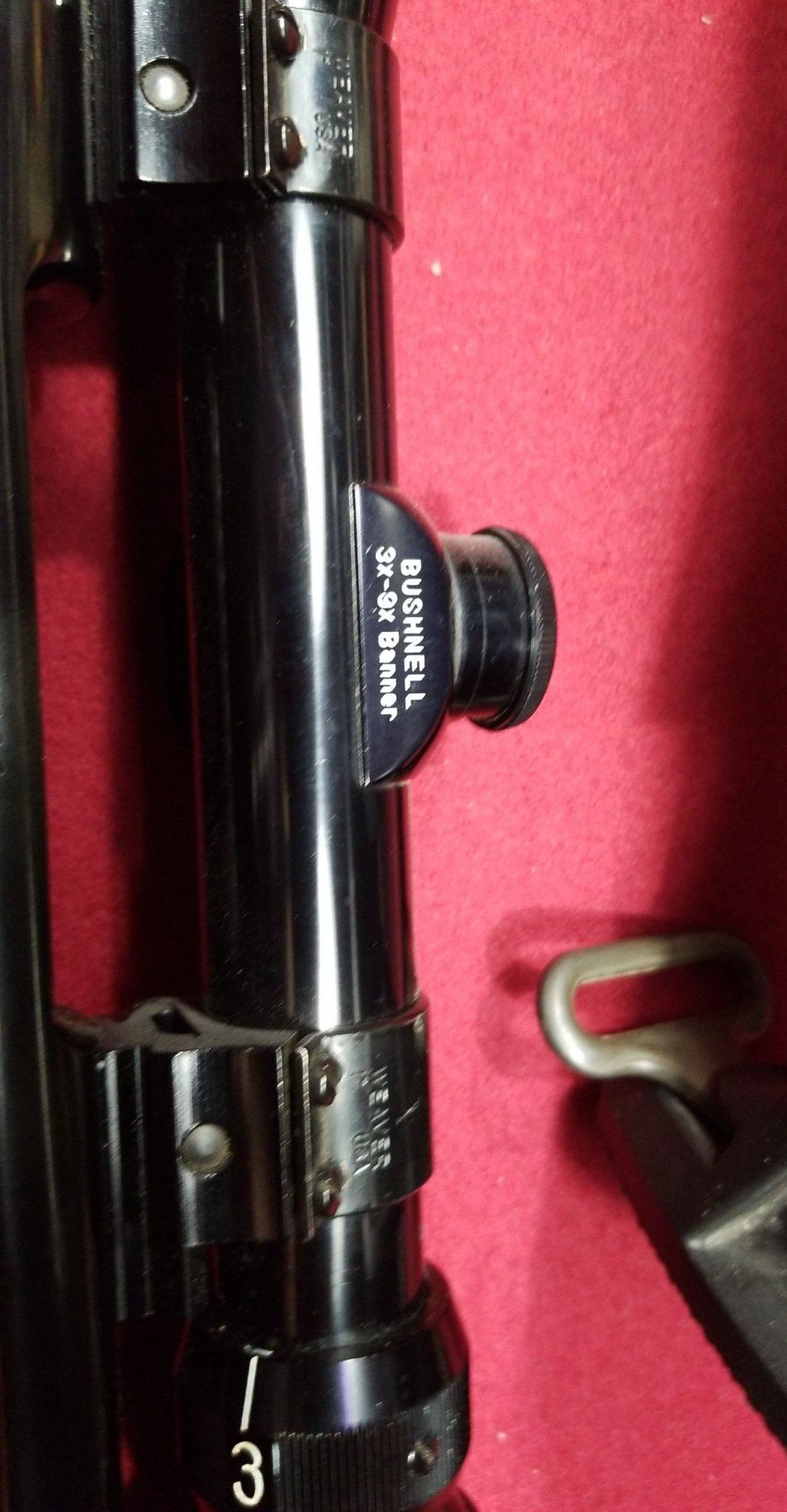

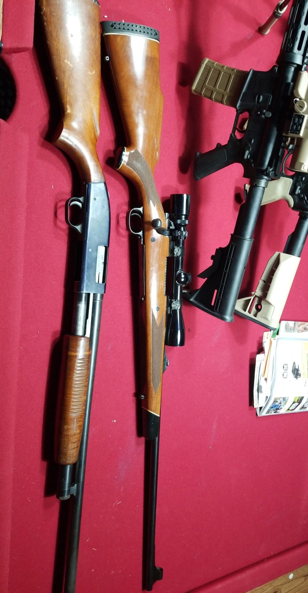

Here's some pics

Does it shoot decent groups With the barrel it has right now,?If it is a tight shooter you could put a Boyd’s laminate stock on it and bed it, they have a “pro varminter” that looks a bit snipery, and they offer a textured paint finish that’s pretty decent, would run about $175.00 and you could bed it yourself. You won’t have the ability to use detachable magazines or anything but it might fit your style better, plus they’re heavy, that always helps with recoil. A good recoil pad works wonders. Most thin barrels tend to open up group size the more you shoot and move your point of impact around relative to your point of aim. That barrel could be serviceable for slow fire as long as you don’t want to put 5 rounds down range in under10 seconds. That way you can spend your money on a good scope and rings. There’s reduced recoil loads you can shoot and work your way up so you can avoid a flinch and learn to read the wind. Poke around the gunsmithing forum here and read about bedding Boyd’s stocks, it’s something people used to have to do before all these chassis and stocks became available . Plenty of advice and videos here on how to do it well and make it look good. Save gramps’ stock for later.

To be honest I haven't had the time lately to see how great the grouping is, my dad has been pretty impressed when he's shot it lately though which says a lot in my book anyways, I don't think he was shooting further than 100-200 yards however. Have a wheel I gotta take out and measure the distance one of these days. Don't think I could put 5 bullets down range in 10 seconds if I wanted too, It only has the capacity for three and I'm not quick enough with loading it yet.
