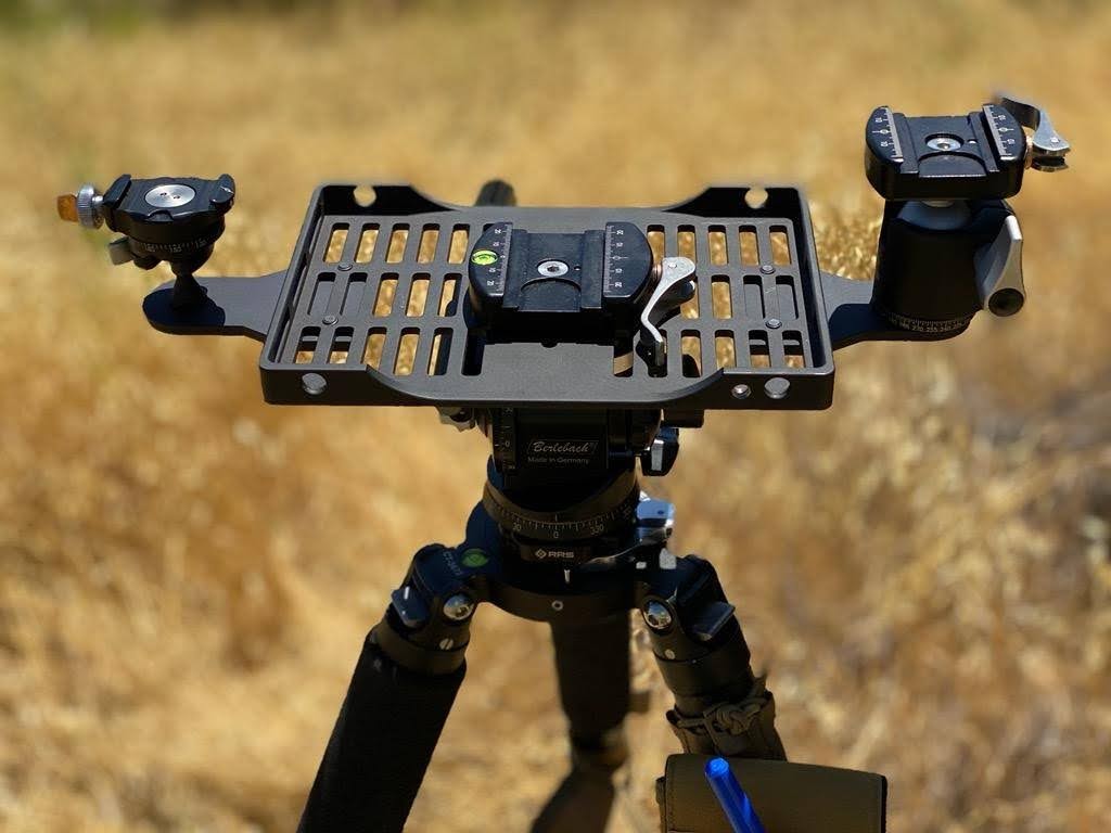

geared head or lots of cheaper telescopes come with a tripod and slo-motion adapter, so there might be other options to the Orion.
This is what folks are using in my neck of the desert.
Reactions: snoopyloopy
Hi seansmd, I recognize the Abel Table, that looks good.
As for the rest of it, I know RRS is great in general but wouldn't you rather have something with windage and elevation adjustments rather than a tripod ball head so you can get your LRF and spotting scope and whatever else easily in sync? I dunno I'm no expert but IMHO a ball head just seems like the wrong solution for this particular application. But I do see a lot of setups like yours so maybe you know something I don't.
i have heard this before, but really i just use the adapter because it is easier to scan across objects to range them than using the ball head.
Maybe this is a dumb question but when you say "the adapter" which adapter are you referring to? Do you mean some kind of slo-motion adapter? If so which one do you use?
On the left and right side there are independent ball heads that can be adjusted to colocate, and if you use the center you have the ball head of the tripod itself. I mount my binos on one side and use the main adjustment if the tripod then he the lrf in the other ball head to co-locate to the bino. Maybe I'm missing your use case.

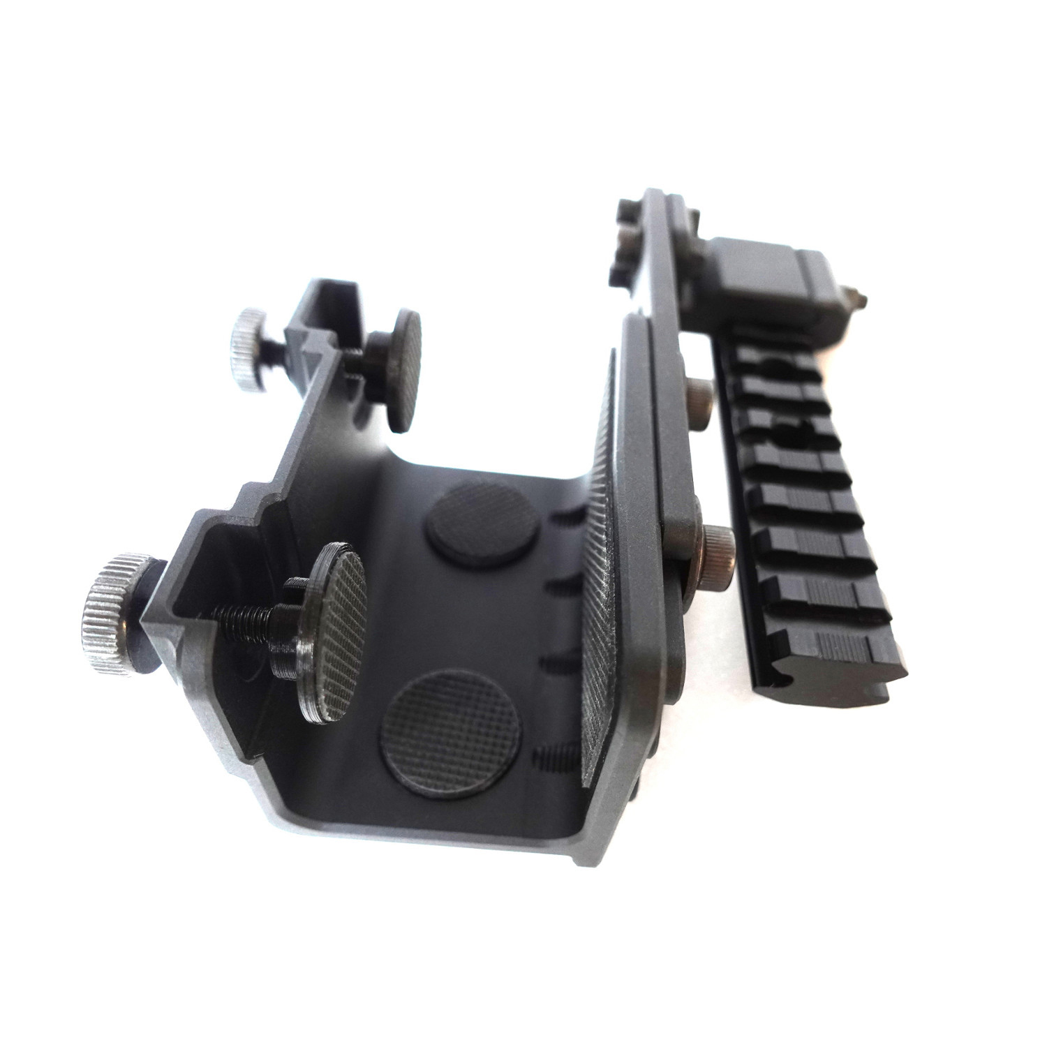

This is an old thread I started a couple years ago, but just in case anyone is interested, I FINALLY found a mount under $300 that will co-witness a rangefinder with a rifescope or a spotting scope, it's called the Sightlok RF-1.
I have a couple of these and have been testing them for the last week or so. They seem to be pretty durable, they hold almost any consumer-grade rangefinder like a Leica, Leupold, or Sig Sauer pretty securely. Due to the limited amount of space in the clamp, it's not going to work for a large Vectronix military rangefinder.

Depending on the application, one advantage of the Sightlok RF-1 versus an L bracket is, similar to the Ashbury Rail Grabber, there are windage/elevation/azimuth adjustments on the mount itself.
My personal experience is that when co-witnessing electro-optics, fine tuning may be needed. Maybe not a concern with a spotting scope but absolutely with a riflescope.

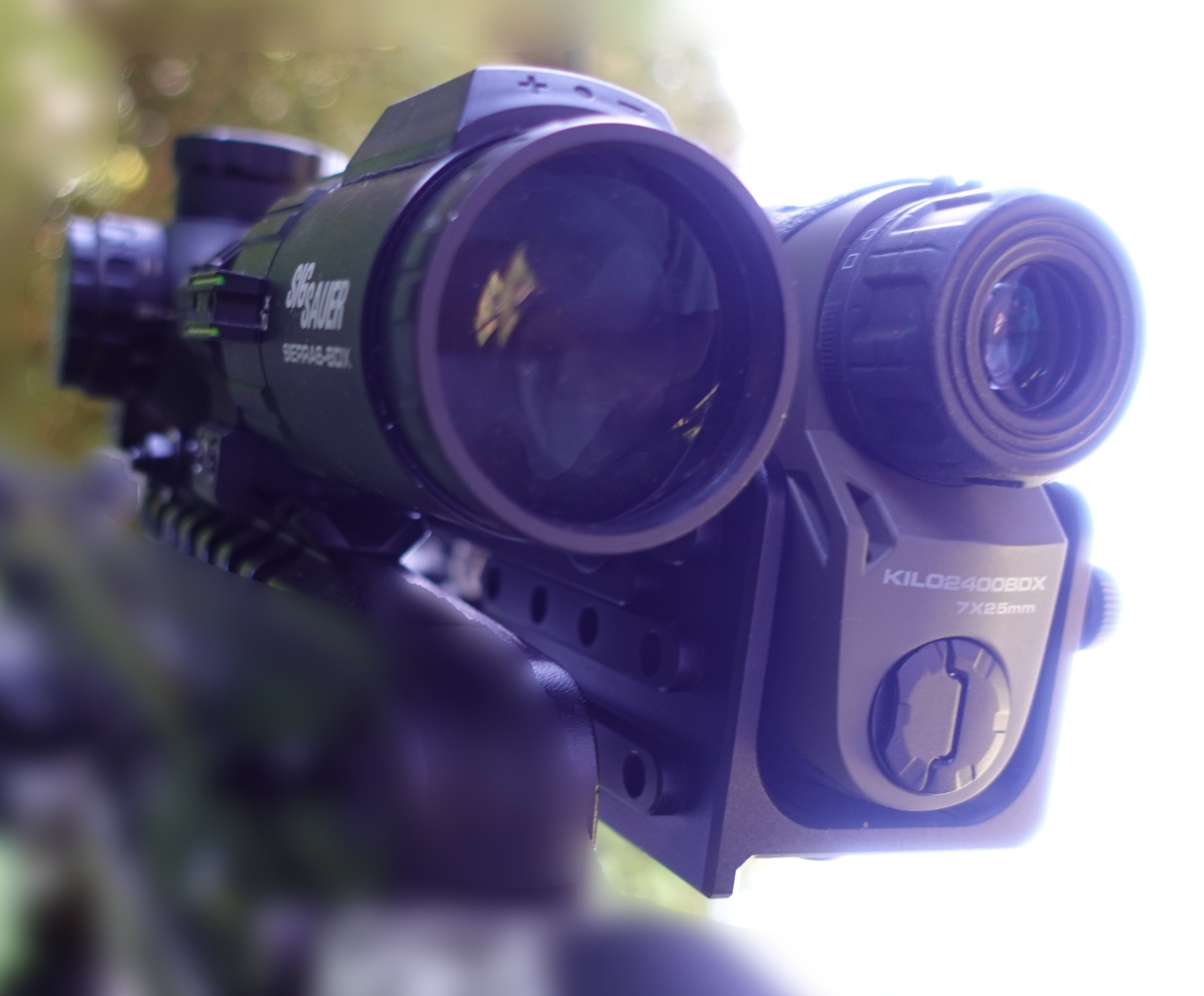

Yes that was a concern of mine as well. Originally wanted to try and pick up a used SilencerCo Radius but in this case, I wanted to turn my Sig BDX scope into a poor man's clone of the NGSW-FC or whatever it's called (rangefinding scope) which requires using a Sig BDX rangefinder.
Maybe I've just been lucky but so far both my Sig KILO2400BDX and Sig KILO1800BDX have survived the recoil (.308).
A larger caliber might very likely be a different story.
It's not a matter of luck actually. I'm also using a Sightlok mount and there's no problem with recoil damaging the rangefinder. The Sightlok RF-1 uses rubber mounts to isolate the rangefinder from most of the recoil, and most rangefinders don't just fall over dead from minor bumps. I'm not claiming it will work with a 50BMG, but with regular .308 level recoil, you'll be fine.

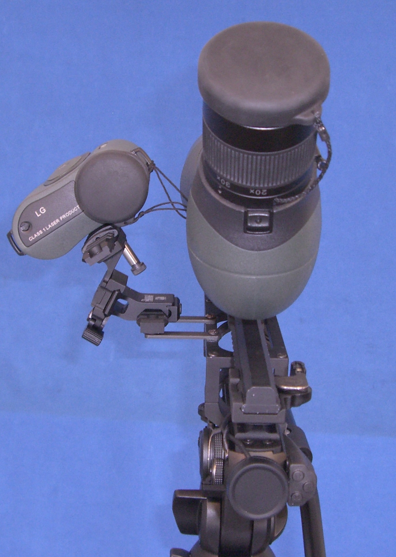

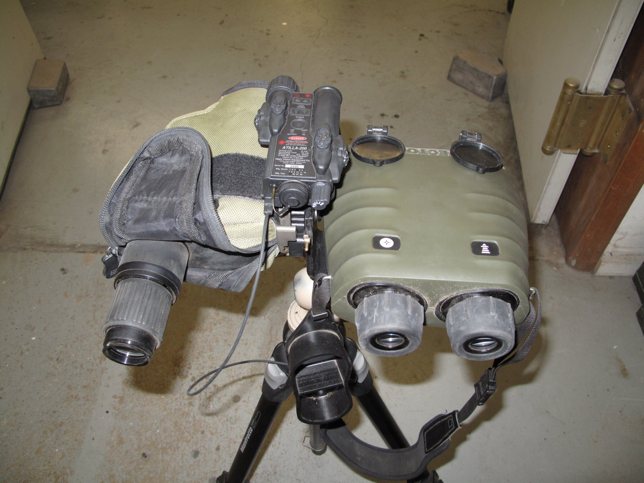

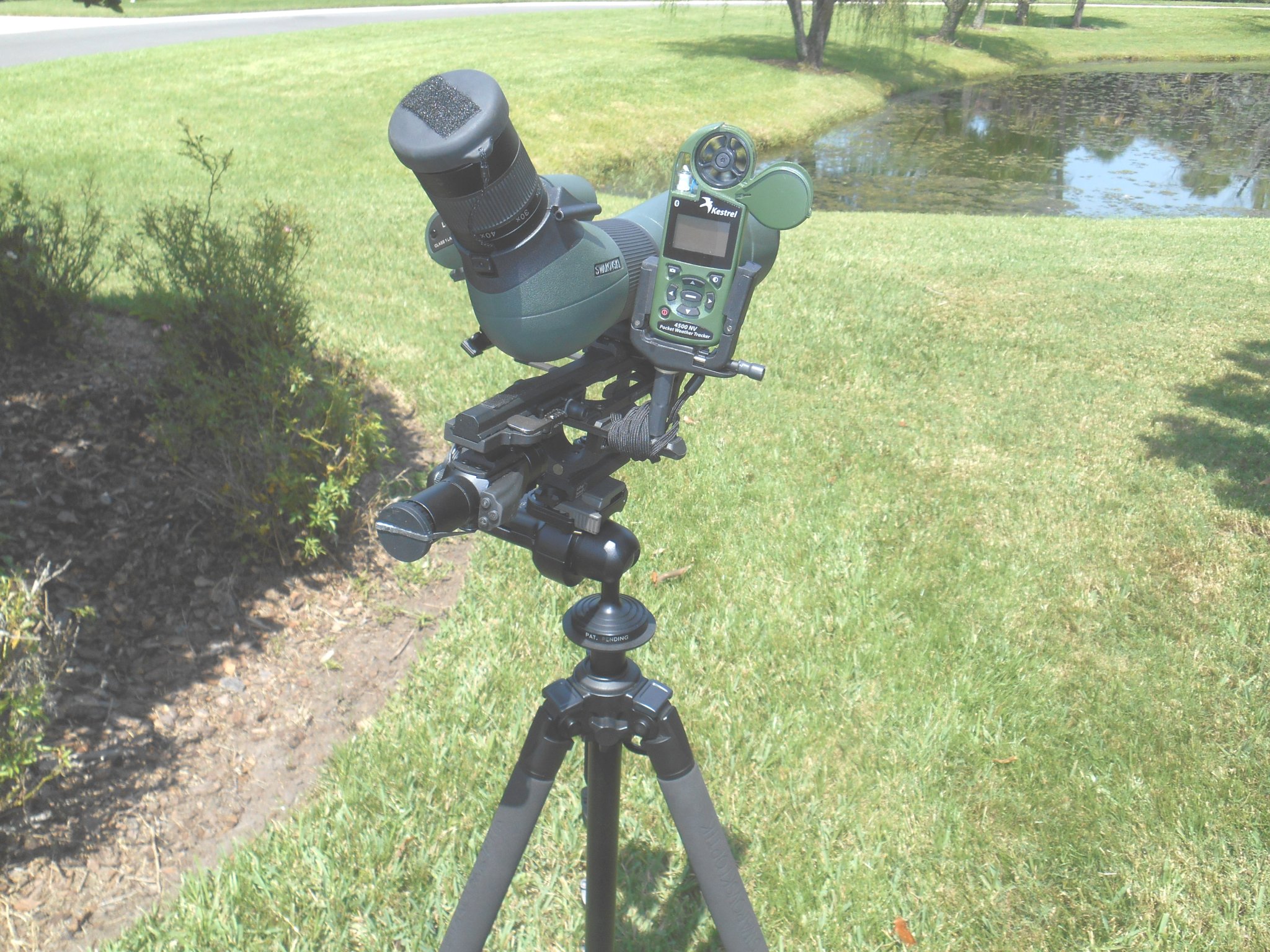

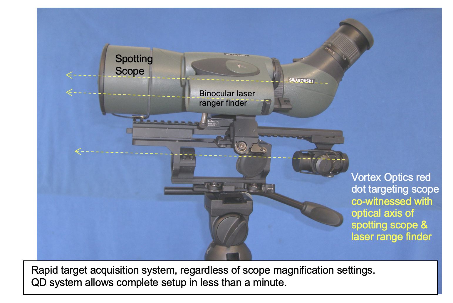

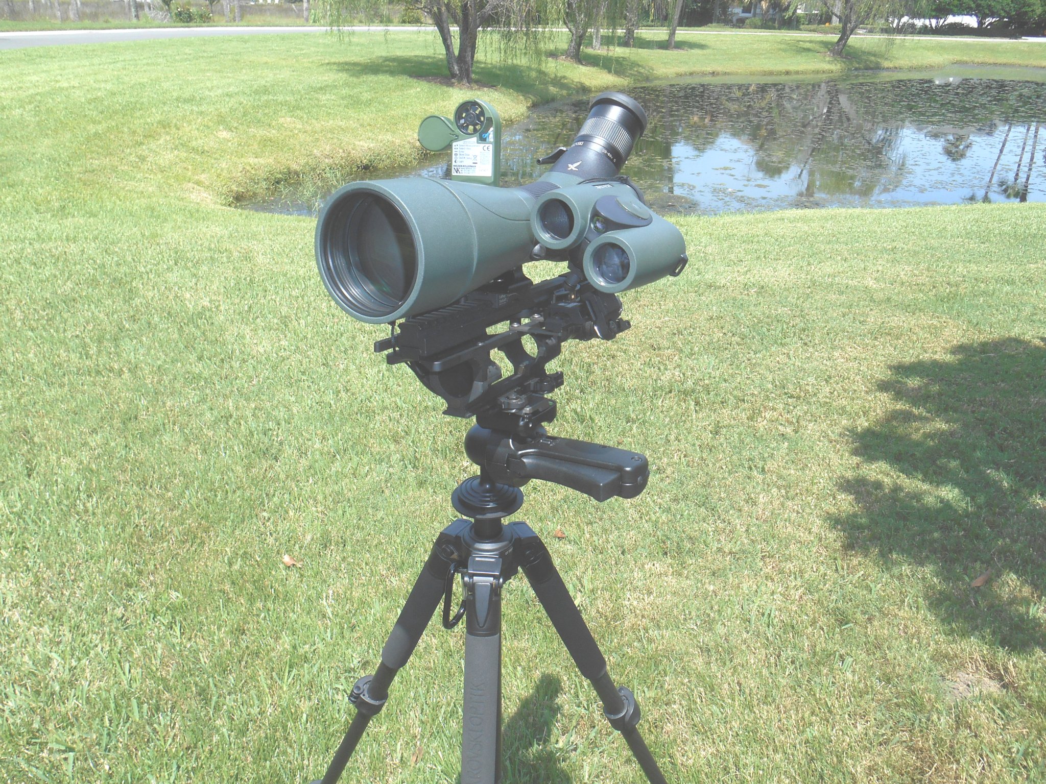

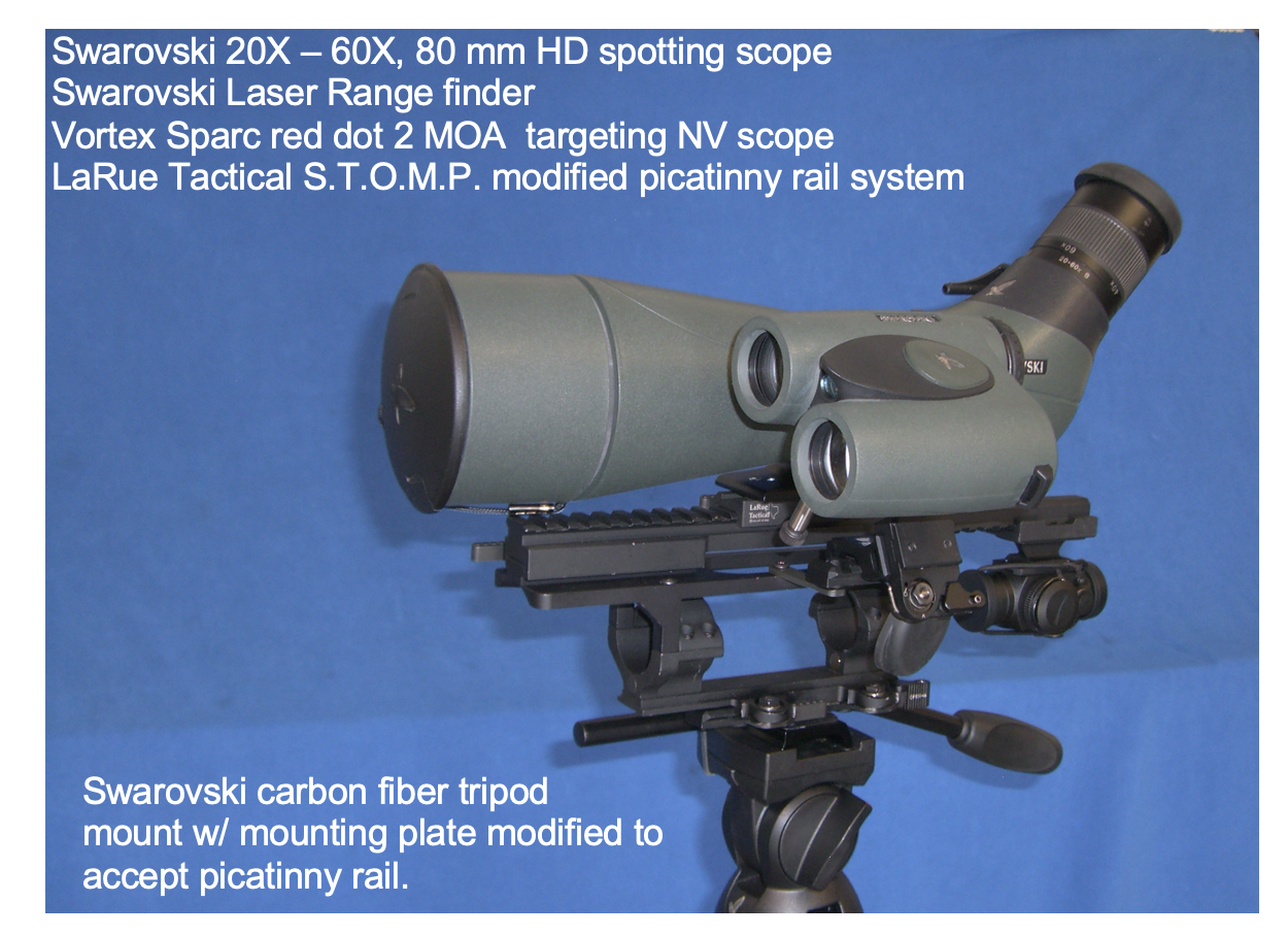

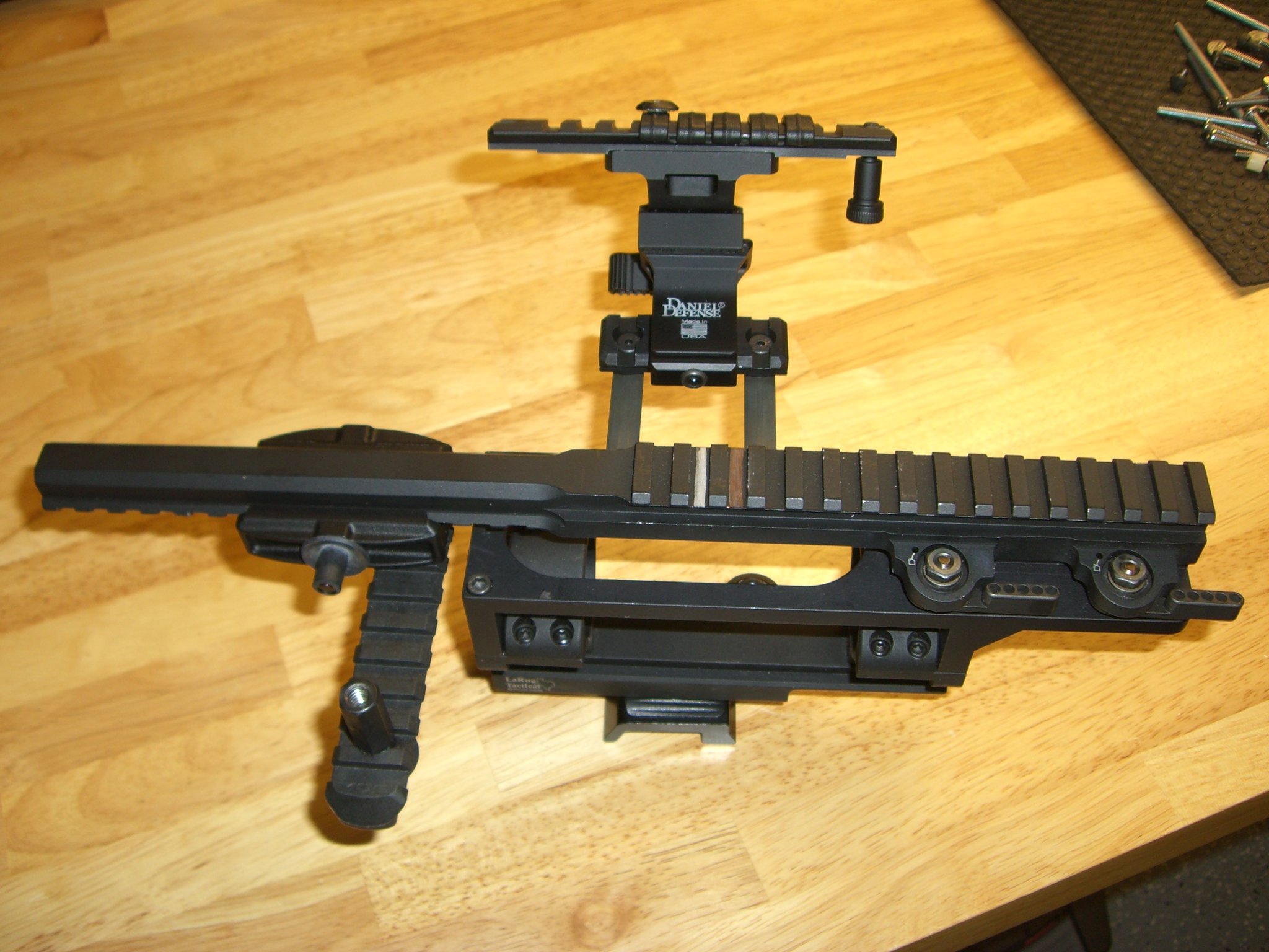

Not rifle mounted , however, before tables were in vogue I used this setup using a red dot optic to sight on target, spotting scope and bino-LRF. It was very efficient at high power magnifications.
Could do the same today with inexpensive dot optic for spotting off a table.
@strikeeagle1 That is pretty badass. Even color coordinated. You must be nailing some hole-in-ones and eagles with that setup (I see you're on a golf green ;))
I think the OP mentioned something about windage and elevation adjustment but that's still cool. What mount are you using for the bino rangefinder?

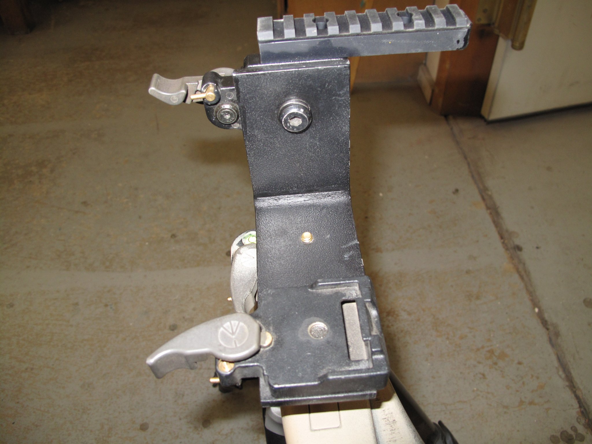

Forgot I had to fabricate some offset rails to mount a Daniel Defense 45 deg QD picatinny rail mount. Used a shoulder bolt to secure the LRF-bino to the rail.

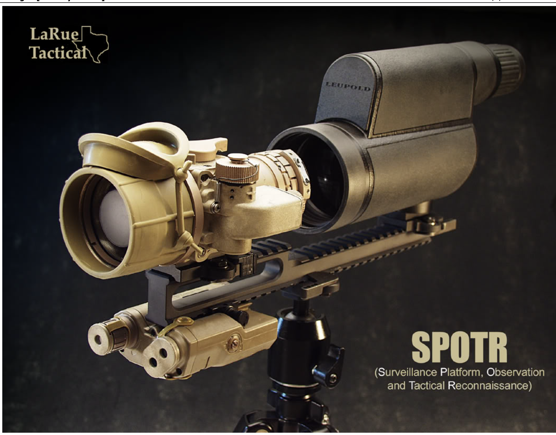

I had a couple of the STOMP mounts which is the host rail system flipped around a little bit.
