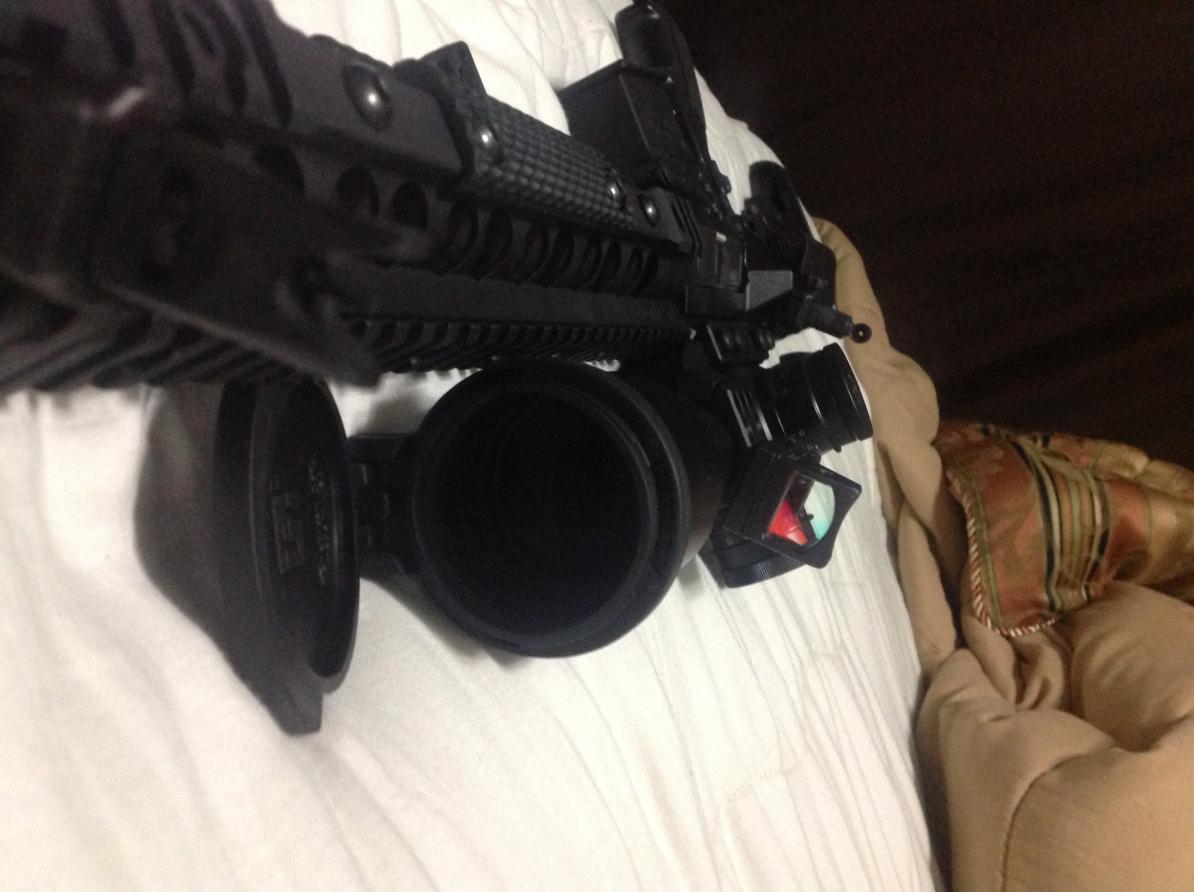

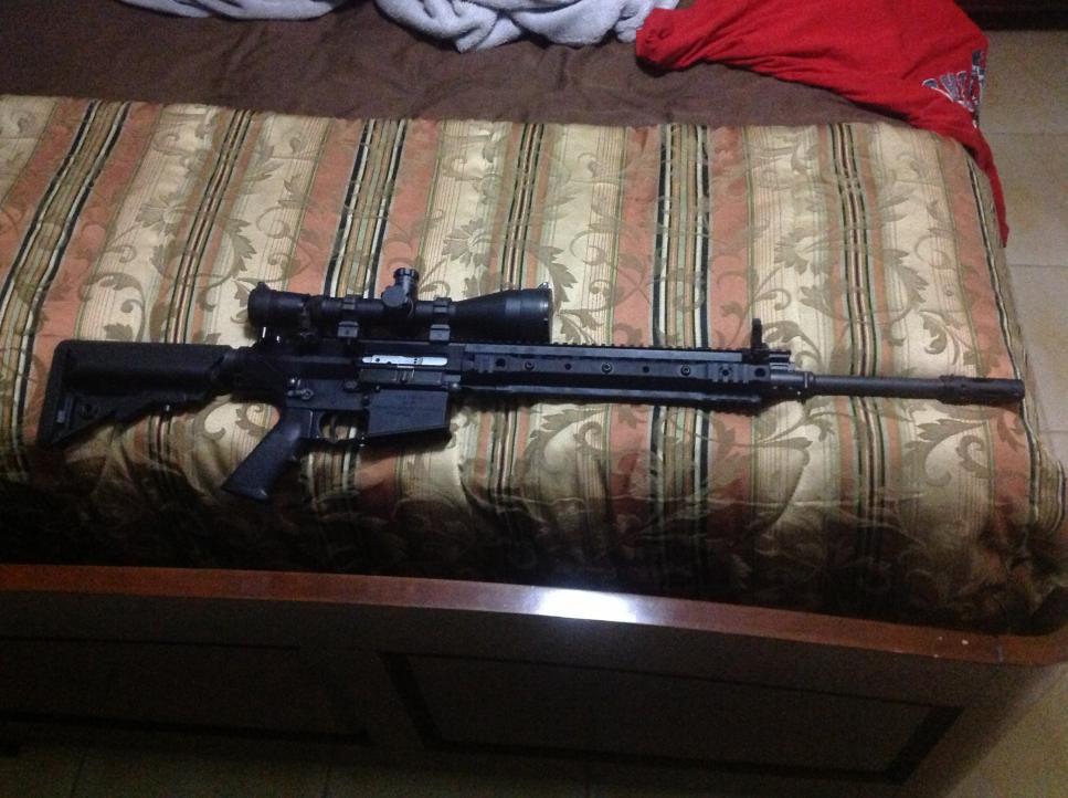

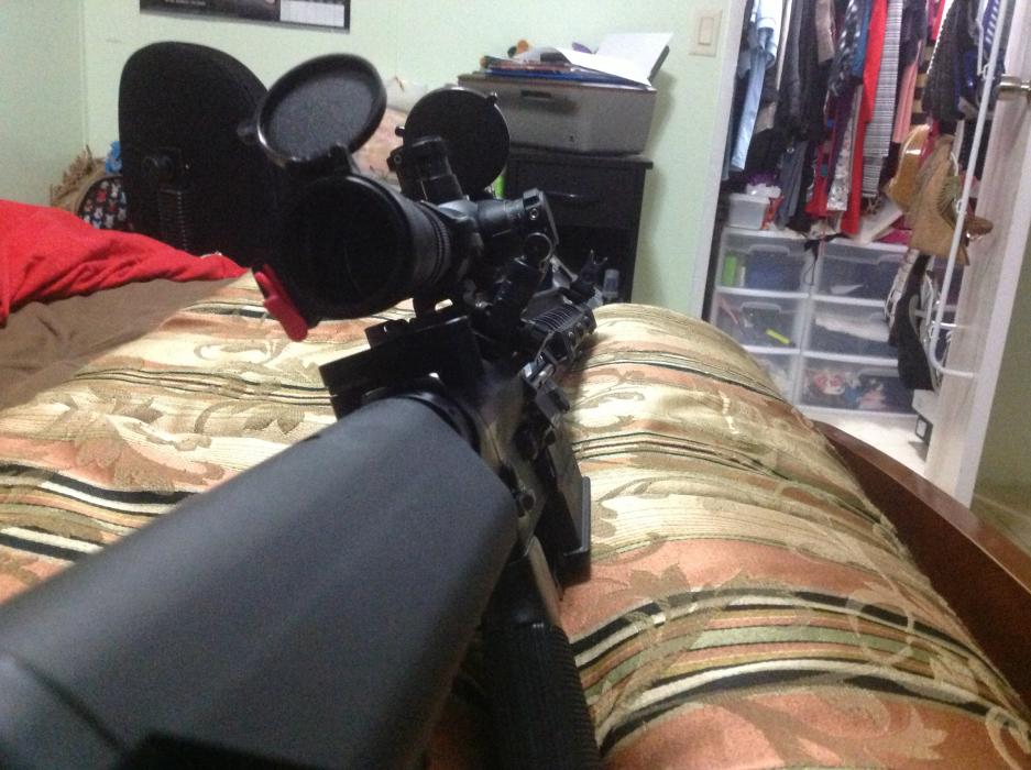

Pics of my sr25 the scope is my friends ( leupold 4.5-14x50 ) that he let me use for the meantime.

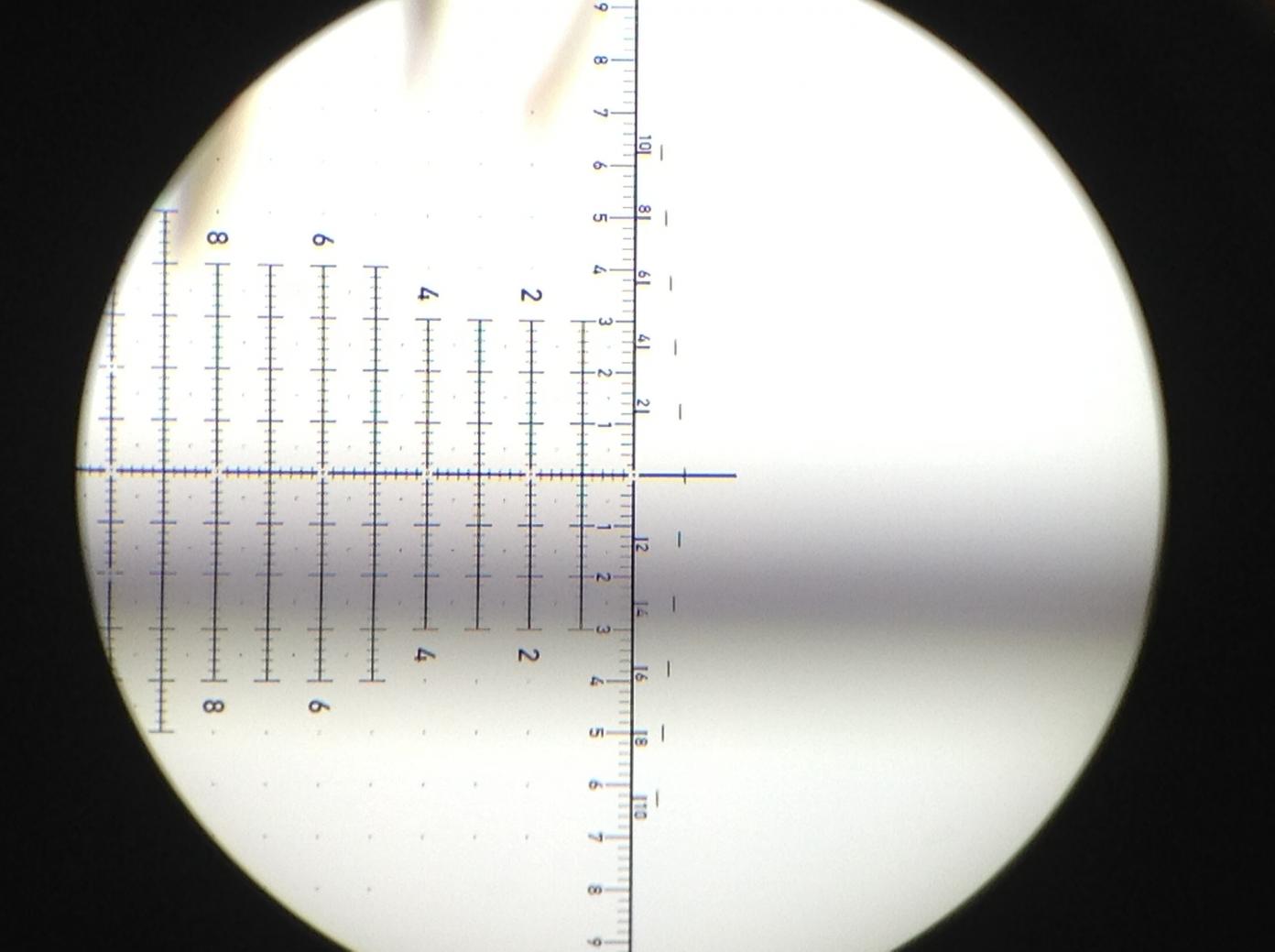

You do not need a 40 plus moa (13mil) base for a 3-20 on a 308. Hell, you could probably use a flat base. In addition you have a horus reticle which limits the need for an angled base.
Also, where did you find that 25 meter number?

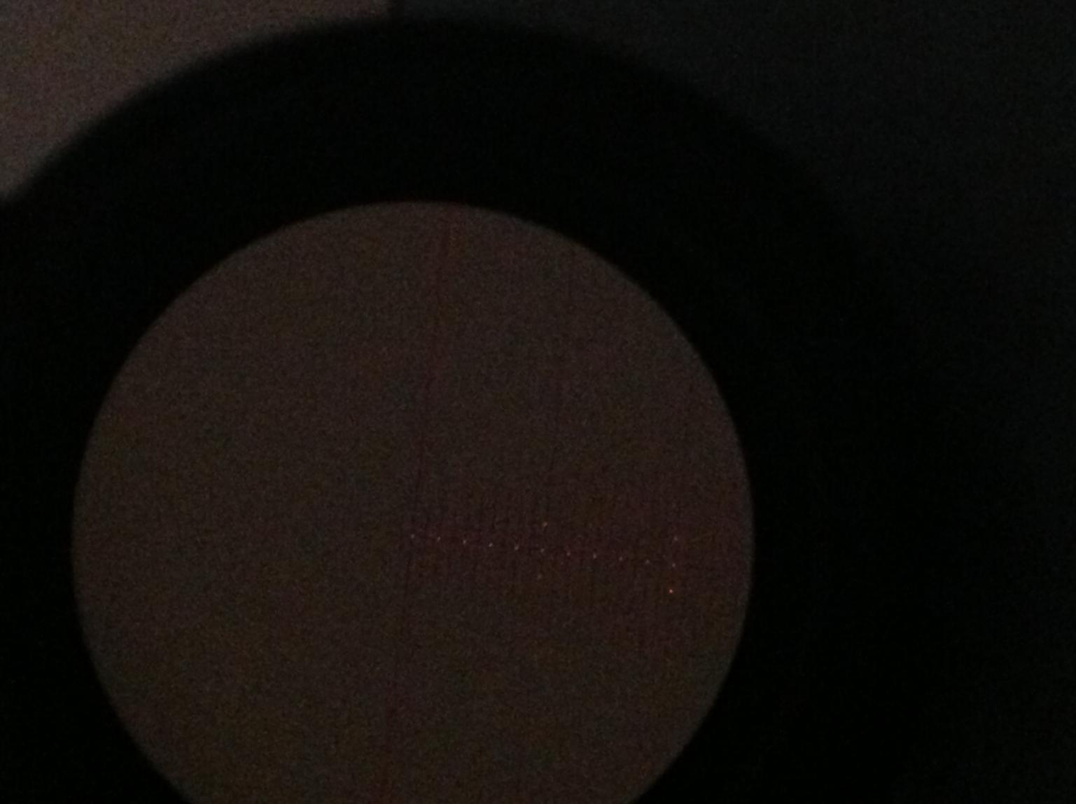

None of 3-20 or 3-27 reticles I have seen work at 3x- so if you are looking for a scope you could actually use close distances with semi-auto, forget it.
Reticle disappears against background.

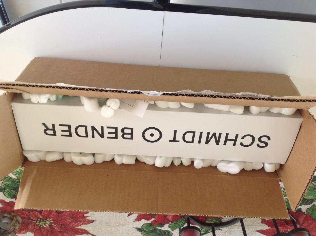

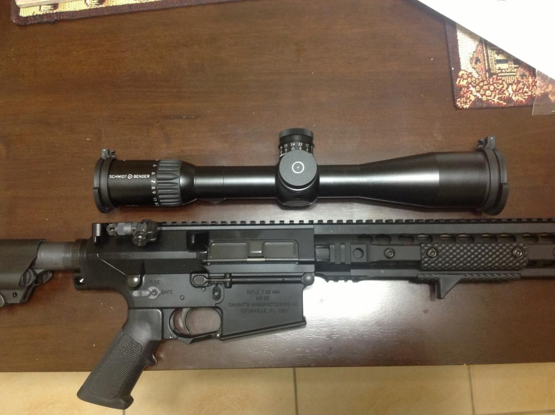

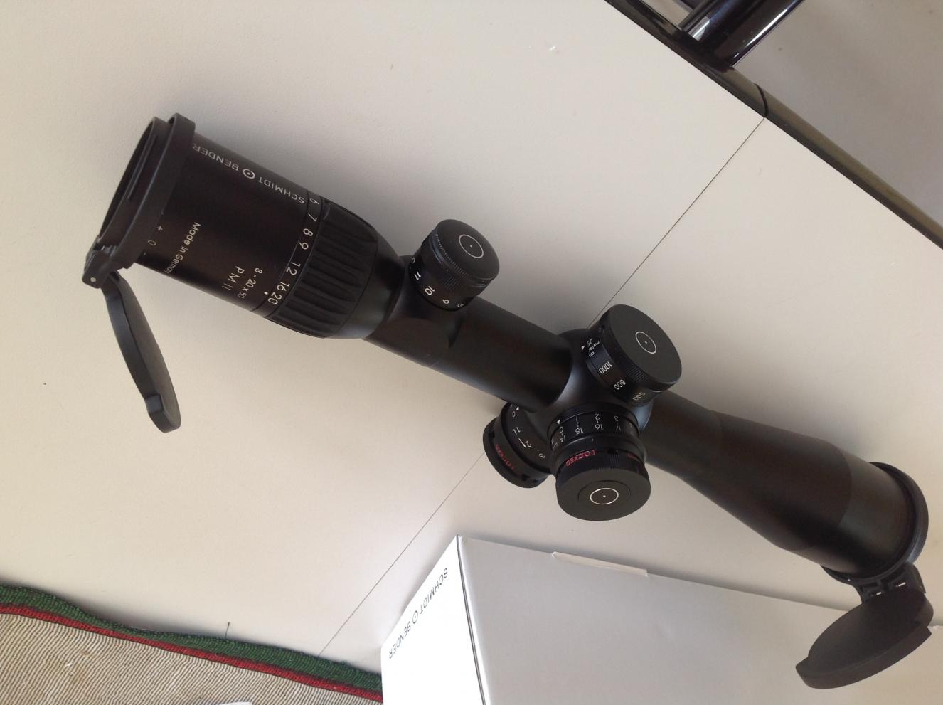

Yea when I saw the scope I freaked out , it was more than I was anticipating , worth every penny IMO. I just need to get the scope mount and I'm ready for the rang. I will take some better pictures next time.

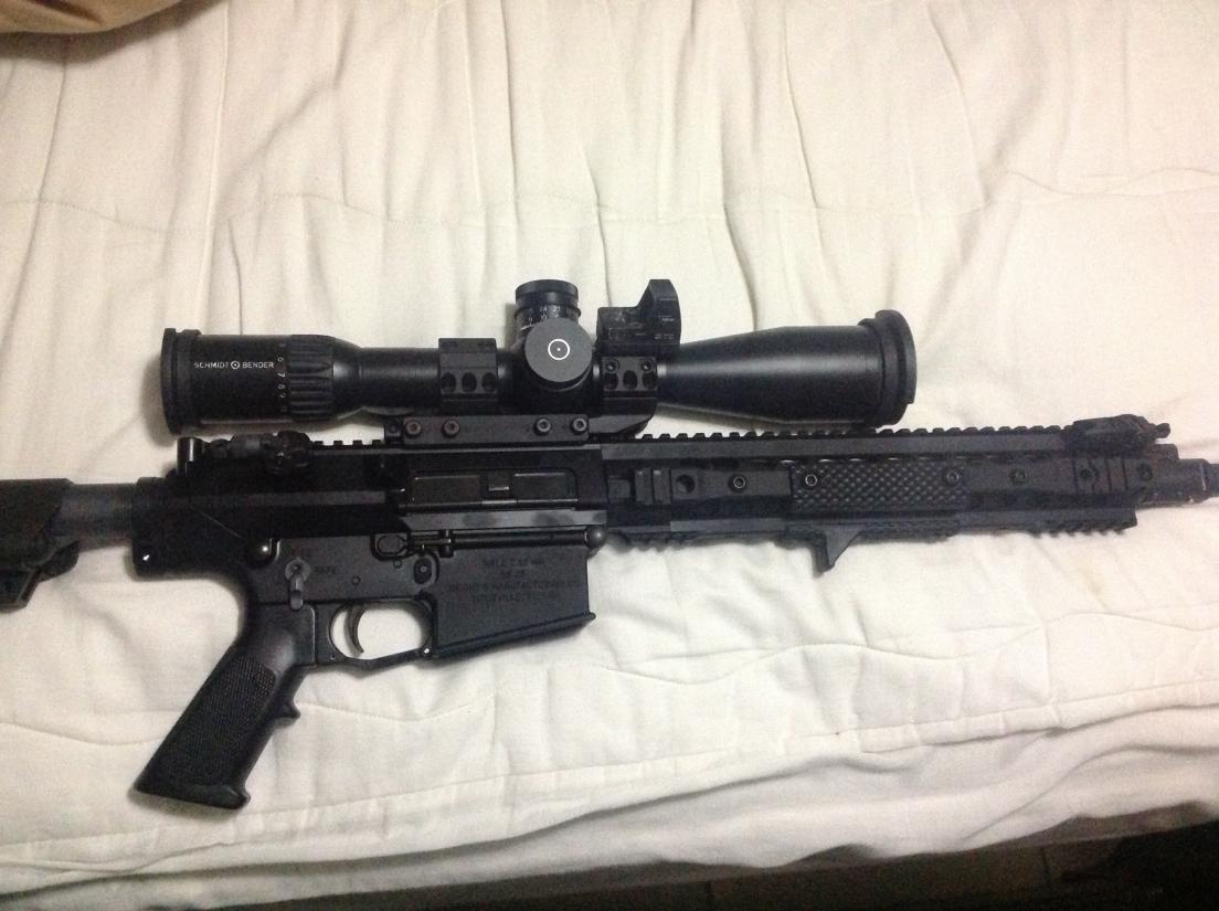

Im pretty sure mine is the 1.46 you can see clearance here
You should have even more clearance. I bought my Spuhr from Mile High they were great in ensuring I got the right equipment.
