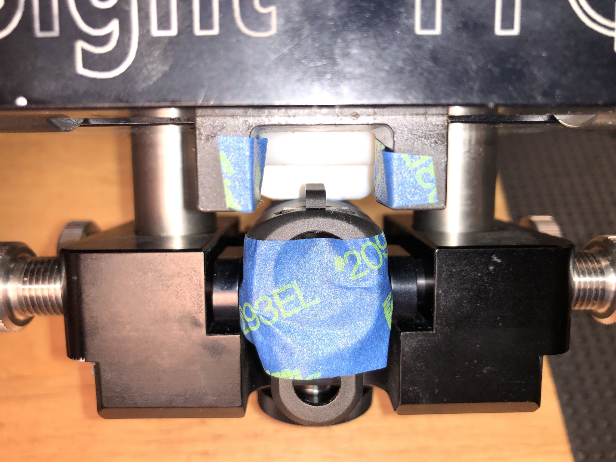

    Universal sight tools in general for pistol sight removal are junk; don't fit well, have coarse threaded bolts which lack precision movement.
    The real problem with their use is that when the lateral force is being applied to sight base the slide wants to move up / down out of alignment with the force application...that's the moment the slide / sight slips and $crews up your gun art. The Pro Sight has two large lateral supports, a top support and a fully supported internal slide support ("shoe") which allows all the sight tool face force to bear on the sight.

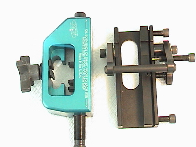

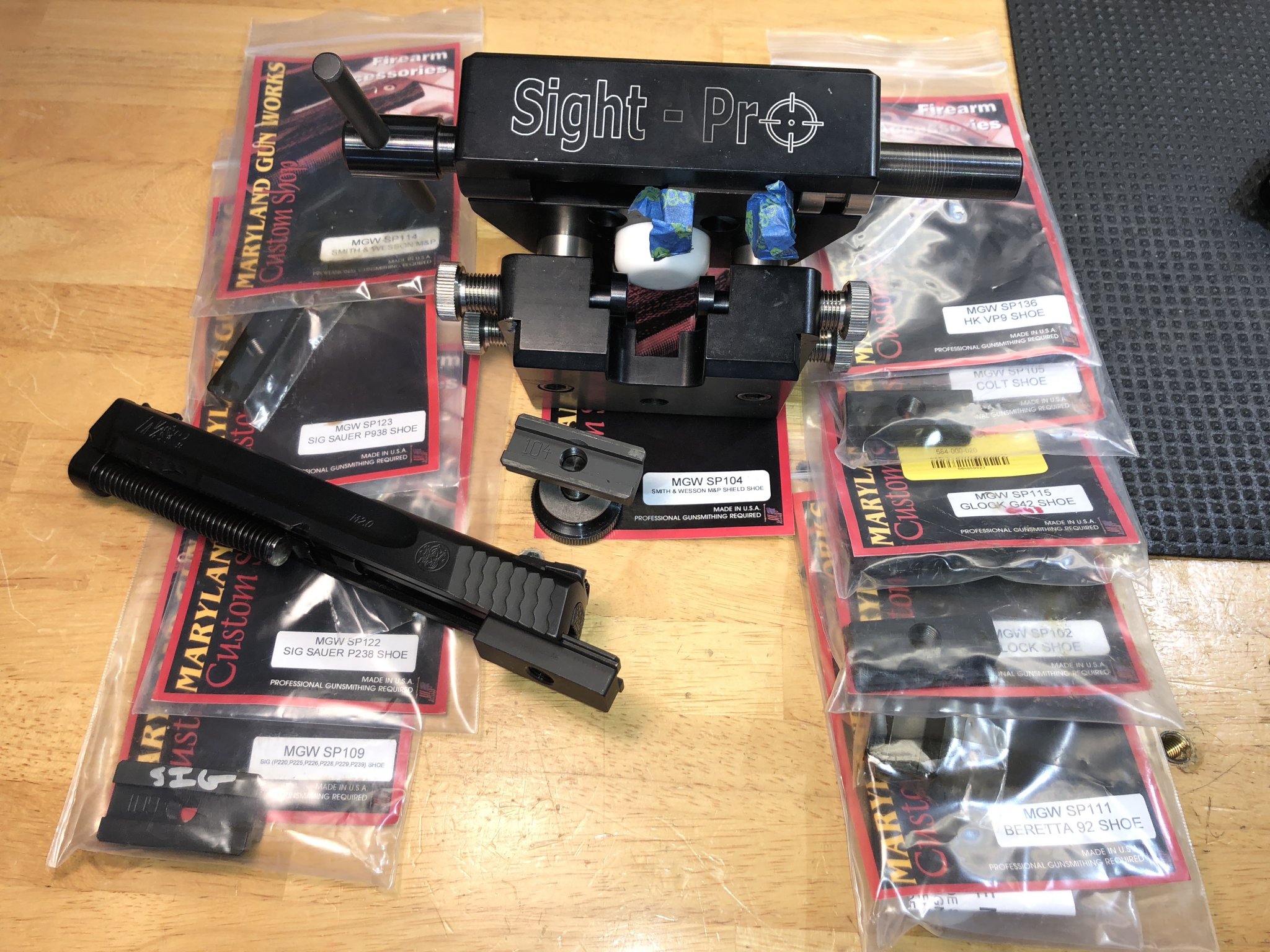

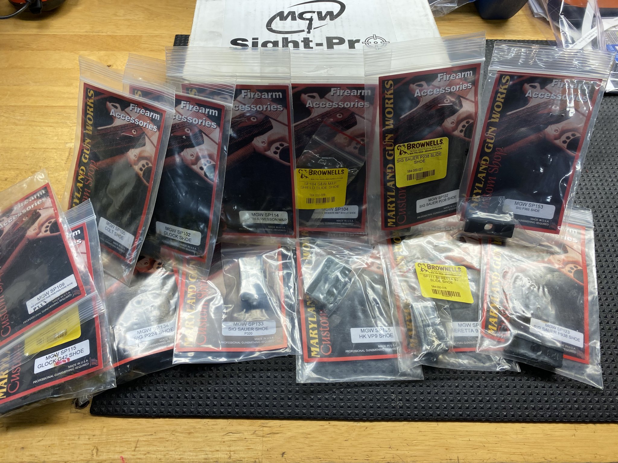

    MGW Pro-Sight is worth buying once; huge selection of specific "slide shoes" for various model pistols. Before the Pro-Sight
    MGW pistol specific sight tools were the best, unfortunately now they are just expensive paperweights.
    Shown: A Sig front sight easily removed, right to left.

    I have never found anything in this category both cheap and good. Ebay is a good place to pick up used MGW for less.
    Go cheap and you may break sights, damage dovetails, etc.
    Universal usually isn't, especially with suppressor height and night sights that can break and lose glow easily.
    I don't have any experience with the MGW universal, but my understanding is it is basicly modular. Buying plates to fit the various rails instead of a tool for each.
    I used to gunsmith and saw plenty of guns with the dovetails messed up so the sight wasn't held firmly.

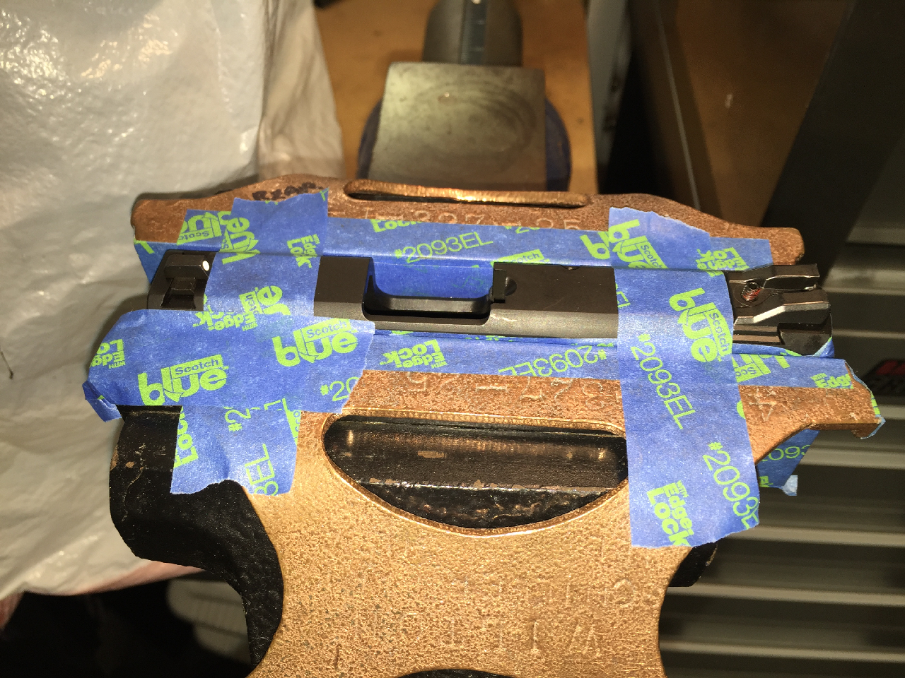

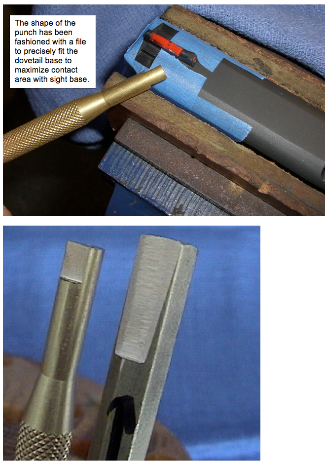

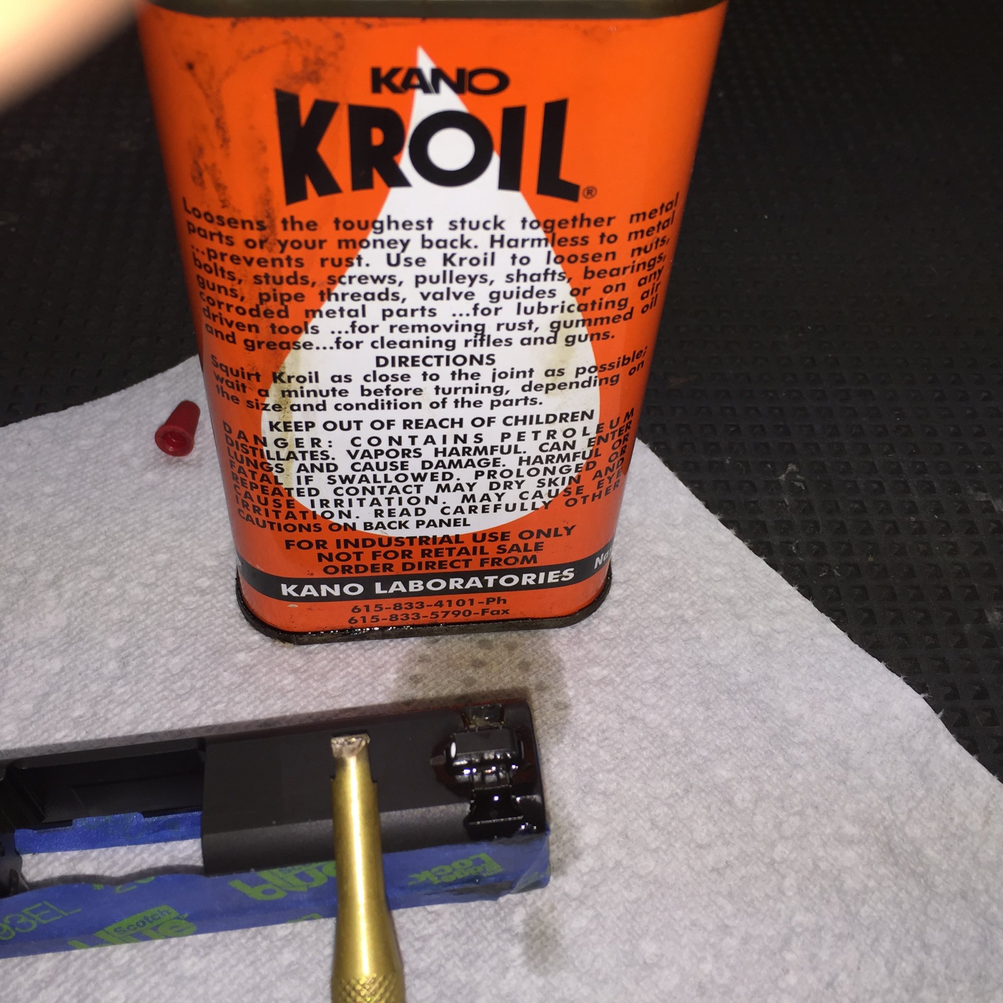

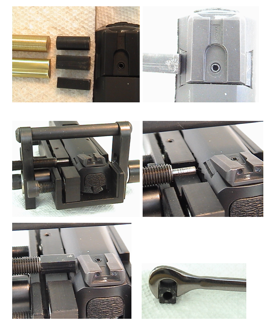

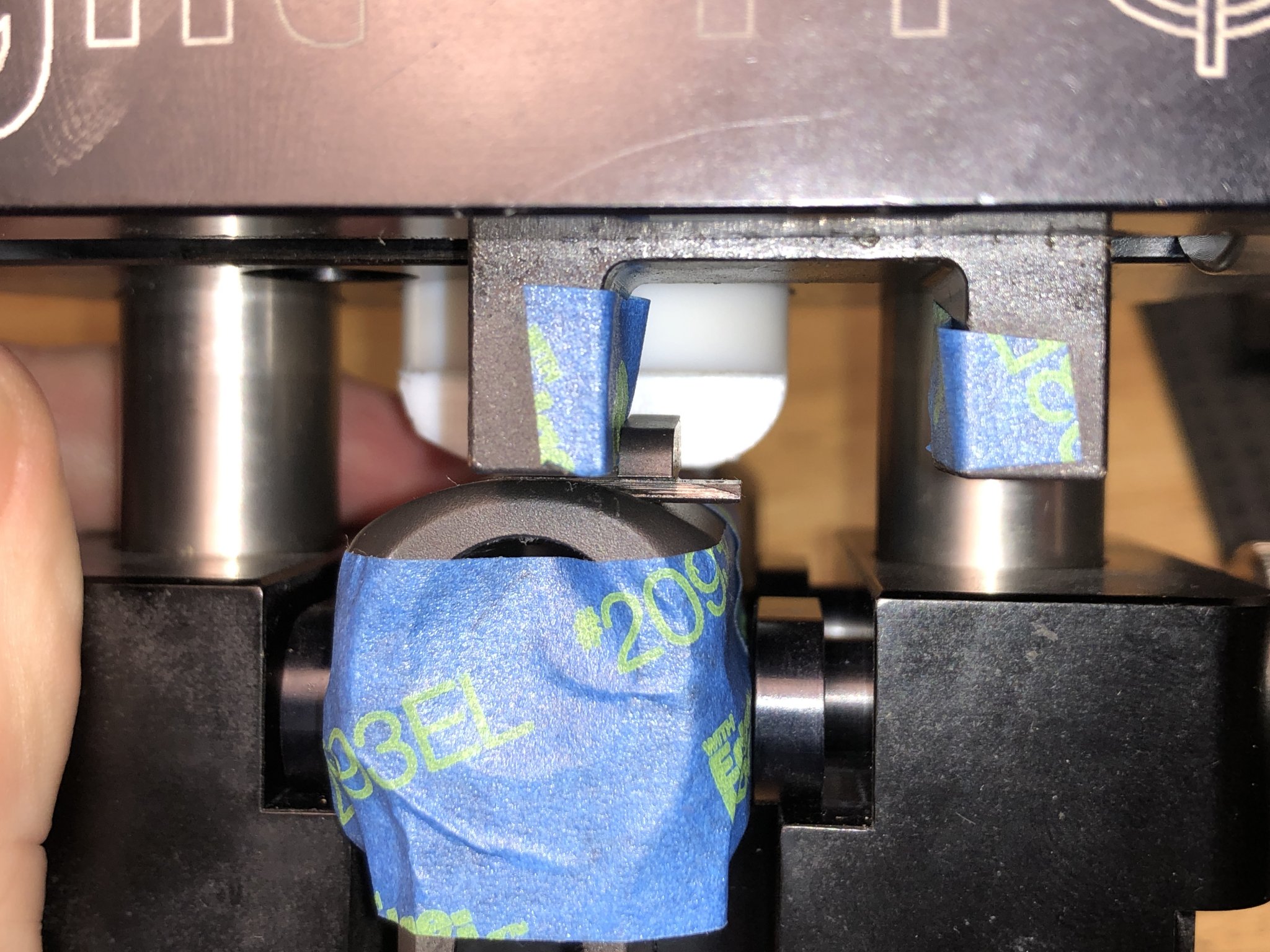

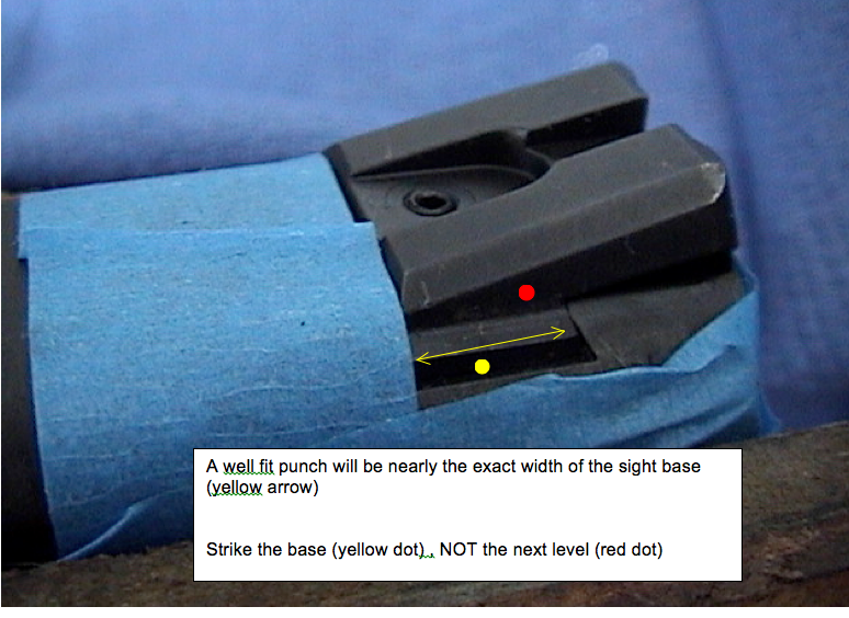

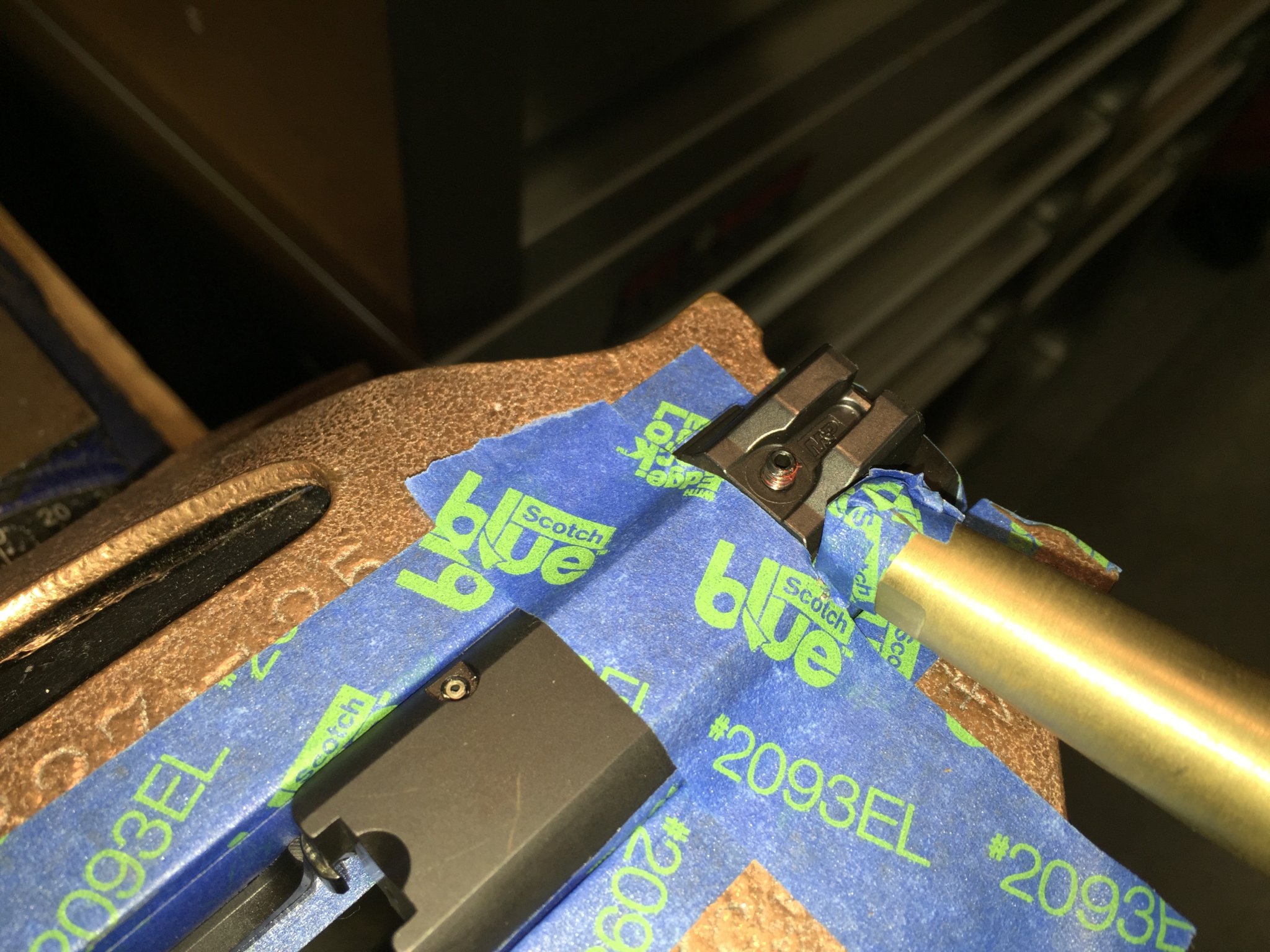

    To save money, nothing wrong with using punches and a good vise to remove sights, just need to tape protect everything and use precision punch faces to do it like a professional.....and don't forget to loosen the set screw if present.
    Patience and some KanoKroil prep are useful tips.

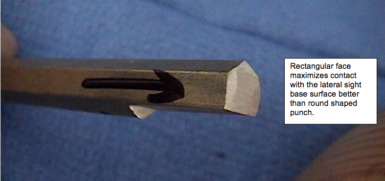

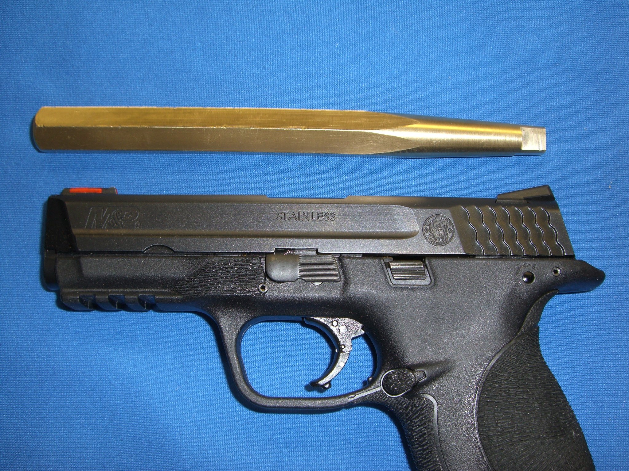

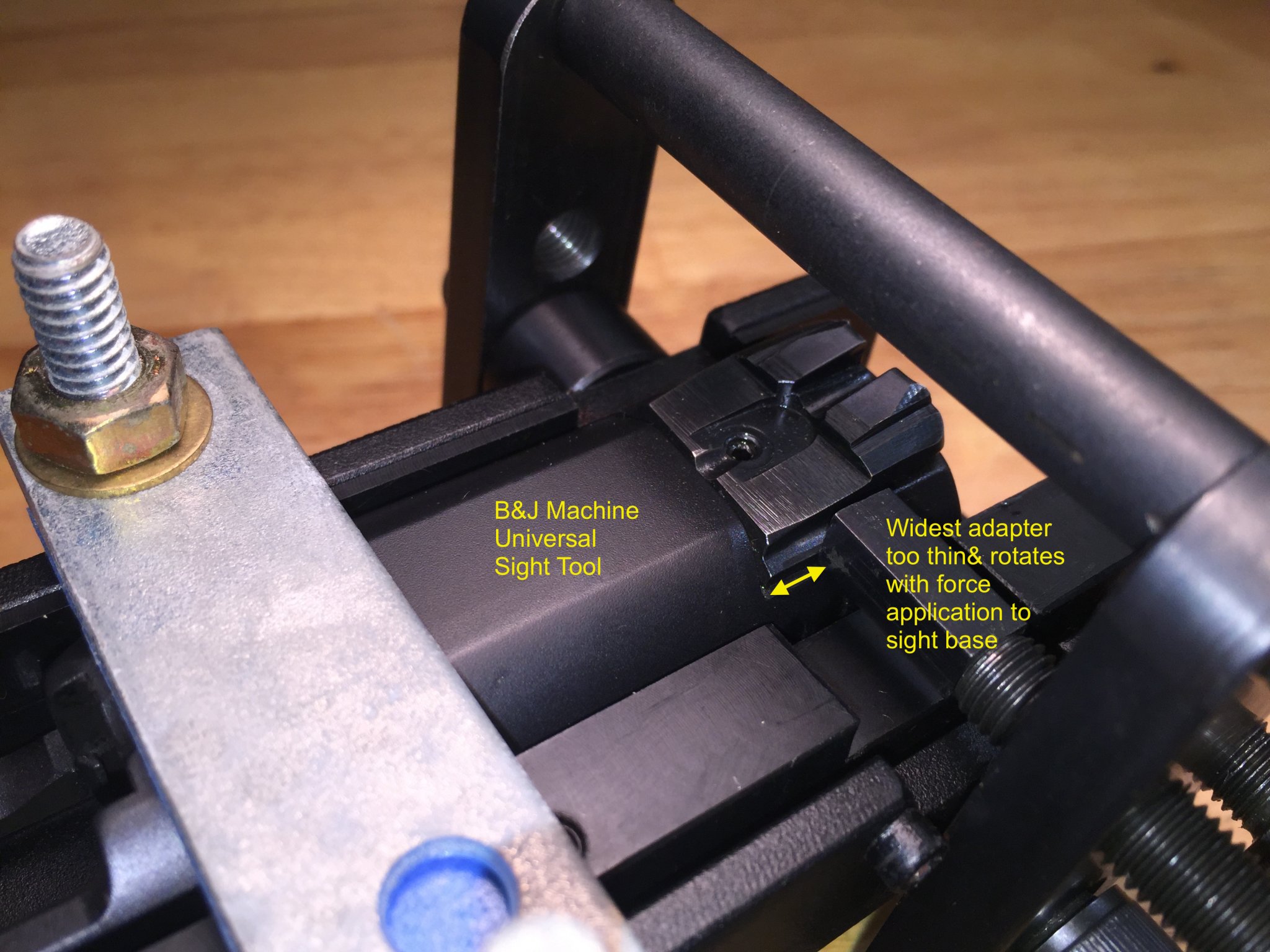

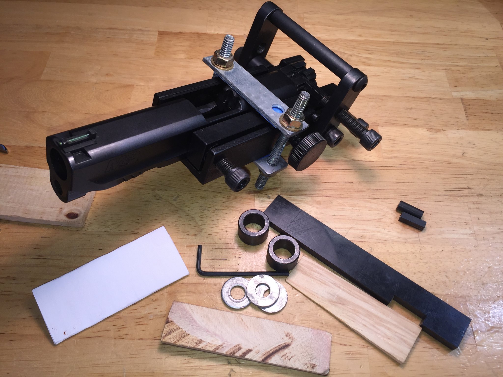

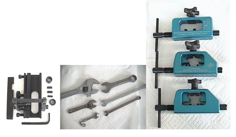

    It's not like I haven't tried those universal style pushers. This one is a B&J piece of junk....to many unsupported moving parts.
    The difference between a firearm specific sight tool and a universal tool is similar to using a crescent wrench when a proper size
    wrench gives the better fit and avoids rounding off bolt face edges.
    I fashioned a plate to support the top of the slide, which worked but then the pusher hardened tips were not properly shaped and they would slip off the sight base and destroy my finishes.

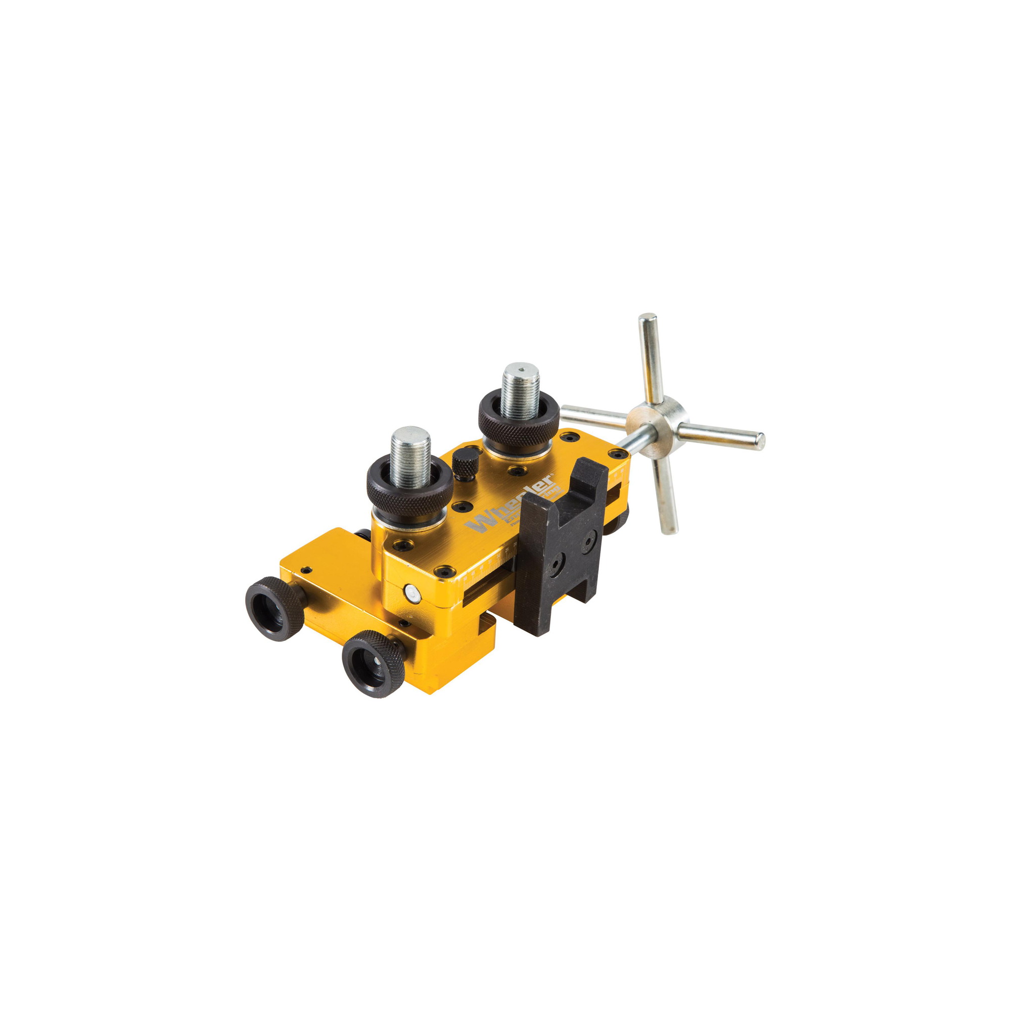

    Saw this recently. Pretty universal and good price
    man i just throw the slide in a vise and then use a 1/4" or so hardwood dowel and a hammer, easy peasy done it with at least a dozen handguns.
    I have the wheeler sight pusher. Similar design to the mgw but it doesn't have slide specific shoes and I'm sure the tolerances aren't as good.
    It has worked fine for me on a handful of m&p and Glock slides
    i have the wheeler and it works fine. avid makes one that pushes on the foot or blade, so it might work better.

    Gunsmiths use brass tools so they don't damage things. A little blue tape in the area prevents brass "transfer" Mark's, but if not it is usually easy to clean them off. Everyone has there favorite method, some use a pink artist's eraser, I like CLP and bore patch. Some use bore solvents like no9 or WD-40. If you get stubborn bits in pores you can use brass black to hide it or cold blue.
    It should have at least been cleaned up though. I see how the writing can get rubbed off or maybe he used a solvent that took it off.

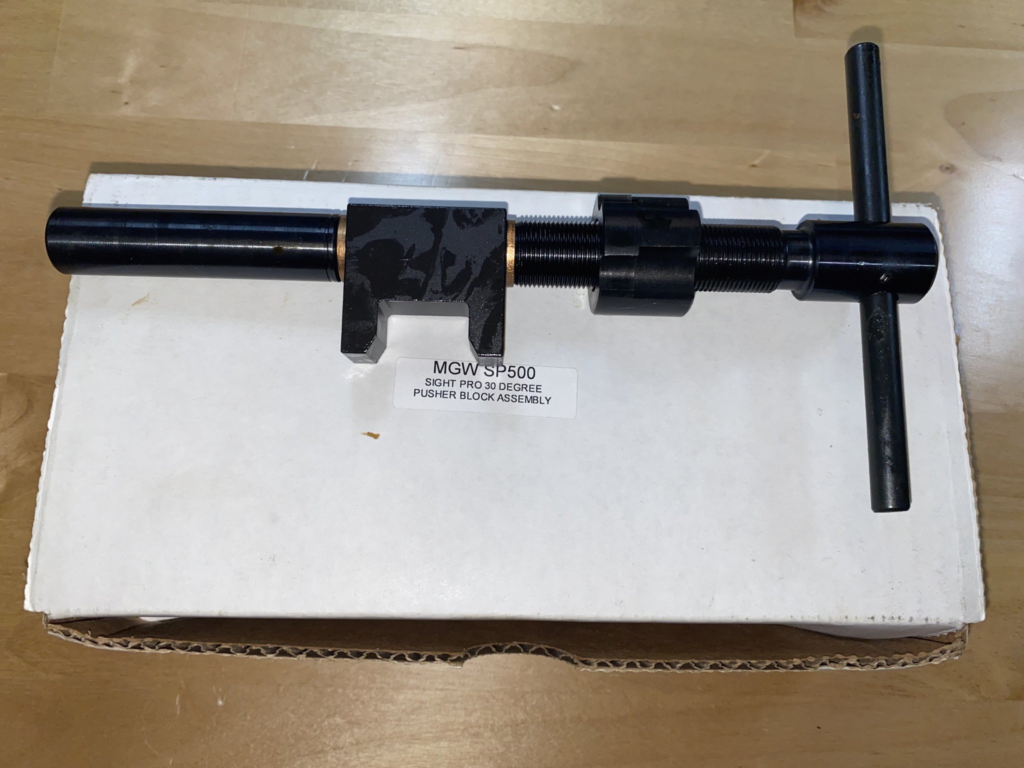

    The MGW universal tool isn’t cheap but it’s an investment. You won’t fuck up slides or sights unless you actually try to. If/when you buy a different pistol down the road all you buy is another adaptor plate for a little over $10 and you’re good to go. If you order direct they’ll usually do 10% off too and save you a few bucks which is only $20-$30 more than used ones typically sell for since they don’t lose much value.
    If I didnt already have a bin full of MGW model specific tools, I'd go this route.

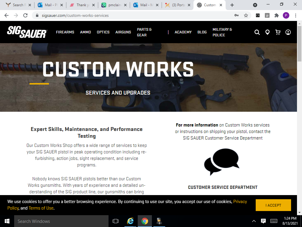

    Not really wanting to spend $300 or so on a pusher that will get limited use I checked Sig Sauer site as I think they charge $40 or so to drift in sights.....but than I saw this...
