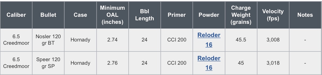

Have you tried RL16 with the lighter bullets?
Or has anyone tried RL26 with lighter bullets?
Have not tried RL-16 for the 120s, but the Alliant web site lists some of them:
