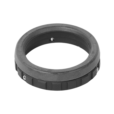

Guys, we had to order a bunch to make it happen, but we brought back the lo-pro eyeguard - Germany says about 8 weeks - got the price down a bit also, was $99, now $79 - anyone running a hensoldt spotter will want one of these:
7091003
SPOTTER 45/60 LOW PROFILE EYEGUARD

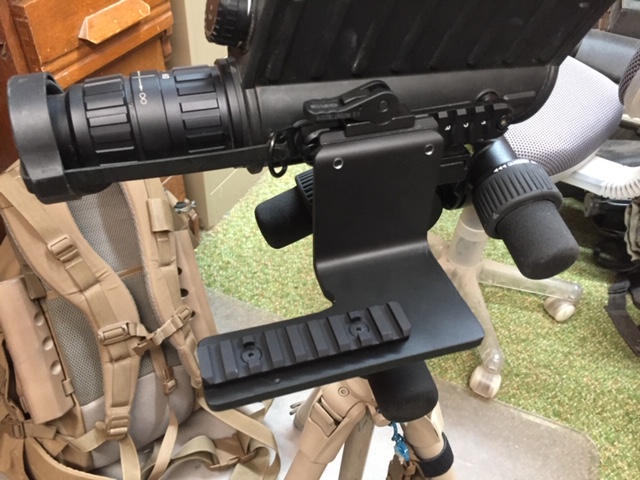

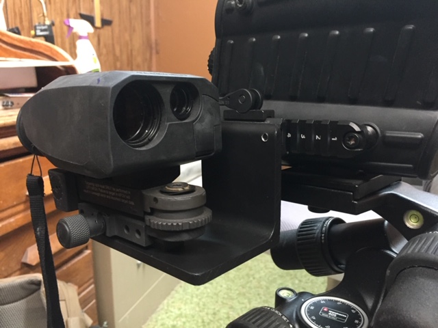

Couldn't find anything that worked the way I wanted so I made one in my shop. Made a couple for my friends with Henny's as well.
Ah, I see. I thought you were saying they were made by APO (not specifically the QD mount). Still, ingenious design and concept. If you don't have any issues, I may copy that and make one for myself. Looks like square AL tubing(?) cut/milled to shape and D&T'ed for APO pic rail and QD mount, correct?
No issues at all. Used 3x3x1/4 aluminum angle and QD mount and rail. Pretty simple and took me less than an hour to make. Cut the angle on my bandsaw and had it cerakoted when done. Keeps the ocular end of the Henny and LRF on the same plane so you just go between the two easily. Have a RDS on the left hand rail. Works with my STR spotting scope as well.
