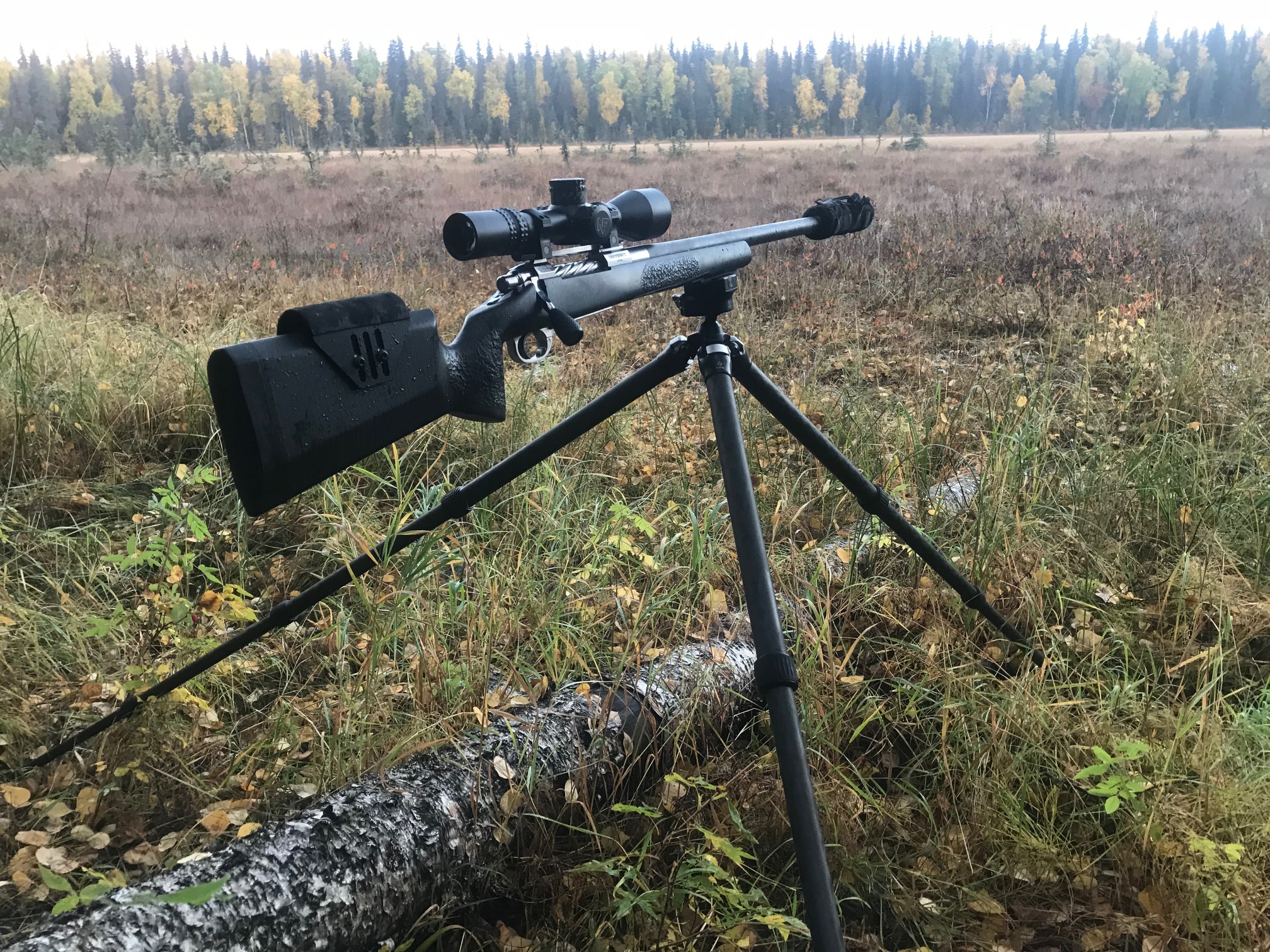

Hi,
300NM with new alloy Bartlein LH GT....
Arrives back from coating/metal treatment tomorrow :)
Sincerely,
Theis

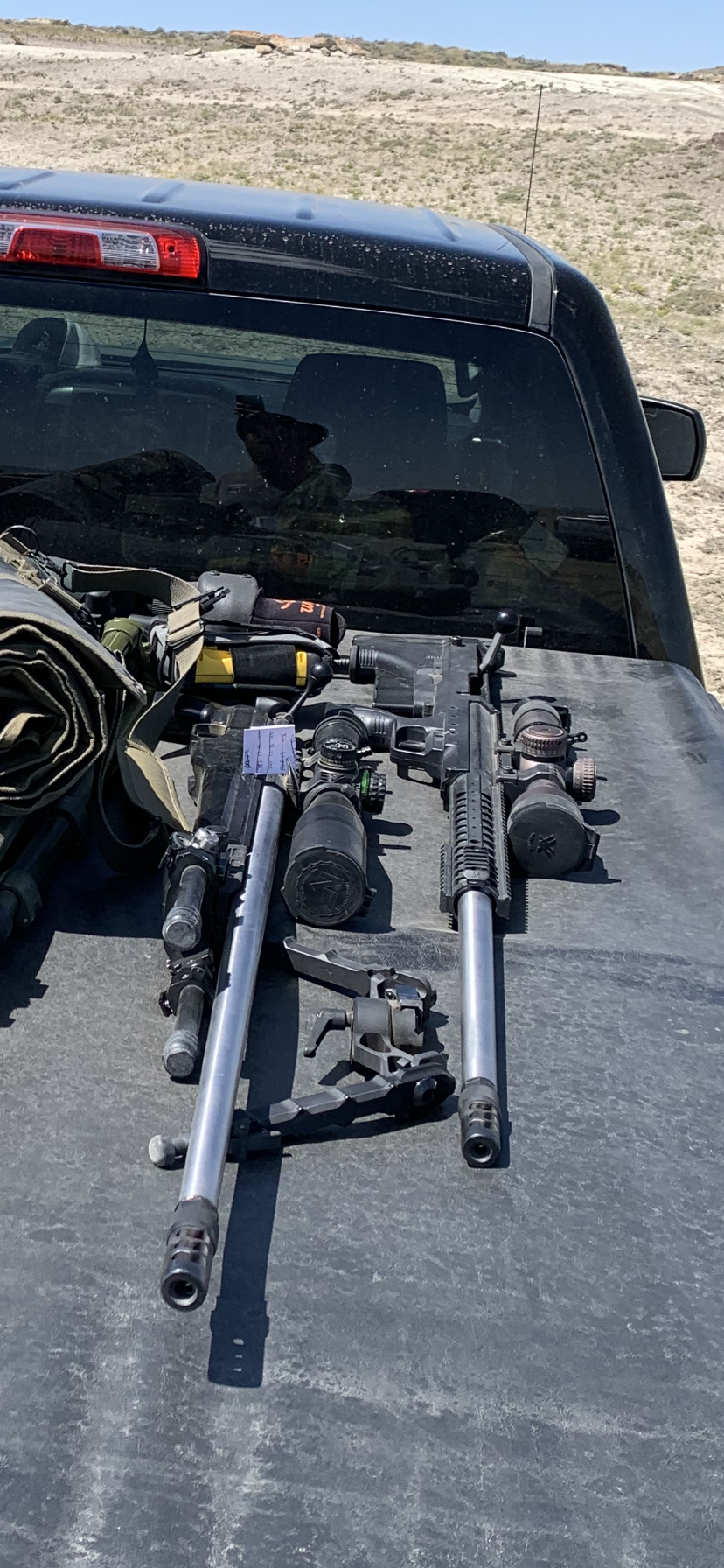

I was there... while the TRG performed fine the DTA did not, with cases getting stuck in the chamber and bullets blowing up 60’ from the muzzle.
Simply a function of barrel twist. Too fast for lead. The original idea was to shoot solids, then the a-tip came along so we choose to run them. The dta was loaded about 50fps faster than the trg in moderate temperatures, when hot it hit the threshold of jacket separation. The choice to run lead vs solids was based on the impact splash between the two, advantage going to lead. I think I “lost” three bullets with the trg that weekend... no splash no impact no call etc. Both rifles have slower twist barrels and are ready for more dust and wind.

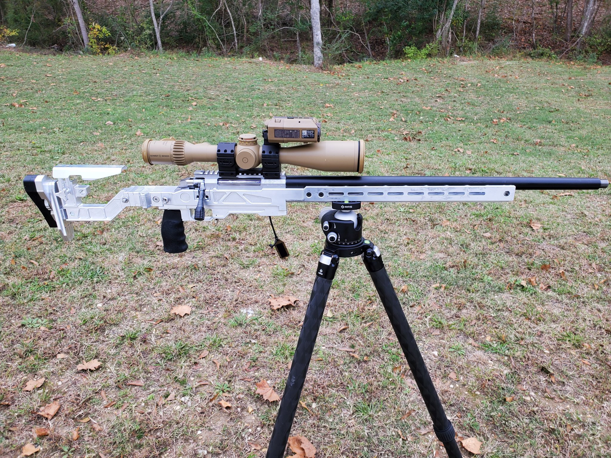

Personally; I’ve had the following built by Joseph Furrer of Alyeska Precision, Chugiak Alaska:
BAT Machine Model HR Action
Kreiger 30” Barrel 1-9” twist
Zero Compromise ZCO 5-27x56 MPCT1
SPUHR SP-61602 55MOA Mount
Thunder Beast 338 Ultra Suppressor
J Allen JAE700 Long Action Chassis
Bix-n-Andy TacSport Pro 2/Flat trigger
Thunder Beast Bipod
I shoot 230gr Hornady A-Tips @3075fps (86.0grs Vihtavouri N570)
In our rather crowded and competitive shooting community, this rifle has become something of a standard in accuracy and craftsmanship.
What twist were you running on the DTA that was blowing up bullets? I have an 8.4 twist to shoot 250 A Tips that I'm just waiting on a scope to show up.
You will be fine with the 8.4. Both of the original barrels on the trg and the dta were 7.5. To run 190-210gr solids. The only difference between the two was mine had a year of wear on the barrel before switching to lead. The dta was new last winter. The dta was running rl26 and the trg was running h1000. After seeing the advantage of lead splatter from the conventional bullet it was a clear advantage for spotting the small bullets. Knowing 7.5 was too fast but after testing in my 7.5 and working well we decided to run the dta the same cause there was a barrel laying in the rack. Is what she is. That barrel runs solids just fine, dta has a new barrel for lead on it now. The joy of doing your own work means it only costs you a barrel to experiment with something.
Thanks for the info!
