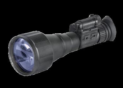

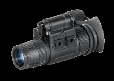

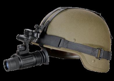

Here are the specs and a few pics
Armasight N-14 Gen 2+ SD $1600
SPECIFICATION
IIT Generation Gen 2+ SD
Resolution 45-51 lp/mm
Magnification 1x standard; 3x, 5x, 8x optional
Lens System F1.2; 27 mm
FOV 40°
Range of Focus 0.25 m to infinity
Diopter Adjustment -6 to +2 dpt
Controls Direct
Automatic Brightness Control Yes
Bright Light Cut-off Yes
Automatic Shut-off System Yes
Infrared Illuminator Yes (With built-in flood lens)
IR Indicator Yes (in FOV)
Low Battery Indicator Yes (in FOV)
Power Supply CR123 Lithium 3V (1) or AA Alkaline 1.5V (1) or any AA or CR123 type rechargeable batteries with voltage from 1.2V to 3.2V (1)
Battery Life up to 60 Hrs
Environmental Rating Waterproof
Operating Temperature -40 to +50°C
Storage Temperature -50 to +70°C
Dimensions 140 x 49 x 69 mm / 5.5 x 1.9 x 2.7 in
Weight 0.34 kg /0.75 lbs
Warranty 2 Years

That said, the N-14 is a good great unit, and finding a 14 in gen 2 can be difficult. If you go with gen 2, I would recommend getting the best gen 2 you can, such as the Gen 2 HD. Gen 2 ID will be noticeably better than SD, and so on. How do you plan to use the monocular most. Weapons mounted? Head mounted? Helmet mounted? If helmet mounted, do you already have a certain helmet and/or mounts? This will help you narrow down what might be best for you.
Good info
I will be using it mostly head mounted but I would like to have the option of mounting it on a few different calibers 556, 300 blk and possible 308. I currently do not have any head or helmets for mounting, I just figured I would buy it after I select a unit.
