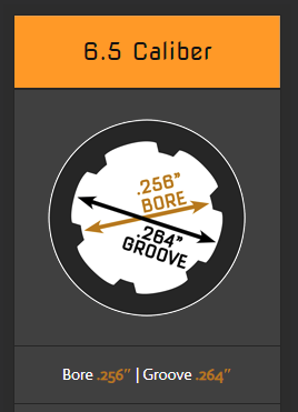

Doesnt really matter as its a relative measurement so anything within reason would work but I would stick with a spot between the groove (.264) and the full profile of the bore rifling (.256) for where the bullet would first be encountering the barrel material.
7068012
I'd like to understand this a little better myself...
Going by spife's diagram, Groove - Bore = 0.264 - 0.256 = 0.008", so
0.260" would be cutting 0.260 - 0.256 = 0.004" (half way), and
0.257" would be cutting 0.257 - 0.256 = 0.001" (1/8 way).
Are there pros & cons to use one vs. the other?
Or, just take into account that one is ogive kissing the lands, and the other is, half-jammed?

That’s a good point. Plus they have that chamfer in theirs so take the angle into account. So if you’re going to chamfer the edge maybe slightly smaller so it has a buffer to open up. Cut the hole to the bore diameter and then cut the chamfer angle the same as your chambers lead angle for the closest fit.

If you measure too far outside then it can be hard to get a good purchase in the bullet. Slightly smaller gives you a more defined point. But honestly who could tell at that scale? Not me.
