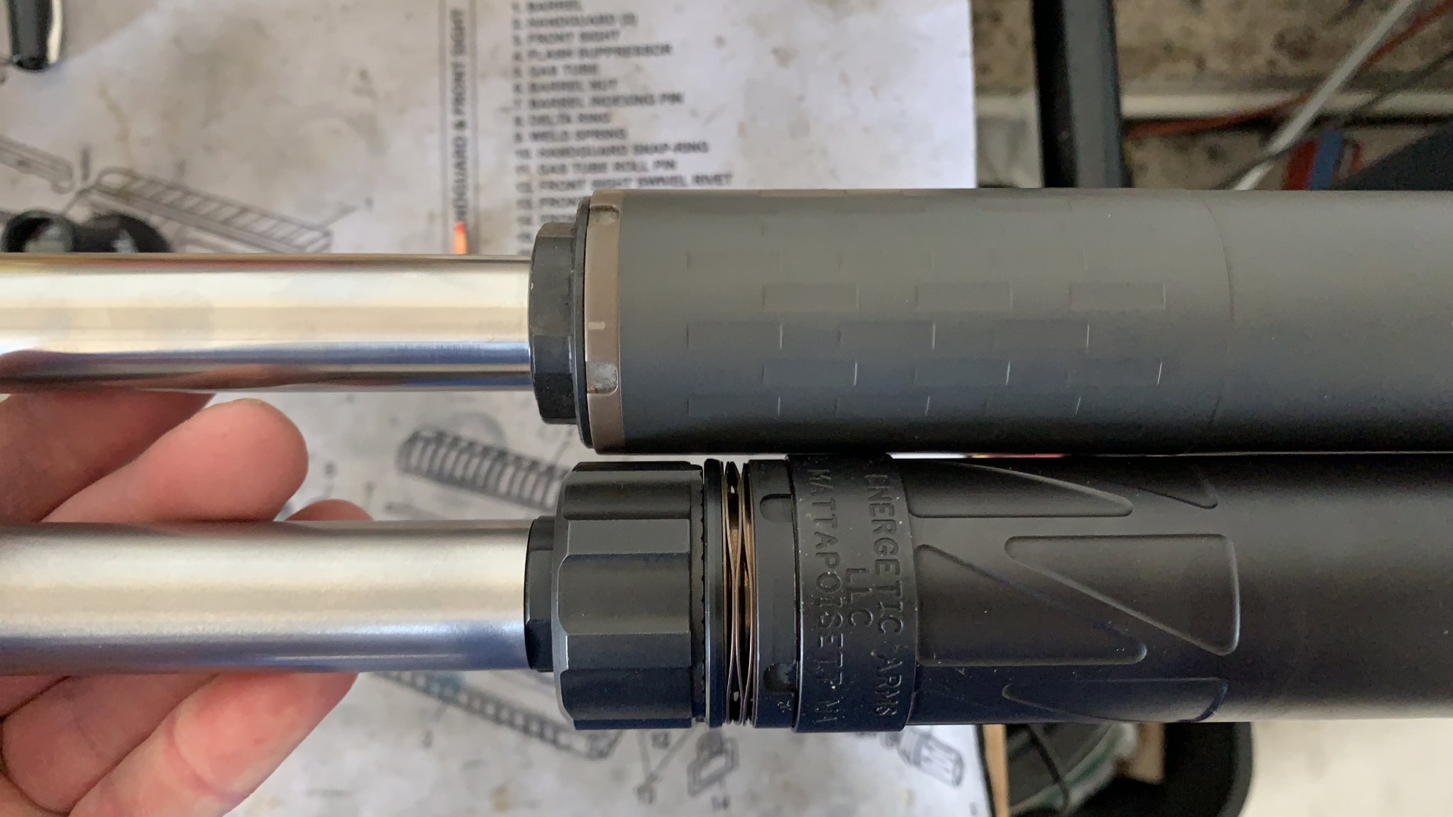

Smaller, lighter, cheaper to the KeyMo. Muzzle devices cost the same and not as nice as the KeyMo options.
Personally I just direct thread and use thread protectors on my bolt actions. Have a Nomad Ti and Sandman Ti. I have a Sandman S with KeyMo muzzle devices for my ARs.
Reactions: HansohnBrothers
I hate how much I love the area 419 mount. Usually I hate adaptors and prefer simplicity, but the area 419 is the exception where stacking an adaptor makes your systems way simpler, to include if you ever want to use a brake.
Reactions: Odindad
Keymo is a great system just not the lightest
Its long too. Adds 1.2” to he exact. Cool design, there’s just no way id use it across a whole bunch of platforms.
