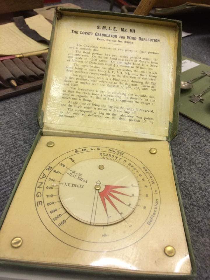

I've come across this wind drift device, but was completely unable to find any information related to it, of any kind, like no one ever mentioned it on the internet, which I found quite odd to say the least. Any info will be appreciated!
Hi,
How in the hell did you find the only thing that google does not know anything about lol?
Did you purchase it?
Sincerely,
Theis
It's not mine o_Oa friend sent me the pic asking for info about it. Google? Nothing al all! like this gadget never existed on Earth! :unsure::unsure: despite being a 100% legit item.
Ok... well, you stumped my friend Martin Pegler, author, military historian and former head curator at the Royal Armoury at Leeds! He has some e-mails out at this point as well!
We both agree that it appears to be WW1. And also note that it would not (necessarily) relate to Lord Lovat's Commandos... the butcher and bolt bunch... as Lovatt is spelled with two T's. Also, WW1 saw a lot more of this 'buy it at the Army Navy Store' pukka kit that likely did not help much when you marched into machine guns carrying little more than a bayonet or swagger stick.
More to follow.... but so far, you have stumped Google AND one of the world's top firearms historians...
BTW, if you hang out here and don't own Martin Pegler's book on the history of U.S. Military Sniping... shame on you!

Have no idea about its whereabouts or origin unfortunately. Only thing I got is the picture posted, I hope your friend can shed some light on this rare, uncommon and ungoogleable artifact o_O
A slide rule of sorts to account for spin drift?
Figure true wind based on the appearance of the range flag in the center dial than add your range presto spindrift calculated for.
Brits complicating what the Americans factored into the construction of the '03 sight slide.........
Reactions: LastShot300
Interesting piece of kit. There is a Provisional Patent number on the lid... that would be the starting point for looking for info if someone was so inclined. Someplace in an archive that most probably resembles the warehouse from the closing scene of Raiders of the Lost Ark is the document containing the answer.
I found the artifact well ahead of its time, no less than 5 decades!:LOL: very well designed and super useful, assumed it worked as intended. Nothing so far from the real experts? What a puzzling mystery!
Mk 7 ball had a G1 BC roughly in the .400-.450 range from research/educated guesses I've done in the past. ~2450fps muzzle velocity if memory serves. Can test it against JBM.
Hi,
I have checked UK and International patents...nothing.
Am I the only one that wants this device?
Sincerely,
Theis
True. It's like some phantom device that isn't supposed to exist in this realm. It's sort of easy for us to see what it does, but quite amazing that there is no searchable info on it.
It is probably a century old or so... there are probably only paper documents for that patent submission... digitizing all those old files would be laborious.
interestingly enough, a gentleman from West Virginia filed for a US Patent for an "analog calculator for determining the deflection of a rifle bullet due to the effects of wind speed and wind direction..."
Application US20170046542 filed on August 11, 2015.
Spoke to a friend of mine, an expert in Full Bore and arcane knowledge. His advice was pointed and blunt. But it is worth repeating in full given some of the weird and wonderful exchanges on SH.
"It looks like some sort of psychological crutch for tech nerds who can’t read wind..."
