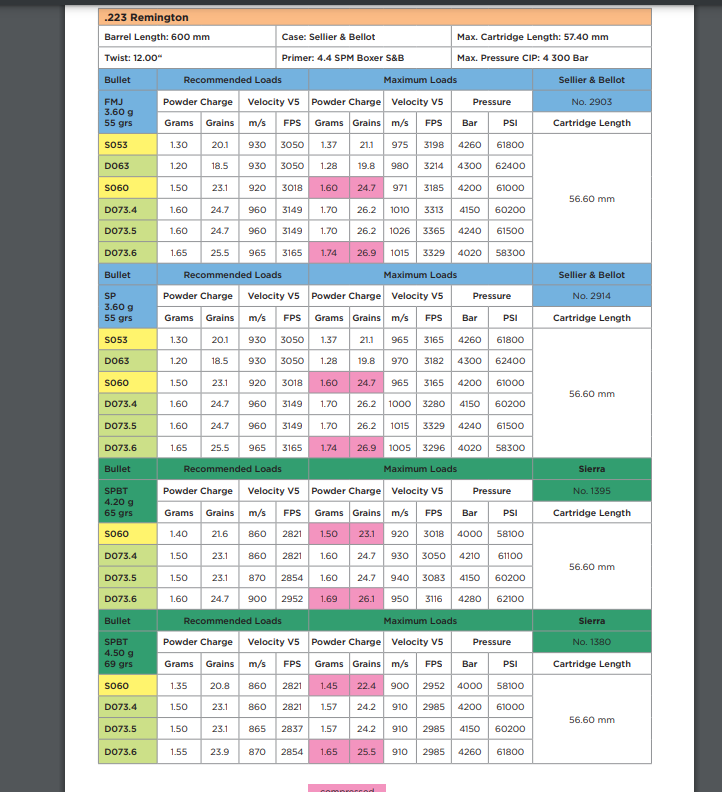

I scored 8 pounds of loveX 73.4 . Does anybody have any experience with this powder? I bought it as a replacement for CFE 223. Be shooting 175 grain smk in 308 And 62 grains and 556. Kind of wondering how it’s going to feed through the Dillon powder measure. If it’s going to be temperature sensitive whether or not it’s going to like light or heavy loads just a little bit about the characteristics of it. I did a search and the reloading form and didn’t find anything on it. Anybody got any opinions?
A google search shows that it is equivalent to Accurate 2230.
I shot a lot of 2230 behind cheap 55FMJ bullets and it performed as well as any ball powder I have used. Flowed well through the Dillon powder measure. It is a ball powder so it will be temperature sensitive.

CFE is ball powder and I found it to be the least temp sensitive with the smallest extreme or standard deviation in all situations out of most similar burn rate powders I tried before I settled on it . I can’t find the CFE223 around me . Or I would definitely be using it. It was .25moa 2650fps 46.2gr 175gr SMK m118 lr brass GMM primers .1 off the lands in the 700 and .5 moa .3 off the lands in the FAL
