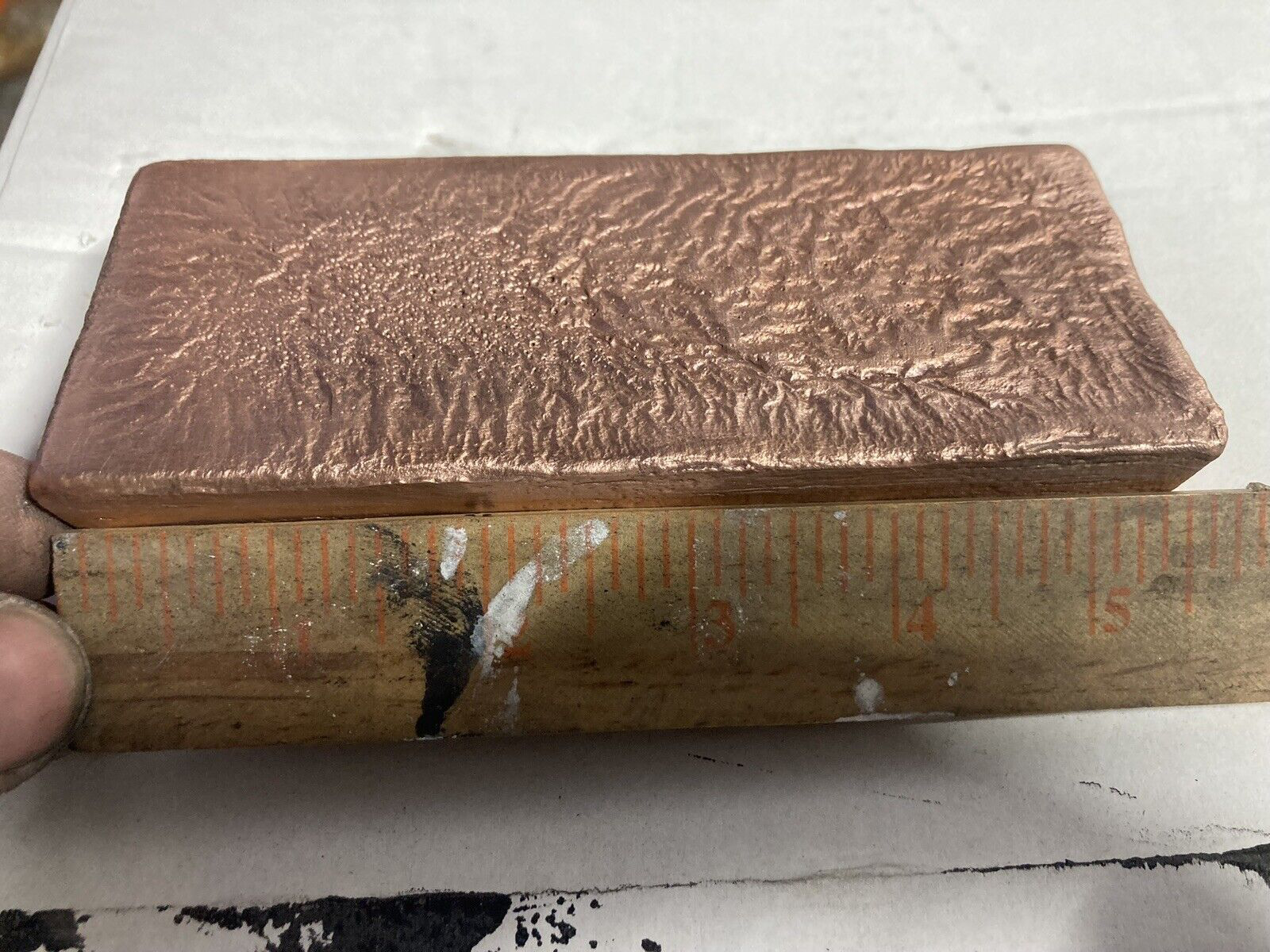

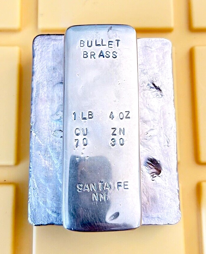

I just bought a 4 pound copper ingot on eBay for $33. Brass can be had for slightly more money. Brass is just an alloy of Copper and Zinc. Copper is very slightly heavier. But if you really prefer brass, it's out there. I saw a 5 pound block of brass for about $50.
My plan is to screw an ARCA clamp I already have, to the top of it and a short section of either pic rail or arca rail I also already have to the bottom of it. I'll clamp it to the front of my Arca rail and clamp my bipod to the bottom. I will play around with the weight on the rifle to position the clamps and the ingot for best balance.
I think I'll end up with a cool looking, inexpensive weight that will help me balance the rifle for very very little money.
One non-functional question is whether I block sand it to make it smooth and square, of if I use it "as cast". Either way, I'll probably shoot it with some clear lacquer to keep it shiny.

Copper Ingot that I bought
Brass Ingot Alternative

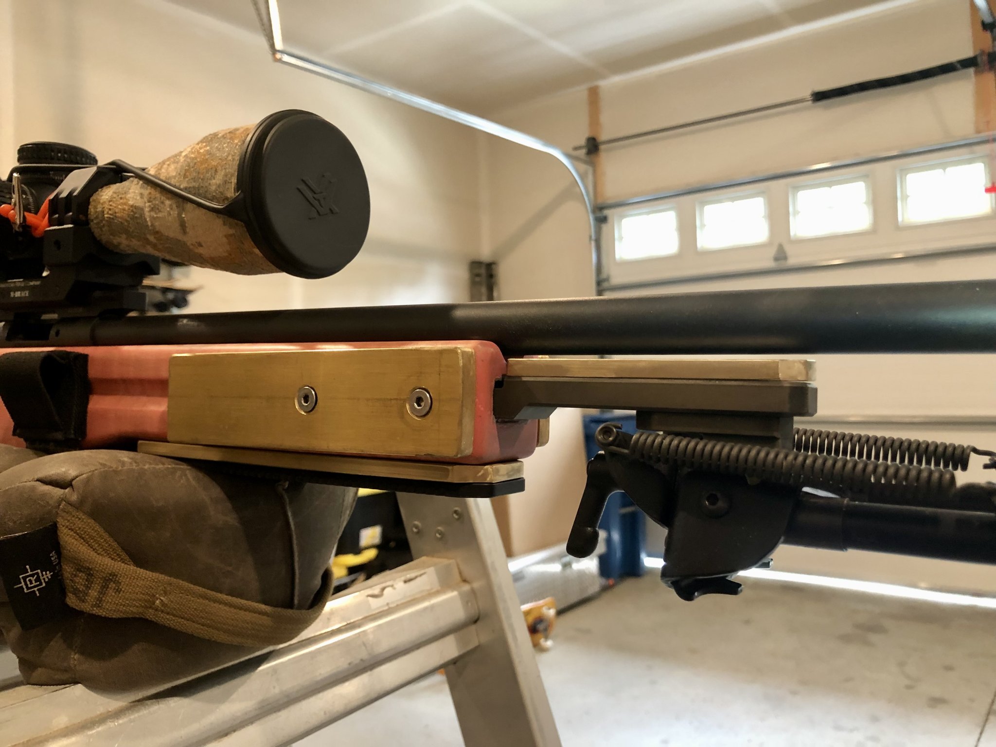

I feel like your going to have too much stack up, alot of stress on the attachment points. Not cheaper but a heavier barrel would solve alot.
If you have a composite material stock you could carve some material out in the barrel channel and epoxy some pieces of that in there and avoid the stack up issues. Still cheap and redneck and hidden.
For the cost of Arca clamps, you could put two of them on it if you find there is too much flex.
You can also buy these in 1 lb pieces for similar money per pound. Your idea about epoxying inside makes sense.
You could also drill holes in them and attach them to MLOC slots using standard hardware store screws and MLOC nuts.
I don't really care about it looking slick and integrated. But you raise great points about ideas to make it more slick and integrated.
In my head the beauty of my plan is I can slide it off the Arca on my butt heavy Bergara and slide it onto my CZ in about 30 seconds.

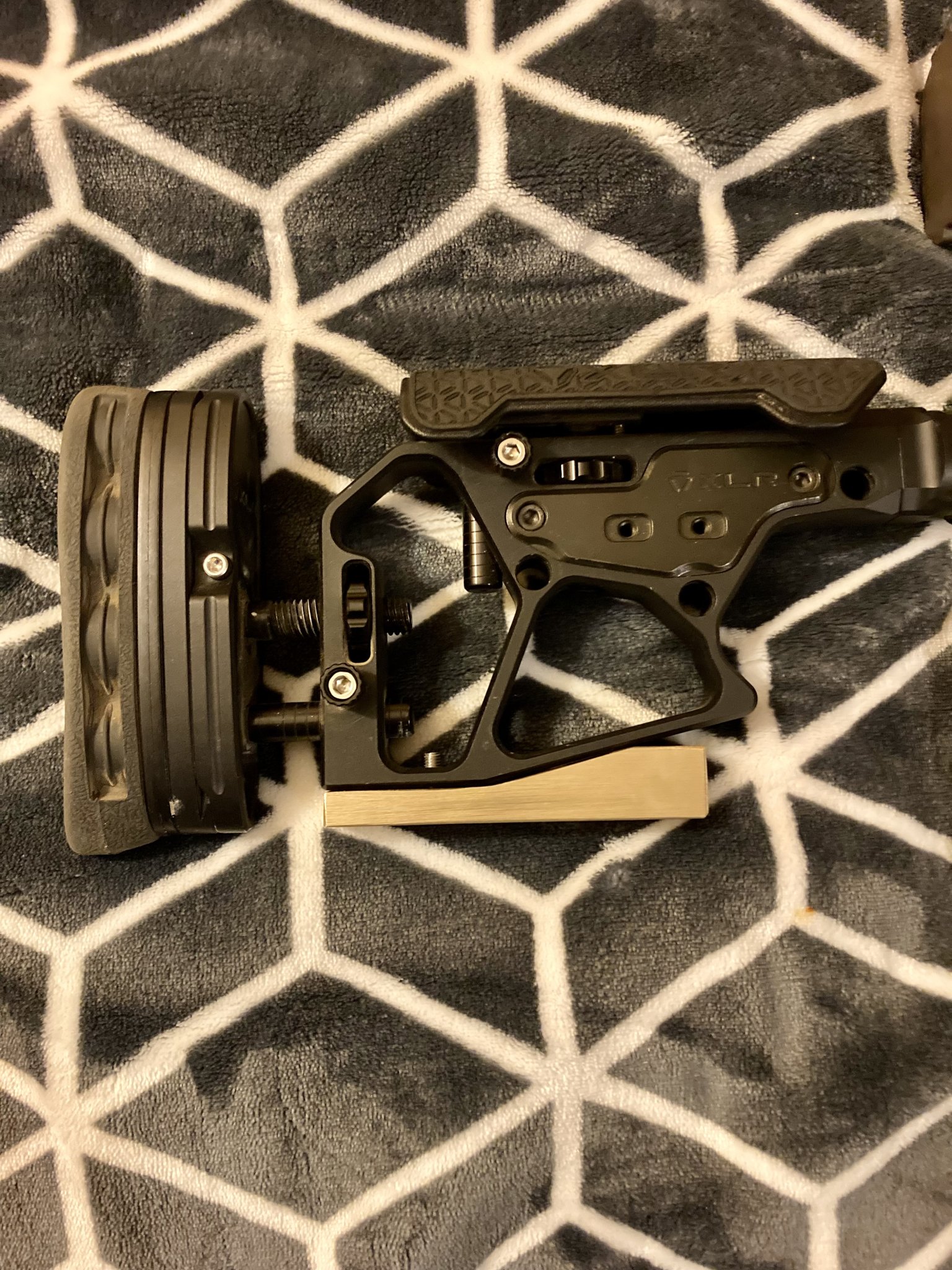

These would probably work and look great mounted to the sides of a chassis using MLOC slots
I guess if I ever get an aftermarket barrel for my Bergara or CZ I may need a butt weight. But currently that's not even something I could imagine.
Rippley - that looks great on you fore end.

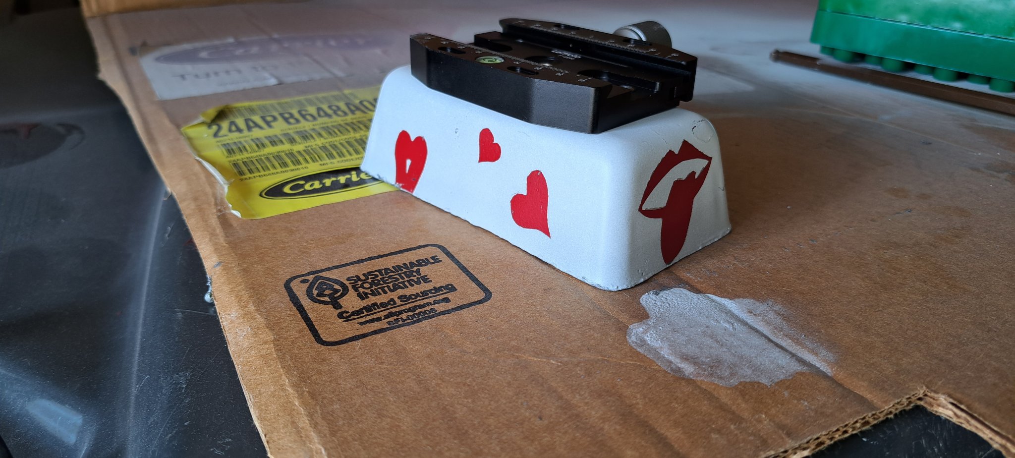

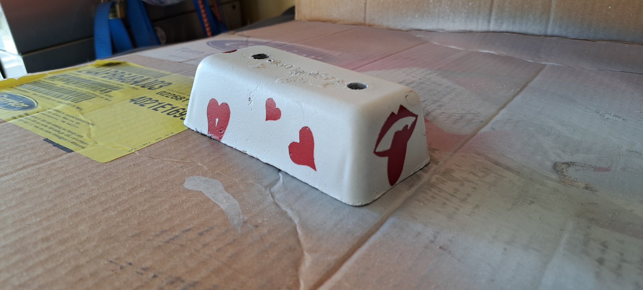

Made this 8.5# out of pure lead for a buddy using a mini muffin tin.
He had the audacity to paint it black. 😆
A week later, I made one at 10.2# for the wife. Hers is a nice camo pattern. Can't find the pic of it though.
