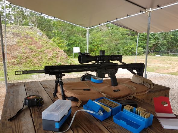

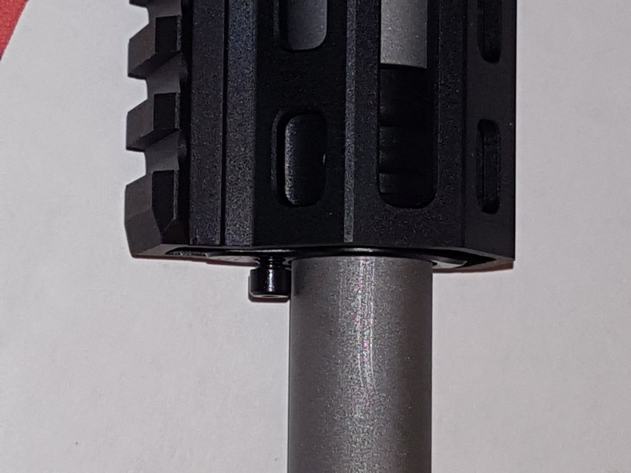

...my personal preference is SLR, been using them since the first versions came out. Use them on 300BLK(10.1" / 16"), .223/556 (16"), 6ARC (18") & .308/762 (16").
Depending on the barrel length and gas system type, you can match the handguard length to the gas system so the adjustment screw at front is readily accessible, just takes some planning & measuring beforehand.
