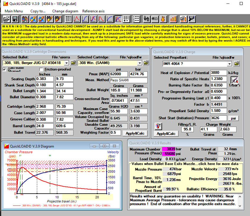

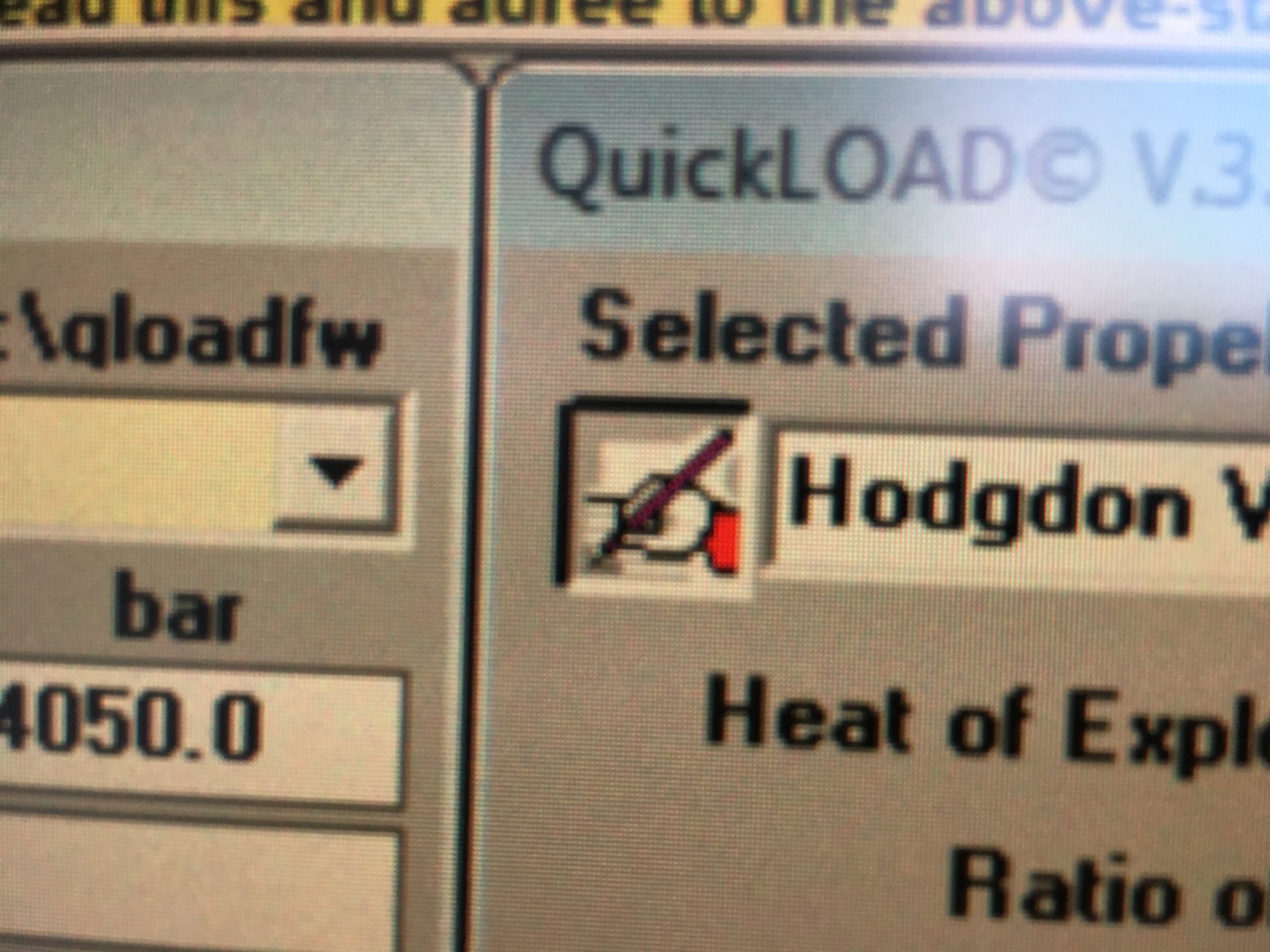

Click on the little icon in the upper left corner of the powder data window, then click into the Burning Rate Factor box and change it incrementally until your velocity lines up with your chrono. IMR 4831 is .4421. Change it to .4521, .4621, etc 152CDB93-780F-4BA2-9C66-C55AF7C555FC.jpeg
