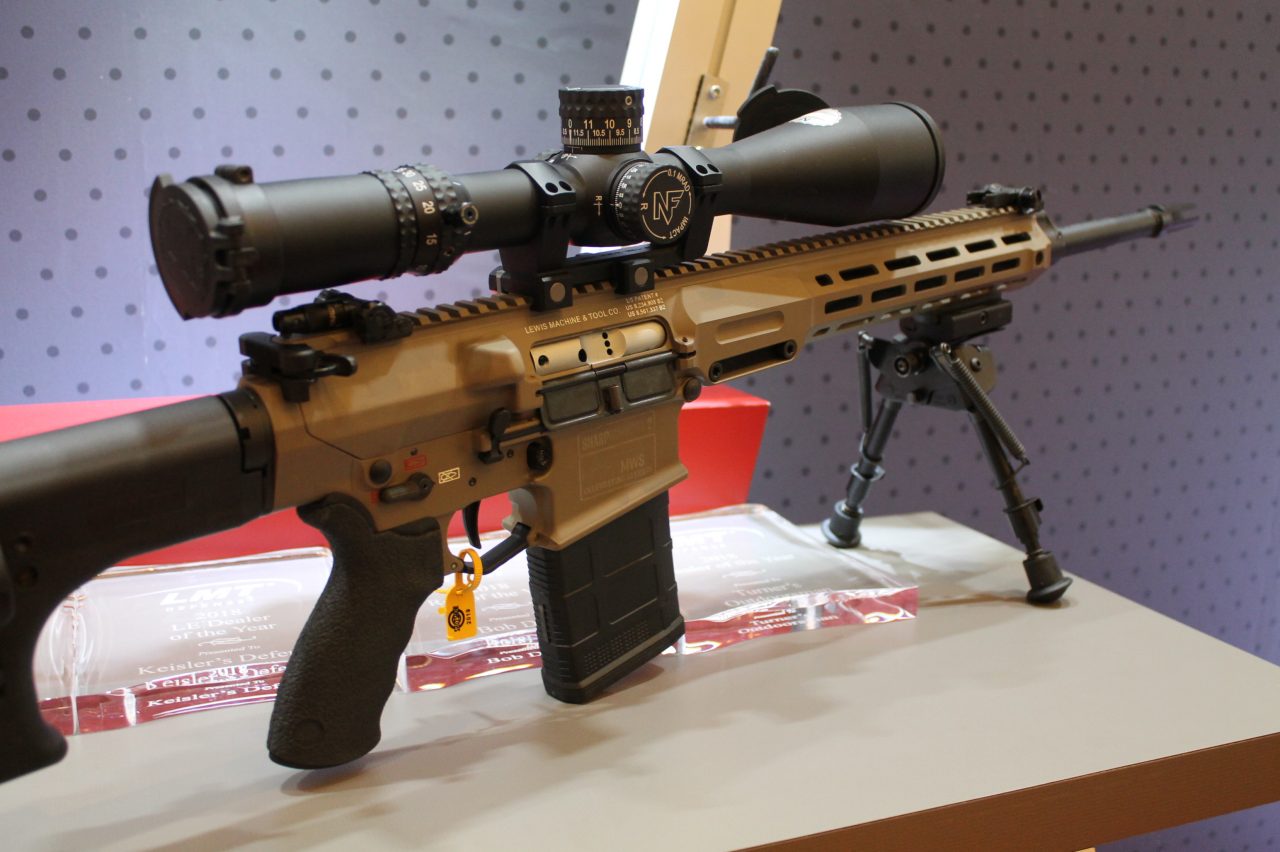

I have a budget set aside to take two LMT Mars H DMR lowers, and, one by one, over the next 2 years, combine them with two uppers:
Mars MLK upper from LMT with a 20" 6.5 Creedmoor barrel, and

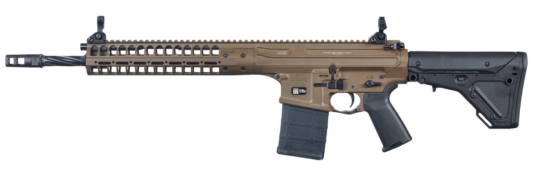

an LWRCi 16-inch Repr MKII upper.
I really want these two DMR battle rifles, but I don't have the budget to buy them both outright, or at the same time, which is why buying the correct lowers is important for me. My budget is up to $1500, give or take, for the two lowers. LMT sells stripped lowers for $400 each, which is why I was thinking of choosing them. I don't find any KAC or LWRCi Lowers on their websites, and I once heard that LMT manufacture's the lowers used by KAC. A KAC would be nice but I think I can get two guns for just a little more than the cost of buying just one KAC.
LWRCI uppers only fit their lowers. In your place I would get two all LMT rifles. How important is the full AMBI lower?

I've heard LWRCi rifles not being as accurate as LMT on these forums. I only wanted to own one because I thought their gas system looked interesting, and it would be my designated 308, while the LMT would be my 6.5 Cr DMR. My other option was the 716 from Sig, but I don't know how easy it is to switch between 308 and 6.5cr on that platform. I want DMR's with extensive testing and preferably military battle-proven, so LWRCi, LMT, KAC were at the top of my list. Not interested in FN or HK products though.
